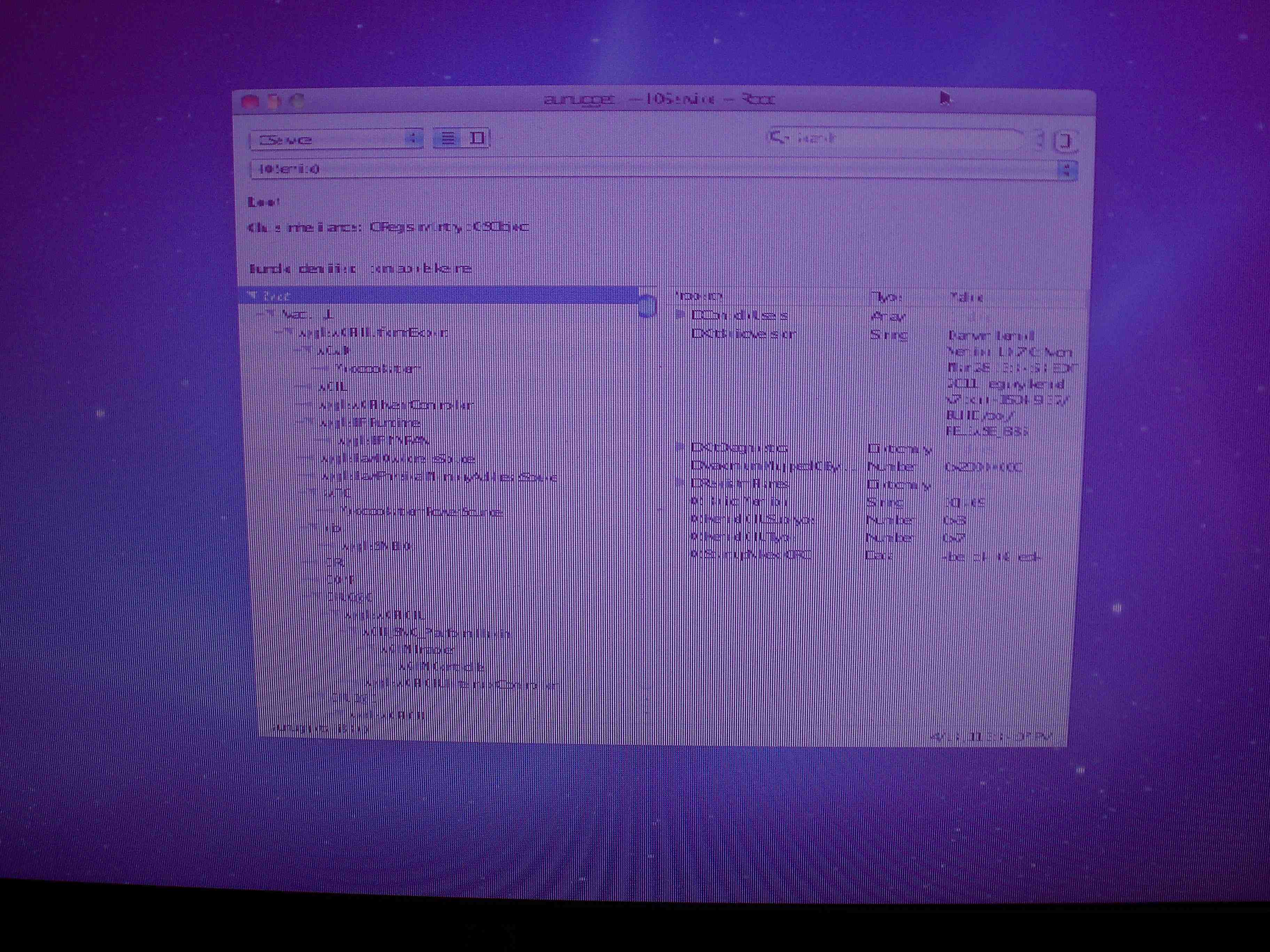

kizwan Posted January 4, 2012 Author Share Posted January 4, 2012 (edited) Dell Studio 1557 with eGPU ATI Radeon HD 5870 @PCIe x2 * eGPU = external Graphic Processing Unit. However, this setup doesn't work properly yet. The external monitor connected to eGPU doesn't produced any video, even though the monitor is properly detected. I'm sure this is framebuffer issue. Limitation/Procedure:- Boot flag: GraphicsEnabler=Yes, UseAtiROM=Yes ROM files for both GPUs in Extra folder. Need to removed ATIRadeonX2000.kext. Somehow it conflicted with ATIRadeonX3000.kext use by HD5870. If doesn't removed it, notebook freezed (gray screen on internal LCD) while trying to load desktop. No output on external monitor connected to eGPU yet. Edited January 4, 2012 by kizwan Link to comment https://www.insanelymac.com/forum/topic/218706-dell-studio-1557-discussion-thread/page/4/#findComment-1783322 Share on other sites More sharing options...
kizwan Posted January 5, 2012 Author Share Posted January 5, 2012 It turn out I didn't use Kabyl's boot file. I accidentally use trunk boot file. I now use Kabyl's boot file with 0x6898 (5870) set to Uakari. Now I get output on both internal & external monitor. However, I need to removed ATIRadeonX3000.kext. If not, I got distorted output (blocks of weird colors) on external monitor. So, I have QE/CI on internal but no QE/CI on external monitor. Both support native resolutions (1366x768 & 1920x1080 respectively). I think if I want to fixed the distorted output on 5870 screen, I need to patch the Uakari personality. Link to comment https://www.insanelymac.com/forum/topic/218706-dell-studio-1557-discussion-thread/page/4/#findComment-1783559 Share on other sites More sharing options...
kizwan Posted January 7, 2012 Author Share Posted January 7, 2012 I just tested 10.6.8. Disappointed though. The "[ PCI configuration begin ]" preventing ATI HD4570 from working. 10.6.8 actually continue to load after we saw "[ PCI configuration begin ]" message in verbose mode. Remote connection using VNC confirmed OSX does load. The problem is "[ PCI configuration begin ]" preventing the ATI4600Controller.kext from working properly. ATI4600Controller.kext does loaded for a while but automatically unloaded moment later. Basically ATI4600Controller.kext see ATI HD4570 but unable to initialized it properly. Good news! With Lion we won't have this problem. Actually, in verbose mode (-v), it seems stuck at "[ PCI configuration begin ]" too but like 10.6.8, OSX still loading in the background. Unlike 10.6.8, ATI HD4570 will work. I has tested Lion final retail. I managed to inject ATI4600Controller.kext for our HD4570 in the installer. Link to comment https://www.insanelymac.com/forum/topic/218706-dell-studio-1557-discussion-thread/page/4/#findComment-1784142 Share on other sites More sharing options...
kizwan Posted January 10, 2012 Author Share Posted January 10, 2012 Corrections. The reason why it stuck at [ PCI configuration begin ] is because the dsdt.aml we use. The dsdt.aml I use & shared here actually extracted directly from BIOS file. You see, DSDT from BIOS file have generic memory address. When DSDT is loaded into OS, these generic memory address will updated to correct value. Please observed this comparison between DSDT from BIOS file & DSDT from OS registry:- 19c19 < DefinitionBlock ("dsdt_backup.aml", "DSDT", 2, "Intel ", "CALPELLA", 0x00000001) --- > DefinitionBlock ("dsdt.aml", "DSDT", 2, "Intel ", "CALPELLA", 0x06040000) 117c117 < OperationRegion (GNVS, SystemMemory, 0xFFFF0000, 0xAA55) --- > OperationRegion (GNVS, SystemMemory, 0xA779AC9E, 0x0200) 6639c6639 < OperationRegion (SMI0, SystemIO, 0xFFFFFFFE, 0xFFFF0040) --- > OperationRegion (SMI0, SystemIO, 0xFE00, 0x02) 6645c6645 < OperationRegion (SMI1, SystemMemory, 0xFFFFFFFE, 0xFFFF0041) --- > OperationRegion (SMI1, SystemMemory, 0xA779AEB7, 0x1096) 8139,8140c8139,8140 < 0xFFFF, // Range Minimum < 0xFFFF, // Range Maximum --- > 0x0500, // Range Minimum > 0x0500, // Range Maximum 8142c8142 < 0x01, // Length --- > 0x10, // Length 11202c11171 < OperationRegion (SMI2, SystemMemory, 0xFFFFFFFF, 0xFFFF0041) --- > OperationRegion (SMI2, SystemMemory, 0xA779AEB7, 0x1096) 12097c12066 < OperationRegion (IO_T, SystemIO, 0x0800, 0x10) --- > OperationRegion (IO_T, SystemIO, 0x0500, 0x10) So, need to removed current dsdt.aml, boot into OS X & generate fresh dsdt.aml in it. Of course, we need to re-apply the fixes in new fresh dsdt.aml though. After doing this. you'll be able to boot with npci=0x2000 to fixed the [ PCI configuration begin ] issue in verbose mode. However, on 10.6.8 & onward (tested until Lion 10.7.2), internal LCD (LVDS) doesn't work properly anymore. We'll get output with weird colors. HDMI & VGA ports works properly though, no weird colors. QE/CI still working. @jofox78, DSDT in BIOS A08 & A09 are identical. @crowebster, high CPU temperature is normal on OS X. Even real Mac computer running hot. You need to re-apply thermal paste on CPU & GPU. I recommended Shin-Etsu G751 thermal paste since I already tested it myself. Staf away from Arctic MX-4, it doesn't work properly on our notebook. @merkaba, you need to use legacy/modified kernel if you want to install Snow Leopard using 10.6.0 DVD. You also need to boot with busratio=12 CPUS=1 boot flags. @xzeil, Sorry not reply to your post earlier since I'm not active on the scene for couple of months. Enjoying eGPU on windows. Look like you have successfully getting your ATI HD4570 working on Lion 10.7.2, including internal LCD (LVDS). Good news for Dell Studio 1555 owner. I have not been able to fixed internal LCD issue on Dell Studio 1557 though. @All, if anyone interested getting Lion working on Dell Studio 1557, please go to this thread: http://www.insanelymac.com/forum/index.php?showtopic=274463 Link to comment https://www.insanelymac.com/forum/topic/218706-dell-studio-1557-discussion-thread/page/4/#findComment-1784882 Share on other sites More sharing options...
