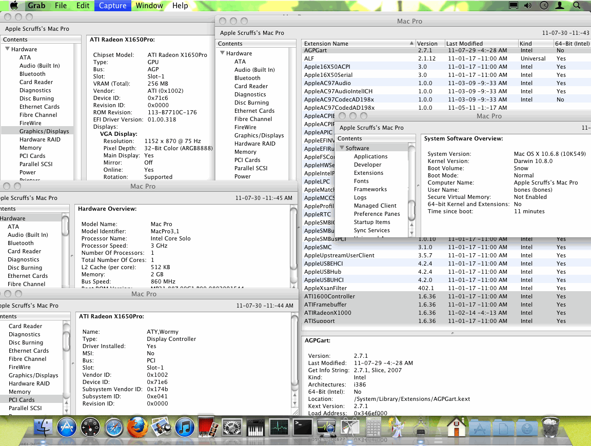

RobertX Posted July 30, 2011 Share Posted July 30, 2011 hmmm.got bored...got my x1650PRO (Sapphire) AGP working with this method kinda...at login getting a white screen...login blind...and then logout blind (SHIFT+APPLE KEY+Q)...login screen then pops up and i can login...also no resolution change(blue screen...then reboot) all on 10.6.8 using nawcom's legacy_kernel with SSE3 emulation...never give up... Link to comment https://www.insanelymac.com/forum/topic/214208-evoenabler-for-x1000-series-ati-radeon-under-snow-leopard-1063/page/3/#findComment-1726111 Share on other sites More sharing options...
