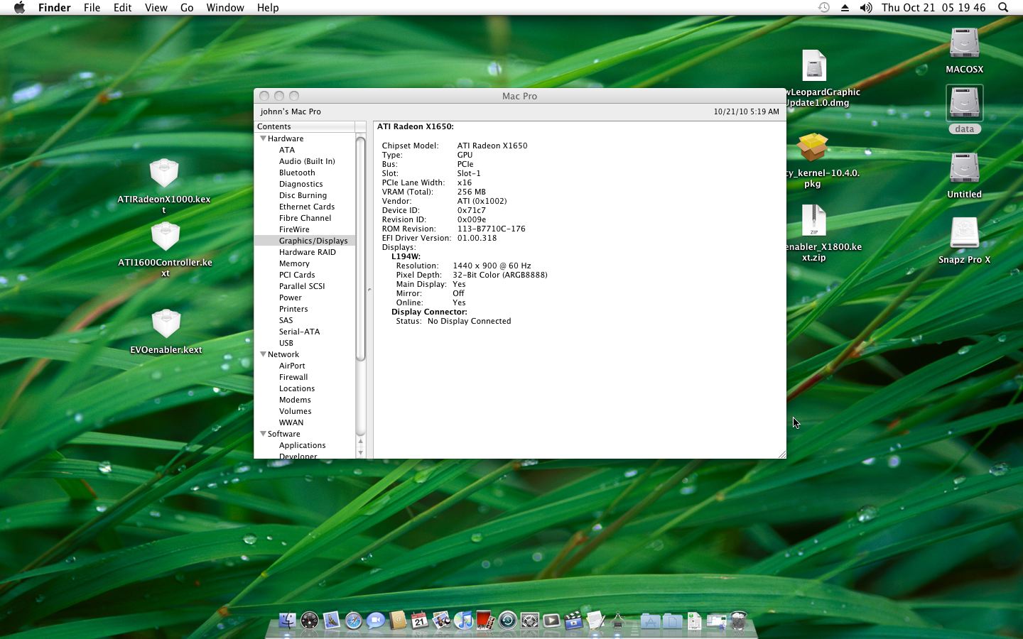

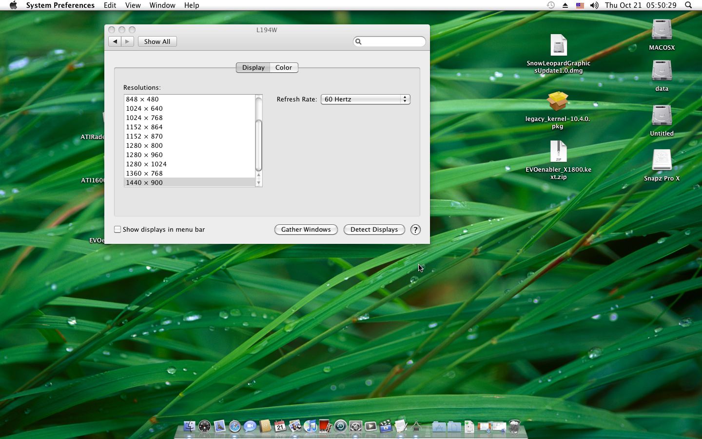

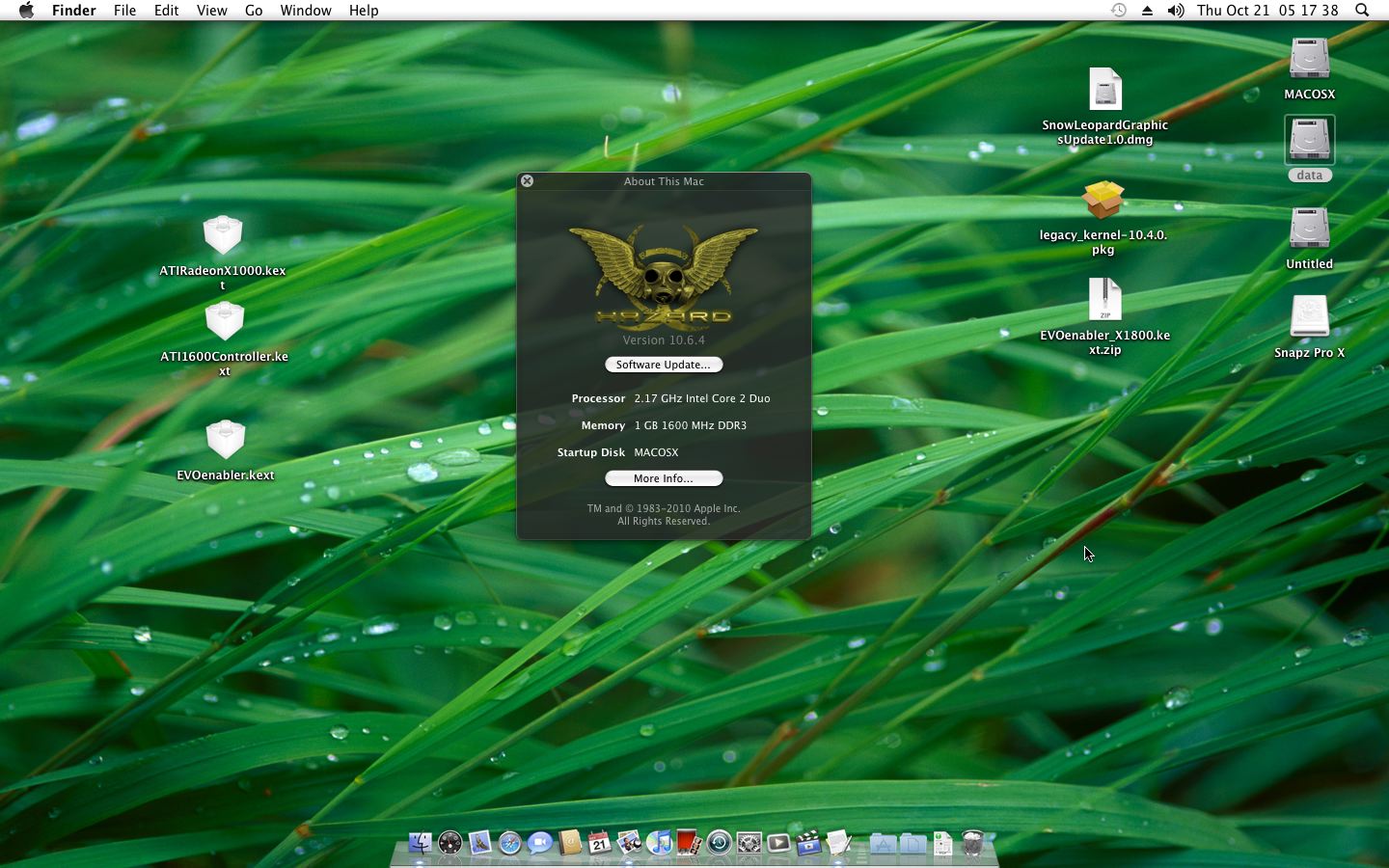

ljohn Posted October 21, 2010 Share Posted October 21, 2010 Thx a lot for sharing that. It does the job for me with x1600 (71C2) First : i updated to 10.6.4, leave the installer open and install kernel Install 10.4 Kernel http://www.kexts.com/view/415-legacy_kerne..._intel-amd.html reboot set boot to 32bit with arch=i386 ( for chameleon) in boot.plist i stored in Extra here is the code : <?xml version="1.0" encoding="UTF-8"?> <!DOCTYPE plist PUBLIC "-//Apple//DTD PLIST 1.0//EN" "http://www.apple.com/DTDs/PropertyList-1.0.dtd"> <plist version="1.0"> <dict> <key>Boot Graphics</key> <string>Yes</string> <key>EthernetBuiltIn</key> <string>Yes</string> <key>Graphics Mode</key> <string>1680x1050x32</string> <key>GraphicsEnabler</key> <string>Yes</string> <key>Kernel</key> <string>legacy_kernel</string> <key>Kernel Flags</key> <string>arch=i386</string> <key>PciRoot</key> <string>1</string> <key>Quiet Boot</key> <string>No</string> <key>Timeout</key> <string>5</string> </dict> </plist> 1. EVOenabler from Post1 i changed all to Wormy 2. SnowLeopardGraphicsUpdate1.0 http://supportdownload.apple.com/download....csUpdate1.0.dmg 3. set dev ID to 71C2 for my card in 1600controller kext and atiradeon1000 kext Repair with kext utility http://www.kexts.com/view/447-kext_utility...ow_leopard.html reboot bingo Again thx a lot for your work here. It saves my Day ( and the older Radeon too ) On the Radeon X1650 id:71c7 with modified kexts RadeonX1000.kext gives a kernel panic, and without kexts RadeonX1000.kext, 1440x900 resolution and BUT not working Quartz Extreme Link to comment https://www.insanelymac.com/forum/topic/214208-evoenabler-for-x1000-series-ati-radeon-under-snow-leopard-1063/page/2/#findComment-1567619 Share on other sites More sharing options...

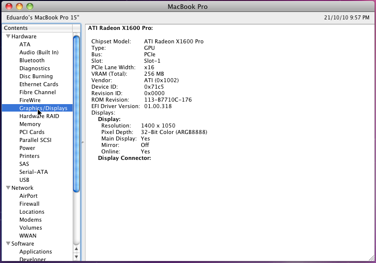

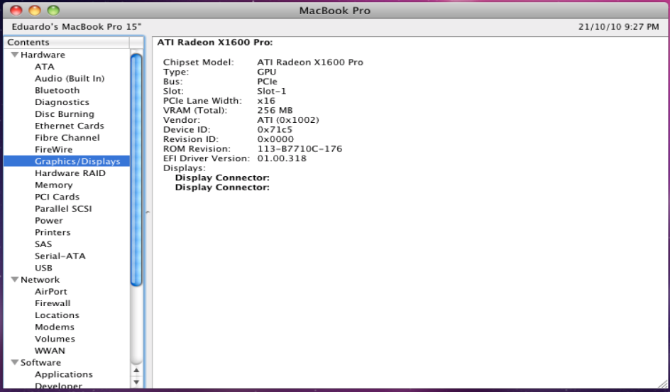

kavliarhs Posted October 21, 2010 Share Posted October 21, 2010 Hi, i saw that you made an Ati mobility radeon X1600 to work using the -f flag. How you have done this??? I have a laptop with the exact card and i cannot make it work. Link to comment https://www.insanelymac.com/forum/topic/214208-evoenabler-for-x1000-series-ati-radeon-under-snow-leopard-1063/page/2/#findComment-1567718 Share on other sites More sharing options...
nofxcwb Posted October 21, 2010 Share Posted October 21, 2010 Looks like it's not just me that is having hard times with the ATI Mobility X1600 on Snow Leopard. For me QE/CI works with retail installation and remains working after all updates including Snow Leopard Graphics Update, I have to remove ATI1600Controller.kext though, otherwise I get a Kernel panic. It would be already ok for me if I was not stuck in the 1400x1050 resolution. All I want is to be able to use 1680x1050. I've been trying many things starting from DSDT change (for 3 weeks) then ATIInject and lately EVOenabler since I gave up on DSDT and I stumbled upon this thread. My problem when I load either ATIInject or EVOenabler (from this thread, with the required changes) is that I get no display at all. Everything else still works, even resolution change as I could verify connecting through VNC, but in the laptop itself I have the infamous Black Screen. I'm using just the EVOenabler.kext in the /Extra/Extensions, everything else is vanilla. Does anyone have a clue on how to solve the "no display" problem? For me it is pretty clear that it is the cause of the black screen, as you have no display to output to. Thanks a lot for all of you that shared your solutions, it is being really helpful! Just a tip for other folks in this thread: I noticed that with -f the ATI1600Controller.kext is not loaded, even if it is in S/L/E and cached. Then you get the false hope that everything is ok, but in reality it's not. Here is what I have, notice the lack of displays in the second screenshot: Without loading x1600 driver: With x1600 driver: Link to comment https://www.insanelymac.com/forum/topic/214208-evoenabler-for-x1000-series-ati-radeon-under-snow-leopard-1063/page/2/#findComment-1567897 Share on other sites More sharing options...
