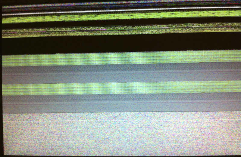

blackosx Posted December 23, 2010 Share Posted December 23, 2010 The nieces are watching a movie.. he he.. so I've grabbed some quick play time I have built a bootable revolution USB stick and have tried booting.. I get to see the grey screen with the Apple logo, but I don't see the kernel spinner at all. Then after maybe two or three seconds I see a scambled screen at which point the machine has frozen. So I'm getting somewhere I've attached a screenshot. EDIT: I applied the diff.txt posted above and now the system doesn't freeze, in that I can still use the keyboard to ctrl-alt-delete to reset. But I still don't get to see the throbber / spinner when at the grey screen with Apple logo. Am I right from reading dgsga's post above that I should be able to press v at boot to enter verbose mode? Link to comment https://www.insanelymac.com/forum/topic/208807-how-to-boost-the-os-x-boot-process/page/6/#findComment-1607905 Share on other sites More sharing options...
blackosx Posted December 24, 2010 Share Posted December 24, 2010 Let's start with the USB-stick. 1.) What format is it? GUID Partition Table (Mac OS Extended Journaled)? 2.) The checkbox with the text: "Ignore ownership on this volume" (Get Info dialog) is not be ticked? 3.) You have the files I mentioned in post #135? - Make sure to include S*/L*/C*/c*/S*/Extensions.mkext (the OS X one) and to have com.apple.Boot.plist in the right spot. 4.) Have you checked the group/ownership of the files? 5.) Do you have: /Extra/ACPI/dsdt.aml or can you normally boot without it? Note: See also post #64 And yes. Verbose mode from keyboard is broken (if you look at boot2/options.c you'll understand why). Sorry. Use Kernel Flags in com.apple.Boot.plist for now. Hi DHP - Thanks for you reply. Yep - I've done all those things but can you check my settings from the attached zip archive? I'll also PM you my private_data.h file as maybe that's the issue? blackosx_report_For_DHP.zip Link to comment https://www.insanelymac.com/forum/topic/208807-how-to-boost-the-os-x-boot-process/page/6/#findComment-1608097 Share on other sites More sharing options...
blackosx Posted December 24, 2010 Share Posted December 24, 2010 Hi blackosx, I just received your private_data.h and looked at it, and like I replied to you per PM, your SMBIOS data structure appears to be invalid – two first lines. That will make it break. Hi dutchhockeypro Thanks for the reply and well spotted with the first line of the SMBIOS data, yep that's my error as I left it in to remind me to add the backslash at the end of each line.. I'll remove that. and yes, the PUT_YOUR_STATIC_ACPI_BASE_ADDRESS_HERE value. I'm not sure about where to find that so I just used your value.. maybe that's one key cause for me not having a successful boot? Notes to everyone: Start with the dynamic CPU, SMBIOS and ACPI patching first, and then continue with the far more restrictive way of forwarding your data since the slightest error will make it break. Dynamic patching? how does that work exactly? - I guess it's noob hour again do I just remove the SMBIOS data from my private_data.h ? But thinking about me not seeing the spinner / throbber - I guess it means the booter is not finding the kernel, even though it's on my USB? Link to comment https://www.insanelymac.com/forum/topic/208807-how-to-boost-the-os-x-boot-process/page/6/#findComment-1608172 Share on other sites More sharing options...
blackosx Posted December 24, 2010 Share Posted December 24, 2010 Thanks for the details. Normally yes (I think) but why don't you boot in verbose mode to see what is going on? I added -v to the kernel flags in my com.apple.boot.plist but it made no difference and all I saw was the grey screen with the Apple Logo. I'll try it again when I get a chance. But no problems - there's no immediate rush with this.. and as you've said it's Christmas Eve today so in about an hour I'll be leaving work and not touching my computers for a short period.. Link to comment https://www.insanelymac.com/forum/topic/208807-how-to-boost-the-os-x-boot-process/page/6/#findComment-1608178 Share on other sites More sharing options...
blackosx Posted December 24, 2010 Share Posted December 24, 2010 Oh that settles it. It can't even locate com.apple.Boot.plist Must be the way your USB-stick is setup, or should I say the very very restrictive way of Revolution dealing with stuff like this – written to become the in-BIOS version, eventually. Lol.. Yeah - I've probably done something wrong with my setup. But the process is simple and straightforward for you as you're familiar with it, though for me I'm still wandering about in the dark.. I'll re-visit it another time, but for now let's enjoy our Christmas Link to comment https://www.insanelymac.com/forum/topic/208807-how-to-boost-the-os-x-boot-process/page/6/#findComment-1608184 Share on other sites More sharing options...
