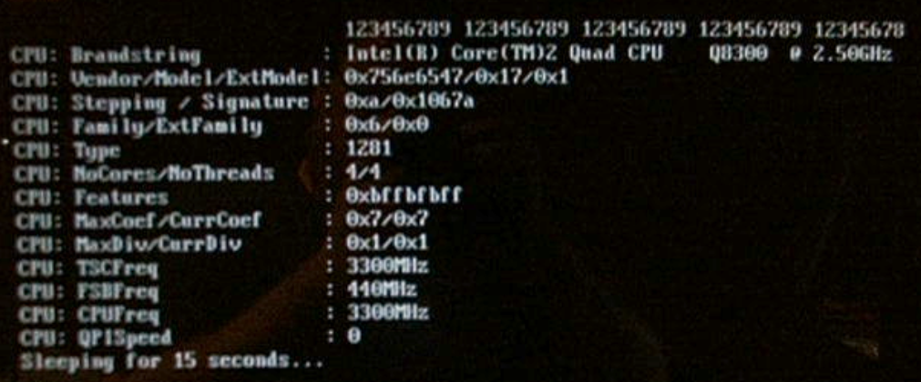

I am also looking for some explaining of all the static cpu info (I have dumps from linux and info from google) but am not sure where what is supposed to go. Some are easy but other I am not sure
#define STATIC_CPU_Vendor 0x756E6547 <-this is intel right ?
#define STATIC_CPU_Signature 0x20652 <-not sure where to get this
#define STATIC_CPU_Stepping 10 <- from linux
#define STATIC_CPU_Model CPU_MODEL_DALES_32NM <- again not sure (Yorkfield)
#define STATIC_CPU_Family 6 <-from linux
#define STATIC_CPU_ExtModel 2 <-from where ?
#define STATIC_CPU_ExtFamily 0 <-from where ?
#define STATIC_CPU_Type 0x901 <-from where ?
#define STATIC_CPU_NoCores 4 <-from linux
#define STATIC_CPU_NoThreads 4 <-from where ?
#define STATIC_CPU_Features 0xbffbfbff <-from where ?
#define STATIC_CPU_CurrCoef 0x11 <-from where ?
#define STATIC_CPU_MaxCoef 0 <-from where ?
#define STATIC_CPU_CurrDiv 0 <-from where ?
#define STATIC_CPU_MaxDiv 0 <-from where ?
#define STATIC_CPU_TSCFrequency 226100000ULL <-from where ?
#define STATIC_CPU_FSBFrequency 133333333ULL <- mine is 800Mhz what goes in here ? 800000
#define STATIC_CPU_CPUFrequency 226100000ULL <- mine is 2400Mhz what goes in here ? 2400000
#define STATIC_CPU_QPISpeed 33500[/code] <-from where ?
So above all in blue I have values from Linux dump, the rest I am not sure how to get, or how to convert it to the right value based on information for my cpu, see attached cpuinfo.txt and dmicode_uptocpu.txt as well as Intel specs

Hi Groot,
Everything you need can be obtained by using dynamic CPU data and enabling DEBUG_CPU (note the change I mentioned earlier here). That will dump the values you are looking for.
Using the data from the debug in static, but once I enable static CPU data then I get a reboot loop just when boot starts running, right after this :
Static Debug info is :
Yes I have over clocked to 3,3GHz and yes it runs nice a cool like this.

so the over-clocking should not make a change. I can set it back to default (6*400=2400) currently it is 7,5 * 440 = 3300 so maybe it does not like the 7,5 bit. Let me test it. I am more worried about the rebooting. sysctl -a | grep cpu is also attached just to see what I get from it. Looks like everything is in there, except the multiplier
sysctlgrepcpu.txt
Ok the reboot is caused because boot wants to "overclock" or set clock and the values it have is placing the CPU out of specks causing the protection from bios to reboot the system, with a nice warning when I enter bios about it. I have played and looked at all the values and also where they are applied, but still no luck. For now I use dynamic cpu (but the info is NOT correct) and I see some errors in the Kernel log like this :
P-State Stepper Error 18 at step 37 on CPU 0
P-State Stepper Error 18 at step 33 on CPU 2
This was not there before. I will go back to my old setting for now and test some more.

below is my current settings for q8300, I have also tried most variants
#define STATIC_CPU_Signature				0x1067a
#define STATIC_CPU_Stepping				0xa
#define STATIC_CPU_Model				CPU_MODEL_PENRYN
#define STATIC_CPU_Family				0x6
#define STATIC_CPU_ExtModel				0x1
#define STATIC_CPU_ExtFamily				0x0
#define STATIC_CPU_Type					0x501
#define STATIC_CPU_NoCores				0x4
#define STATIC_CPU_NoThreads				0x4
#define STATIC_CPU_CurrCoef				0x6
#define STATIC_CPU_MaxCoef				0x7
#define STATIC_CPU_CurrDiv				0x1
#define STATIC_CPU_MaxDiv				0x1
#define STATIC_CPU_TSCFrequency			2400000000
#define STATIC_CPU_FSBFrequency			0400000000
#define STATIC_CPU_CPUFrequency			2400000000
#define STATIC_CPU_QPISpeed				0
look in Revolution-641/i386/libsaio/cpu/essentials.h for the name. Only way I see other than unknown cpu is by using static smbios data pulled from a chameleon boot showing Quad-Core Intel Xeon

If not give it a try because when you have a big OC AppleIntelCPUPowerManagement.kext does not work right because he want to use default value for p, c state and so on. So when in OC we have to get rid of speedstep and appleCPU management so we can go with the freq and volts we want (but we loose stop or reboot, I don't remember right).
Only non standard kext I use is fakesmc and the one for audio. The rest of my system is completely vanilla and native speed-stepping works. It is something about when the values are static that makes it not to work. I have to play with it until I get it right. I have currently the OC turned off completely so I am running stock 6*400=2400
Yes, because if you go vanilla you need to keep also your CPU in a "vanilla" state so no OC.
If you make just a little Oc it can still works pretty well but when you have a big OC things go wrong because the system want to use different value (the one for a non OC CPU) than the ones set in bios.
I thought that Apple don't support more than a defined CPU freq. and so when our overclocked CPU Freq is higher than the apple limit we start to have problem with the OC and power management.
Hope this make sense.
I believe that if you want to OC you need to get rid of speedstep using NullCPUPowerManagement.kext
This will keep your system always at full speed and for a desktop computer it could be acceptable.
