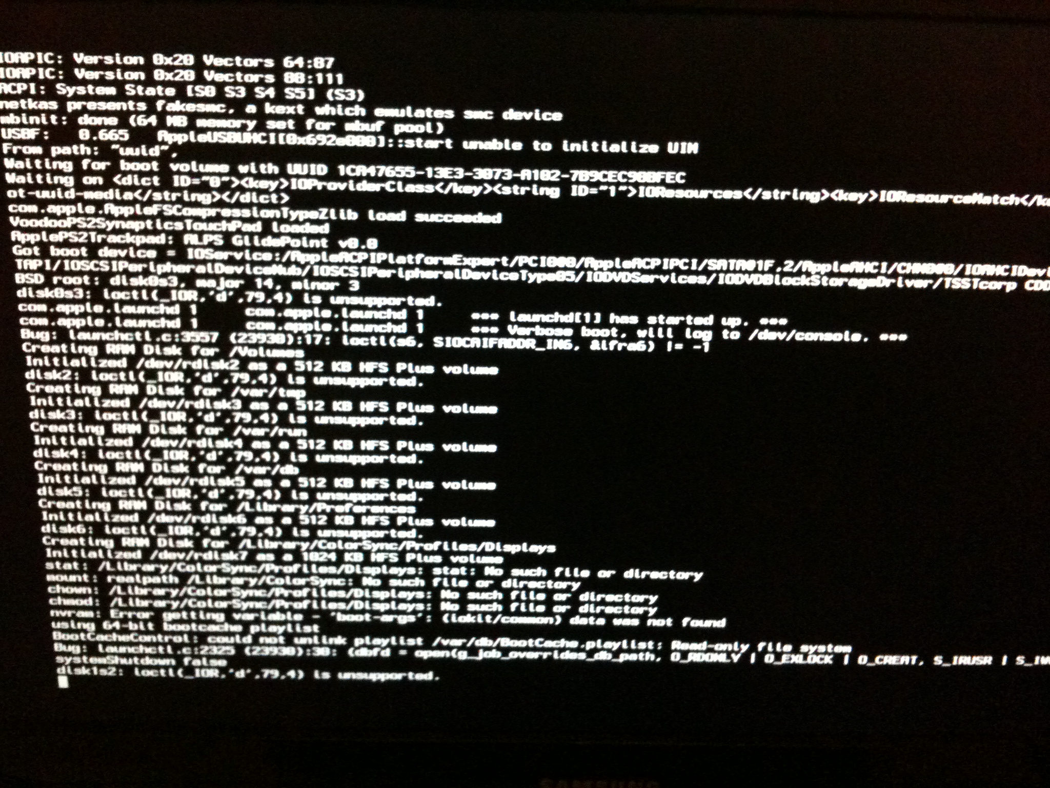

Hello I have
Asus P6T Deluxe v2 BIOS Version: 1108 / i7 980x 3.33 / Gigabyte 9800 GT 1 GB / 12 GB Corsair Dominator DDR3 CMP12GX3M3A1600C9 / 256 GB SSD /
I have tried the USB install method and the CD method both give me a black screen when booting with -v (frozen silver apple logo when not) screen goes black after kexts are loaded and installer reaches "loading darwin x86"
when using the USB method I have added the 980x DSDT to the USBs EXTRA folder
I thought it may be the video card have tried -x and GraphicsEnabler=n and arch=i386
I have even put a Asus Nvidia 8500 which works flawlessly in my other hackintosh in and I get the same problem
I have tried pulling all the ram sticks except one with no joy.
I have one SSD drive attached and one SATA DVD drive. No other peripherals.
Using Apple USB keyboard and Mouse.
Any help or ideas would be greatly appreciated.Thanks in advance
Hi barren,
Both 980x & SSD need S/L 10.6.3 at least to work. 9800 GFx should be fine as is (ie no boot flags etc).
Apple keyboard 'May not' have Delete key recognised by Bios (my model anyway). This does not stop
install in anyway just annoying (notified Asus tech support but no fix yet)..

Many thanks for the reply. I am using a retail 10.6.3 SL install DVD.
More details:
SSD plugged into SATA port 1, DVD drive to SATA port 3.
Memory in orange slots. timings manually typed into BIOS (9-9-9-24) also tried all on Auto.
Video Card in blue PCI-E slot
Temps all normal: 33 degrees
Last few lines after loading kexts and before black screen read when using USB boot method:
Patched DMI table
Loaded HFS+ File [Extra/DSDT.aml]
Using PCI-Root-UID value:0
Lan Controller [llab:4364]
Setting up lan keys
Patched DMI table
Found SMBIOS System Information Table 1
Customizing SystemID with:
Patched DMI Table
Loaded HFS+ file: [Extra/DSDT.aml]
PADT: Restart Fix applied
Patched ACPI version 2 DSDT
Starting Darwin x86

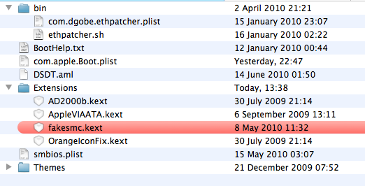

My Extra folder on my USB key looks as follows:
Edit: I have successfully loaded Window XP SP2 onto this machine on another drive.
Your system appears to be set up correctly. There is later kexts for extra which you can add when using
usb installer method (see iFabio post#4), this probably will not change your situation. There was some
discussion a while back about problem's with some SSD's. Your Bios timings should not effect install as long
as the other settings are as post#1. I'm guessing SSD is problem.
As you have another hack try installing S/L direct to the SSD (externally) then plug back into your machine.
If your not sure how google " Install Snow Leopard (10A432) " (link not allowed here). Obviously use installer
DSDT etc from here (make sure you select your SSD drive when installing these)..

I tried this and tried booting into single user mode to rebuild Extensions.mkext cache and the same thing happened, kexts load and and then a black screen. I think the kernel is panicking because it resets the BIOS settings on reset.
I tried installing from USB and boot CD onto a velociraptor with no SSD attached. same issue.
