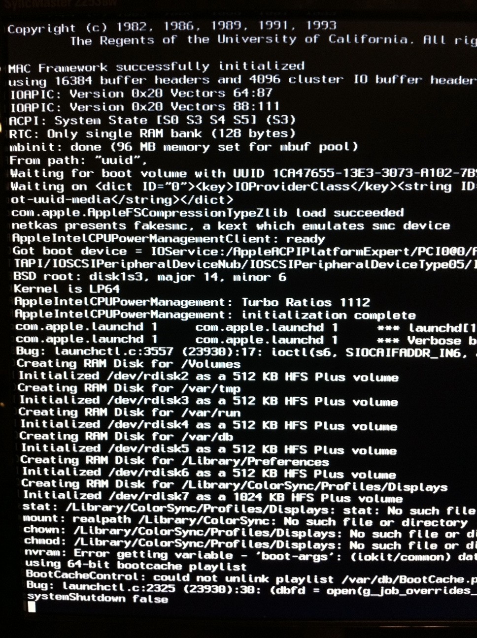

iBdb Posted November 19, 2010 Share Posted November 19, 2010 I now booted with the -v (verbose) option and it told me that it was still waiting for the root device, apparently it is not finding it with a certain UUID. When doing your install disconnect all but the H/D you intend to use and make sure that it is connected to the first SATA port on your Mobo (consult manual if unsure). Maybe 2TB recognised then or after Update, if not search for a topic on this. @ iFabio Thanks for your clarity on MacPro Model's. Also I have read reports of 4870x2 being supported in 10.6.5 so I'm considering trying this card again. My question for you is apparently in tonymacsx86 [url="http://www.insanelymac.com/forum/topic/279450-why-insanelymac-does-not-support-tonymacx86/"]#####[/url] ATI HDMI support can be added (in/to?) via DSDT, how should I go about trying to add this to your DSDT (without upsetting it otherwise). Any suggestion's greatly appreciated. EDIT: 4870x2 working natively with (DVI-VGA dongle) after 10.6.5 & GU Update 2048vram recognised Awesome Props to the guys & girls at Apple who slipped this one in.. Link to comment https://www.insanelymac.com/forum/topic/208724-guide-new-snow-leopard-retail-on-asus-p6t-deluxe-v1v2/page/55/#findComment-1586885 Share on other sites More sharing options...
Morkeleb Posted November 19, 2010 Share Posted November 19, 2010 When doing your install disconnect all but the H/D you intend to use and make sure that it is connected to the firstSATA port on your Mobo (consult manual if unsure). Maybe 2TB recognised then or after Update, if not search for a topic on this. You mean while installing it can only deal with one but after it's finished I can plug in the other drives again without problem? Also I am wondering, is the chameleon build used in the 1.15 installer a bit out of date? If so, what do I have to do to have a later chameleon (which one do you recommend?) but still have the fixes of the 1.15 installer? Link to comment https://www.insanelymac.com/forum/topic/208724-guide-new-snow-leopard-retail-on-asus-p6t-deluxe-v1v2/page/55/#findComment-1587010 Share on other sites More sharing options...
iBdb Posted November 19, 2010 Share Posted November 19, 2010 You mean while installing it can only deal with one but after it's finished I can plug in the other drives again without problem? Also I am wondering, is the chameleon build used in the 1.15 installer a bit out of date? If so, what do I have to do to have a later chameleon (which one do you recommend?) but still have the fixes of the 1.15 installer? It is best to remove all the variables to ensure successful install, yes connect other drives after. If you have windows you will have to change to run on 'AHCI' (Google it). Do this via manual navigation or cmd's not programmes. Once again do this with only this drive connected (remember keep 1st SATA for OSX Disk). Yes chameleon version is old so after all up and running you can update to RC5.rev354 I attached to my post#1315. There is later but this is tried, proven and stable with our hardware. (it still works well without updated version) I'm sure when dgobe get's around to making the new installer it will include an even later version. Link to comment https://www.insanelymac.com/forum/topic/208724-guide-new-snow-leopard-retail-on-asus-p6t-deluxe-v1v2/page/55/#findComment-1587039 Share on other sites More sharing options...

Morkeleb Posted November 19, 2010 Share Posted November 19, 2010 It is best to remove all the variables to ensure successful install, yes connect other drives after. If you have windowsyou will have to change to run on 'AHCI' (Google it). Do this via manual navigation or cmd's not programmes. Once again do this with only this drive connected (remember keep 1st SATA for OSX Disk). Yes chameleon version is old so after all up and running you can update to RC5.rev354 I attached to my post#1315. There is later but this is tried, proven and stable with our hardware. (it still works well without updated version) I'm sure when dgobe get's around to making the new installer it will include an even later version. Thanx for your response. AHCI for windows is no problem, since i installed it with AHCI enabled so I do not need to change anything there. I had AHCI enabled all the time already. With "remove all the variables" do you mean the kernel options like GraphicsEnabler=n? At least for the installer I really have to provide it or bootup is not successfull and I cannot install (after a while i get a box with text in various languages telling me I have to power down and up again, but that does not help). Why would I need to remove all variables for a successfull install (why are those options then even mentioned in the initial post of this thread)? I thought the second phase of installation (when snow leopard is already on harddisk) is the same since no specific drivers are installed at that time yet (specifically no specific graphics driver). Any ideas on the 2tb drive problems? Do you think the problem comes from chameleon or old drivers? I searched a bit but only heared from one other person of such a problem, but no resolution. I read that the latest version 10.6.5 indroduces problems with some drivers. Do you recommend avoiding upgrading to it for now, or are there fixes? Btw, my hardware is: - P6T Deluxe (v1) board with 6gb ram and core i7 920 cpu (no extra soundcard, i use the one on-board) - Nvidia GTX 470 - 4 sata harddrives (1x1tb, 1x1,5tb, 1x2tb and 1x750gb) - 1 sata blu-ray drive Thanx in advance! Link to comment https://www.insanelymac.com/forum/topic/208724-guide-new-snow-leopard-retail-on-asus-p6t-deluxe-v1v2/page/55/#findComment-1587188 Share on other sites More sharing options...

iBdb Posted November 19, 2010 Share Posted November 19, 2010 @Morkeleb No just keep it simple the less hardware connected the less chance of problems and easier to trace if there is any. Sorry this is really just common sense and the way any new O/S 'Should' be installed but even more so here because you are putting an O/S onto a system it's not designed for. dgobe's installer installs everything you need just select DSDT for your processor & install pkg. Then follow post install directions from first post. For 10.6.5 update go to link below for audio & lan fix instructions http://www.insanelymac.com/forum/index.php...t&p=1579951 Sorry no idea on 2TB, best to get up & running 1st. Search Forum may give you a definitive answer or try once installed. System Repair on a hackintosh Hi Guys. Whats the best solution to repair system files and problems on a Hackintosh? Personally I've never been a fan of system repair tools. That's the brilliance of OSX if you like to dabble in places you really shouldn't it's as simple as 'Oops nobody sore that' and restore from 'Time Machine' Link to comment https://www.insanelymac.com/forum/topic/208724-guide-new-snow-leopard-retail-on-asus-p6t-deluxe-v1v2/page/55/#findComment-1587221 Share on other sites More sharing options...
Morkeleb Posted November 19, 2010 Share Posted November 19, 2010 @MorkelebNo just keep it simple the less hardware connected the less chance of problems and easier to trace if there is any. Sorry this is really just common sense and the way any new O/S 'Should' be installed but even more so here because you are putting an O/S onto a system it's not designed for. It makes sense removing any non essential harddrive or hardware while installing. But I can't remove the graphics card or I would not have hardware to draw the screen. And I get the reboot error message even with just the one harddrive attached if I do not provide the GraphicsEnabler=n option. So unless you have a suggestion that is doable to avoid the GraphicsEnabler=n option, I will have to keep using it. I'll post an update once I tried reinstalling with just one harddrive attached on port 1. Link to comment https://www.insanelymac.com/forum/topic/208724-guide-new-snow-leopard-retail-on-asus-p6t-deluxe-v1v2/page/55/#findComment-1587297 Share on other sites More sharing options...

iBdb Posted November 20, 2010 Share Posted November 20, 2010 It makes sense removing any non essential harddrive or hardware while installing.But I can't remove the graphics card or I would not have hardware to draw the screen. And I get the reboot error message even with just the one harddrive attached if I do not provide the GraphicsEnabler=n option. Ok briefly there are several things going back looking at your signature (please add it via 'My Controls', top of page above 'logged in as'). Prior to 10.6.3 Blue Ray (& SSD) drives were troublesome but getting as far as you have probably rules that one out and also having more than 2GB Ram installed, if your 6GB is not recognised add AppleVIATTA.kext (see post#4). I gather you have not researched about your GFx card and what is needed to make it working. There is possibly more but with a quick search I found this link (below) about your card. Read up on what is needed for you.. http://www.insanelymac.com/forum/index.php?showtopic=214219 Link to comment https://www.insanelymac.com/forum/topic/208724-guide-new-snow-leopard-retail-on-asus-p6t-deluxe-v1v2/page/55/#findComment-1587593 Share on other sites More sharing options...
Morkeleb Posted November 20, 2010 Share Posted November 20, 2010 I gather you have not researched about your GFx card and what is needed to make it working. There is possiblymore but with a quick search I found this link (below) about your card. Read up on what is needed for you.. http://www.insanelymac.com/forum/index.php?showtopic=214219 I did research about my graphics card and I already found the topic you are referring to. I used this post as guideline: http://www.insanelymac.com/forum/index.php...t&p=1585867 Partly it worked, partly it did not: - When trying to boot from the harddisk itself, it gives me some boot0 error - When using my usb chameleon boot (though still the original version from post 1) and I select the right partition. it will boot up correctly, and I have proper working graphics. - Also all other paritions including the 2tb drive is correctly detected and usable - Sound works - I'm not sure the graphics really work to their potential: - it does not detect which gpu I have in the system profiler - cinebench does detect my gtx 470 properly - when running cinebench i get very low mark of 8.31 fps (a slower gtx 460 card gets 23.91 fps). i will try to find out if something is not properly set up. I modified that guide slightly for my purposes though: Before installing the chameleon version provided there i installed the p6t 1.15 package after upgrading to 10.6.5 so the kext files are replaces and so the network card works. After installing the fermi drivers (i used kext tool to update caches and correct permissions) I ran the perl script to correct audio. What I would like to understand: When using the boot loader from usb stick, will the chameleon boot loader on the harddrive be bypassed and not come into action at all (meaning only the version on usb stick is used and only Boot.plist file on usb stick is used)? I guess I shall try to install another version of chameleon and see if that helps (the one you mentioned). However booting from usb stick is not a real problem for me, i'll try to tweak the booting though (hiding not bootable partitions, select default boot partition). UPDATE: I tried both chameleon 2 rc5 r354 and the chameleon with the p6t deluxe insaller 1.15 on the snow leopard partition and both cause a boot0 error message when trying to boot from that drive. I at least managed to upgrade to chameleon 2 rc5 r354 on the usb stick, and booting with that version from there works fine. What might the problem with this boot0 error be? UPDATE2: I change to chameleon 2 rc5 r629 and with this the gpu is also properly detected. Also I managed to improve open gl performance noticably to 23.04 fps in cinebench 11.5 by changing the string of key SMproductname from MacPro4,1 to MacPro3,1 in /Extra/smbios.plist I still don't have any idea about the boot0 error of chameleon when booting from harddisk. Link to comment https://www.insanelymac.com/forum/topic/208724-guide-new-snow-leopard-retail-on-asus-p6t-deluxe-v1v2/page/55/#findComment-1587699 Share on other sites More sharing options...
