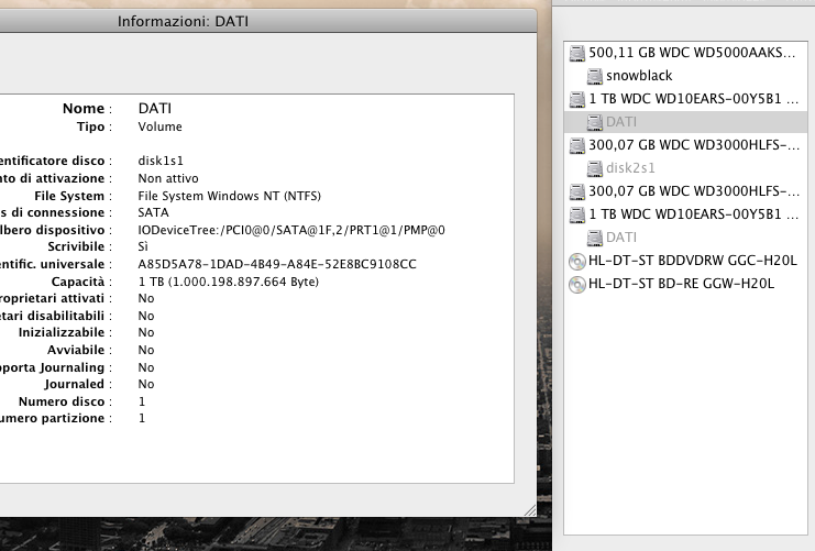

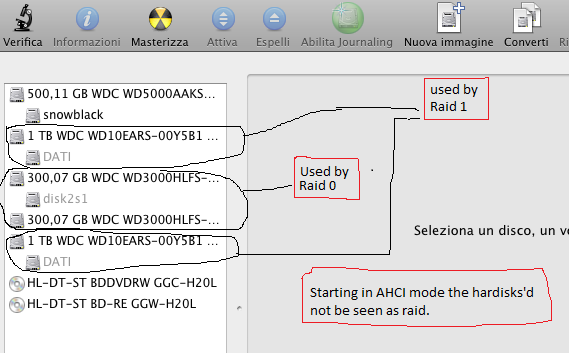

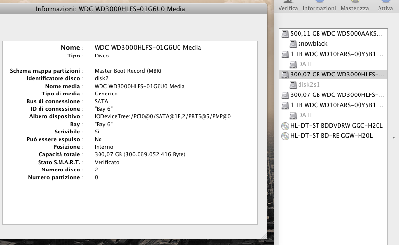

blackwalker Posted October 22, 2010 Share Posted October 22, 2010 hi, one question here are my hardisks: - 1 hardisk with snow leopard (ahci) - 2 hardisks raid 0 (windows7) - 2 hardisks raid 1 (data) Problem on startup, have 2 messages: "the disk you inserted was not readable by the computer" i try this but dont work: DiskUtilityGetInfo on hardisk with ntfs got the name/label and uuid of hardisks terminal: sudo nano /etc/fstab added for each hardisk with ntfs: LABEL=name none ntfs ro,noauto,noowner or UUID=XXX-XXXX-XXX-XXX-XXX none ntfs ro,noauto,noowner CTRL+O then ENTER (to save it) CTRL+X (to exit) if i open diskutility i still see all 4 ntfs hardisks, but say now, if i select one that i can activate it. Before it autoactivate them. But i still got these 2 messages!! About the 2 hardisks raid 1 i can get name and uuid, About the 2 hardisks raid o i cant get name and uuid... what else i can try? hope someone can give me a hand!! thx Link to comment Share on other sites More sharing options...

ErmaC Posted October 22, 2010 Share Posted October 22, 2010 hi, one question here are my hardisks: - 1 hardisk with snow leopard (ahci) - 2 hardisks raid 0 (windows7) - 2 hardisks raid 1 (data) Problem on startup, have 2 messages: "the disk you inserted was not readable by the computer" i try this but dont work: if i open diskutility i still see all 4 ntfs hardisks, but say now, if i select one that i can activate it. Before it autoactivate them. But i still got these 2 messages!! About the 2 hardisks raid 1 i can get name and uuid, About the 2 hardisks raid o i cant get name and uuid... what else i can try? hope someone can give me a hand!! thx For what I know OSX don't manage non Apple Hardware RAID. maybe is for that reason you get those error on startup... Fabio Link to comment Share on other sites More sharing options...
blackwalker Posted October 22, 2010 Share Posted October 22, 2010 For what I know OSX don't manage non Apple Hardware RAID.maybe is for that reason you get those error on startup... Fabio someone in your guide say that he get rid of these messages... And....when i boot with snow leopard, controller on my mobo is set to AHCI not on Raid!! So "i think" the hardisks are seen as normal and not raid! Attached are some screenshots! Someone can PLZ help me? Link to comment Share on other sites More sharing options...

blackwalker Posted October 23, 2010 Share Posted October 23, 2010 I had this 'not readable' message come up the other day when I started my computer with a friends NTFS formattedext H/D connected. I unwisely assumed this message was referring to his ext H/D. I selected Partitioned & format as he requirested then realised it was my Win7 disk (Dam ) I have not re-installed Win7 yet but my preposed solution to this is in the form or couple of free Mac programmes 'MacFUSE' & 'NTFS-3G'. These allow OSX to recognise read/write & even format to NTFS with Disk Utility. (Google them) In theory (could be famous last words) all NTFS partitions will then be 'readable'.. thx for the answer! Dunno if these messages are related to the 2 hardisk in raid 0, cause as you can see in the screenshots, i cant get/have the UUID of them, while i can get the UUID of the other 2 hardisks in raid 0, and i just put (i hope), the correct commands in the fstb file. maybe the problem is the raid 0? anyway i dont wanna have them to recognise read/write, i just wanna get rid of the 2 messages i always get when i log in! Someone suggest me to go to settings/chameleon but i dont have this option under settings!! (maybe because i replace the file "boot" to make the hd 5870 work?) damn disks and damn messages Link to comment Share on other sites More sharing options...
iBdb Posted October 23, 2010 Share Posted October 23, 2010 @blackwalker I think as iFabio said previously. However you can only try the programmes I mention to see if it stop's the error message. There's no guarantees with just a few mb's of download & couple min's to install it May fix it. Chameleon setting's options is in System Preferences if you have RC5 (iFabio post this a few pages back). The boot you're using is a 'Test' boot file that is based either on older or stripped down version than current. Not sure exactly what is different.. @InsaneGrant Hi, lot's of Q's I'll try keep it brief. Forget IDE drive, need SATA.. You only need the USB if you go the USB install route for which you will need access to either a Mac or PC already running OSX, It would be much easier to borrow a natively supported GFx card & burn ISO boot as in Post#1, otherwise to get get your 5870 working strait up you will have to add the latest OSX graphics update plus other requirement's to your 10.6.3 installed onto your USB (This is NOT post #2 method) It is recommended to install OSX first with chameleon, many reasons why but of main concern to someone new to this is to have OSX up & running without adding further complications (if you won't technical reasons please search, one could spend a week going into this). To simplify have only H/D you are installing OS on connected at one time & which size depends on what you intend to put on each OS. You could easy swallow the smaller drive with any of these + extras. Please spend some time reading & researching, most is answered here already including links to relevant to your 5870 GFx card. Link to comment Share on other sites More sharing options...
