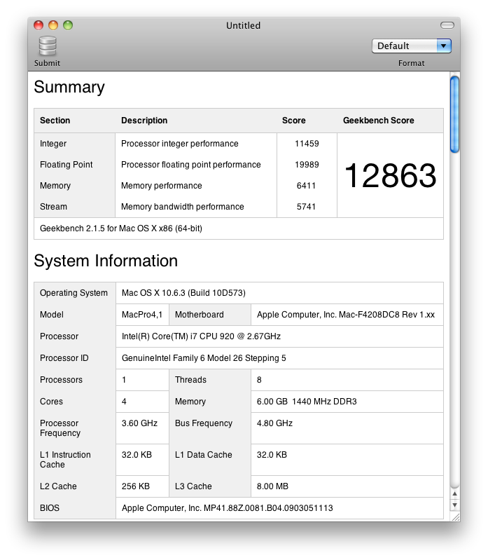

KariNeko Posted May 2, 2010 Share Posted May 2, 2010 - Temp - run kexstat in terminal - MSR Tools result - Geekbench Fabio All below using MacPro4,1 model identifier and the respective FakeSMC plist mod: DSDT 3.14 with MacPro4_1.plist modified for SS: - Temp: 44 - kexstat: Index Refs Address Size Wired Name (Version) <Linked Against> 1 63 0 0 0 com.apple.kpi.bsd (10.3.0) 2 4 0 0 0 com.apple.kpi.dsep (10.3.0) 3 89 0 0 0 com.apple.kpi.iokit (10.3.0) 4 94 0 0 0 com.apple.kpi.libkern (10.3.0) 5 76 0 0 0 com.apple.kpi.mach (10.3.0) 6 27 0 0 0 com.apple.kpi.private (10.3.0) 7 43 0 0 0 com.apple.kpi.unsupported (10.3.0) 8 10 0xffffff7f80600000 0x4000 0x4000 com.apple.iokit.IOACPIFamily (1.3.0) <7 6 4 3> 9 21 0xffffff7f80604000 0x12000 0x12000 com.apple.iokit.IOPCIFamily (2.6) <7 5 4 3> 10 1 0xffffff7f80616000 0x44000 0x44000 com.apple.driver.AppleACPIPlatform (1.3.2) <9 8 7 6 5 4 3> 11 0 0xffffff7f8065a000 0x2000 0x2000 com.superhai.driver.PlatformUUID (1.0.0) <4 3> 12 0 0xffffff7f8065c000 0x1c000 0x1c000 com.apple.driver.AppleIntelCPUPowerManagement (104.3.0) <7 6 5 4 3 1> 13 5 0xffffff7f80678000 0x1a000 0x1a000 com.apple.iokit.IOStorageFamily (1.6) <7 6 5 4 3 1> 14 0 0xffffff7f80692000 0x12000 0x12000 com.apple.driver.DiskImages (283) <13 7 6 5 4 3 1> 15 0 0xffffff7f806a4000 0x3000 0x3000 com.apple.driver.AppleIntelCPUPowerManagementClient (104.3.0) <7 6 5 4 3 1> 16 0 0xffffff7f806a7000 0x8000 0x8000 com.apple.nke.applicationfirewall (2.1.11) <7 6 5 4 3 1> 17 2 0xffffff7f806af000 0x3000 0x3000 com.apple.kext.AppleMatch (1.0.0d1) <4 1> 18 0 0xffffff7f806b2000 0x4000 0x4000 com.apple.security.quarantine (0) <17 7 6 5 4 2 1> 19 0 0xffffff7f806b6000 0x8000 0x8000 com.apple.security.sandbox (0) <17 7 6 5 4 2 1> 20 0 0xffffff7f806be000 0x3000 0x3000 com.apple.security.TMSafetyNet (6) <7 6 5 4 2 1> 21 0 0xffffff7f806c1000 0x3000 0x3000 com.apple.driver.AppleAPIC (1.4) <4 3> 22 0 0xffffff7f806c4000 0x4000 0x4000 com.apple.driver.AppleSMBIOS (1.5) <7 4 3> 23 0 0xffffff7f806c8000 0x6000 0x6000 com.apple.driver.AppleRTC (1.3.1) <8 5 4 3 1> 24 11 0xffffff7f806ce000 0x35000 0x35000 com.apple.iokit.IOUSBFamily (3.9.6) <9 7 5 4 3 1> 25 0 0xffffff7f80703000 0x10000 0x10000 com.apple.driver.AppleUSBUHCI (3.9.6) <24 9 7 5 4 3 1> 26 0 0xffffff7f80713000 0x3000 0x3000 com.apple.driver.AppleHPET (1.5) <8 7 5 4 3> 27 6 0xffffff7f80716000 0x42000 0x42000 com.apple.iokit.IOHIDFamily (1.6.2) <7 6 5 4 3 1> 28 0 0xffffff7f80758000 0x4000 0x4000 com.apple.driver.AppleACPIButtons (1.3.2) <27 10 8 7 6 5 4 3 1> 29 0 0xffffff7f8075c000 0x4000 0x4000 org.netkas.fakesmc (2) <8 7 4 3> 30 1 0xffffff7f80760000 0x3000 0x3000 com.apple.driver.AppleEFIRuntime (1.3.0) <7 5 4 3> 32 3 0xffffff7f80765000 0x7000 0x7000 com.apple.iokit.IOAHCIFamily (2.0.3) <5 4 3 1> 33 0 0xffffff7f8076c000 0x12000 0x12000 com.apple.driver.AppleAHCIPort (2.1.1) <32 9 5 4 3 1> 34 0 0xffffff7f8077e000 0x16000 0x16000 com.apple.driver.AppleUSBEHCI (3.9.6) <24 9 7 5 4 3 1> 35 2 0xffffff7f80794000 0x4b000 0x4b000 com.apple.iokit.IOFireWireFamily (4.2.6) <5 4 3 1> 36 0 0xffffff7f807df000 0x28000 0x28000 com.apple.driver.AppleFWOHCI (4.5.7) <35 9 7 6 5 4 3 1> 37 0 0xffffff7f80807000 0x5000 0x5000 com.apple.AppleFSCompression.AppleFSCompressionTypeZlib (1.0.0d1) <6 4 3 2 1> 38 1 0xffffff7f8080c000 0xf000 0xf000 com.apple.iokit.IOATAFamily (2.5.1) <5 4 3 1> 39 0 0xffffff7f8081b000 0x7000 0x7000 com.apple.driver.AppleVIAATA (1.0.2) <38 9 5 4 3> 40 0 0xffffff7f80822000 0x7000 0x7000 com.apple.driver.AppleEFINVRAM (1.3.0) <30 7 5 4 3> 41 0 0xffffff7f80829000 0x2000 0x2000 com.apple.iokit.IOUSBUserClient (3.9.6) <24 7 5 4 3 1> 42 0 0xffffff7f8082b000 0x4000 0x4000 com.apple.BootCache (31) <7 6 5 4 3 1> 43 0 0xffffff7f8082f000 0x44000 0x44000 at.obdev.nke.LittleSnitch (2.2.05) <7 5 4 3 1> 44 0 0xffffff7f80873000 0x11000 0x11000 com.apple.driver.AppleUSBHub (3.9.6) <24 5 4 3 1> 45 1 0xffffff7f80884000 0x4000 0x4000 com.apple.driver.AppleUSBComposite (3.9.0) <24 4 3 1> 46 0 0xffffff7f80888000 0x5000 0x5000 com.apple.driver.AppleUSBMergeNub (3.9.6) <45 24 4 3 1> 47 3 0xffffff7f8088d000 0x19000 0x19000 com.apple.iokit.IOSCSIArchitectureModelFamily (2.6.2) <5 4 3 1> 48 0 0xffffff7f808a6000 0x9000 0x9000 com.apple.iokit.IOAHCISerialATAPI (1.2.3) <47 32 5 4 3 1> 49 0 0xffffff7f808af000 0x15000 0x15000 com.apple.iokit.IOAHCIBlockStorage (1.6.1) <32 13 5 4 3 1> 50 0 0xffffff7f808c4000 0x3000 0x3000 com.apple.driver.XsanFilter (402.1) <13 5 4 3 1> 51 0 0xffffff7f808c7000 0xc000 0xc000 com.apple.iokit.IOUSBMassStorageClass (2.6.1) <47 24 13 5 4 3 1> 53 0 0xffffff7f808d5000 0x10000 0x10000 com.apple.iokit.IOSCSIBlockCommandsDevice (2.6.2) <47 13 5 4 3 1> 55 1 0xffffff7f808ec000 0x2000 0x2000 com.apple.driver.AppleHIDKeyboard (1.2.0a3) <27 4 3> 56 2 0xffffff7f808ee000 0x6000 0x6000 com.apple.iokit.IOUSBHIDDriver (3.9.6) <27 24 5 4 3 1> 57 0 0xffffff7f808f4000 0x2000 0x2000 com.apple.driver.AppleUSBHIDKeyboard (1.2.0a3) <56 55 27 4 3> 58 2 0xffffff7f808f6000 0x42000 0x42000 com.apple.iokit.IOBluetoothFamily (2.3.1f4) <7 5 4 3 1> 59 0 0xffffff7f80938000 0xb000 0xb000 com.apple.driver.AppleUSBBluetoothHCIController (2.3.1f4) <58 24 7 5 4 3> 61 2 0xffffff7f80947000 0x8000 0x8000 com.apple.iokit.IOHDAFamily (9.9.9) <5 4 3 1> 62 7 0xffffff7f8094f000 0x26000 0x26000 com.apple.iokit.IOGraphicsFamily (2.1) <9 7 5 4 3> 63 1 0xffffff7f80975000 0x14000 0x14000 com.apple.driver.AppleHDAController (9.9.9) <62 61 9 5 4 3 1> 64 3 0xffffff7f80989000 0x1a000 0x1a000 com.apple.iokit.IONetworkingFamily (1.9) <7 6 5 4 3 1> 65 0 0xffffff7f809a3000 0x2d000 0x2d000 com.apple.iokit.AppleYukon2 (3.1.14b1) <64 9 5 4 3 1> 66 0 0xffffff7f809d0000 0x3000 0x3000 com.apple.driver.AppleLPC (1.4.11) <9 5 4 3> 67 0 0xffffff7f809d3000 0x2000 0x2000 com.apple.driver.AppleSMBusPCI (1.0.8d0) <9 5 4 3> 68 2 0xffffff7f809d5000 0xc000 0xc000 com.apple.driver.IOPlatformPluginFamily (4.1.1d0) <6 5 4 3> 69 2 0xffffff7f809e1000 0xb000 0xb000 com.apple.driver.AppleSMC (3.0.1d2) <8 7 5 4 3> 70 0 0xffffff7f809ec000 0x11000 0x11000 com.apple.driver.ACPI_SMC_PlatformPlugin (4.1.1d0) <69 68 9 8 7 6 5 4 3> 71 7 0xffffff7f809fd000 0x34000 0x34000 com.apple.iokit.AppleProfileFamily (41) <9 7 6 5 4 3 1> 73 0 0xffffff7f80a39000 0x9000 0x9000 com.apple.iokit.IOFireWireIP (2.0.3) <64 35 5 4 3 1> 74 3 0xffffff7f80a42000 0xe000 0xe000 com.apple.iokit.IONDRVSupport (2.1) <62 9 7 5 4 3> 75 2 0xffffff7f80a50000 0x2ba000 0x2ba000 com.apple.NVDAResman (6.1.0) <74 62 9 5 4 3 1> 76 0 0xffffff7f80d0a000 0x40d000 0x40d000 com.apple.nvidia.nv50hal (6.1.0) <75 4 3> 77 0 0xffffff7f81117000 0x8000 0x8000 jp.plentycom.driver.SteerMouse (4.0.1) <56 27 24 5 4 3 1> 78 2 0xffffff7f8111f000 0x5000 0x5000 com.apple.kext.OSvKernDSPLib (1.3) <5 4> 79 4 0xffffff7f81124000 0x1b000 0x1b000 com.apple.iokit.IOAudioFamily (1.7.6fc2) <78 5 4 3 1> 80 1 0xffffff7f8113f000 0x7c000 0x7c000 com.apple.driver.DspFuncLib (9.9.9) <79 78 5 4 3 1> 81 0 0xffffff7f811bb000 0xb3000 0xb3000 com.apple.driver.AppleHDA (9.9.9) <80 79 74 63 62 61 5 4 3 1> 82 0 0xffffff7f8126e000 0x6000 0x6000 com.apple.driver.IOBluetoothBNEPDriver (2.3.1f4) <64 58 7 5 4 3 1> 83 1 0xffffff7f81274000 0x2000 0x2000 com.apple.iokit.IOSMBusFamily (1.1) <5 4 3> 84 0 0xffffff7f81276000 0xb000 0xb000 com.apple.driver.AppleSMBusController (1.0.8d0) <83 9 8 5 4 3> 85 0 0xffffff7f81281000 0x4000 0x4000 com.apple.driver.AudioIPCDriver (1.1.2) <79 5 4 3 1> 86 0 0xffffff7f81285000 0x8000 0x8000 com.apple.driver.AppleIntelNehalemProfile (11) <71 6 4 3> 87 0 0xffffff7f8128d000 0xb5000 0xb5000 com.apple.GeForce (6.1.0) <75 74 62 9 7 6 5 4 3 1> 89 0 0xffffff7f81344000 0x5000 0x5000 com.apple.Dont_Steal_Mac_OS_X (7.0.0) <69 7 4 3 1> 91 0 0xffffff7f81351000 0x5000 0x5000 com.apple.driver.AppleUpstreamUserClient (3.3.2) <62 9 8 7 5 4 3 1> 93 1 0xffffff7f81358000 0xa000 0xa000 com.apple.iokit.IOSerialFamily (10.0.3) <7 6 5 4 3 1> 94 0 0xffffff7f81362000 0xa000 0xa000 com.apple.iokit.IOBluetoothSerialManager (2.3.1f4) <93 7 5 4 3 1> 96 0 0xffffff7f81371000 0xc000 0xc000 com.apple.iokit.IOSurface (74.0) <7 5 4 3 1> 97 0 0xffffff7f8137d000 0x6000 0x6000 com.Cycling74.driver.Soundflower (1.4.4) <79 5 4 3> 98 0 0xffffff7f81383000 0x3000 0x3000 com.apple.driver.AppleProfileCallstackAction (20) <71 5 4 3 1> 99 0 0xffffff7f81386000 0x2000 0x2000 com.apple.driver.AppleProfileKEventAction (10) <71 4 3 1> 100 0 0xffffff7f81388000 0xa000 0xa000 com.apple.driver.AGPM (100.10.21) <62 9 5 4 3> 101 0 0xffffff7f81392000 0x9000 0x9000 com.apple.driver.AppleTyMCEDriver (1.0.1d8) <68 9 8 7 6 5 4 3 1> 102 0 0xffffff7f8139b000 0x2000 0x2000 com.apple.driver.AppleProfileRegisterStateAction (10) <71 4 3 1> 103 0 0xffffff7f8139d000 0x2000 0x2000 com.apple.driver.AppleProfileThreadInfoAction (14) <71 6 4 3 1> 104 0 0xffffff7f8139f000 0x2000 0x2000 com.apple.driver.AppleProfileTimestampAction (10) <71 5 4 3 1> 105 0 0xffffff7f813a1000 0x3000 0x3000 com.apple.driver.AppleProfileReadCounterAction (17) <71 6 4 3> 106 0 0xffffff7f813a4000 0xa000 0xa000 com.apple.filesystems.autofs (2.1.0) <7 6 5 4 3 1> 107 0 0xffffff7f813ae000 0xe000 0xe000 com.taoeffect.ispy.kext (2.0.1) <5 4 3 1> 108 0 0xffffff7f813bc000 0x5000 0x5000 com.apple.driver.AppleHWSensor (1.9.3d0) <5 4 3> 109 0 0xffffff7f813c1000 0x3000 0x3000 com.regularrateandrhythm.driver.RowmoteIREmu (1.0) <27 24 5 4 3> 110 0 0xffffff7f813c4000 0x32000 0x32000 com.apple.filesystems.smbfs (1.6.1) <7 6 5 4 3 1> - MSR Tools: SS working, idling at 60% of total frequency. CPUPLimit loaded (0x0). - Geekbench: DSDT 3.21 with MacPro4_1.plist modified for SS: - Temp 44 - kexstat Index Refs Address Size Wired Name (Version) <Linked Against> 1 58 0 0 0 com.apple.kpi.bsd (10.3.0) 2 4 0 0 0 com.apple.kpi.dsep (10.3.0) 3 81 0 0 0 com.apple.kpi.iokit (10.3.0) 4 87 0 0 0 com.apple.kpi.libkern (10.3.0) 5 69 0 0 0 com.apple.kpi.mach (10.3.0) 6 27 0 0 0 com.apple.kpi.private (10.3.0) 7 41 0 0 0 com.apple.kpi.unsupported (10.3.0) 8 10 0xffffff7f80600000 0x4000 0x4000 com.apple.iokit.IOACPIFamily (1.3.0) <7 6 4 3> 9 21 0xffffff7f80604000 0x12000 0x12000 com.apple.iokit.IOPCIFamily (2.6) <7 5 4 3> 10 1 0xffffff7f80616000 0x44000 0x44000 com.apple.driver.AppleACPIPlatform (1.3.2) <9 8 7 6 5 4 3> 11 0 0xffffff7f8065a000 0x2000 0x2000 com.superhai.driver.PlatformUUID (1.0.0) <4 3> 12 0 0xffffff7f8065c000 0x1c000 0x1c000 com.apple.driver.AppleIntelCPUPowerManagement (104.3.0) <7 6 5 4 3 1> 13 5 0xffffff7f80678000 0x1a000 0x1a000 com.apple.iokit.IOStorageFamily (1.6) <7 6 5 4 3 1> 14 0 0xffffff7f80692000 0x12000 0x12000 com.apple.driver.DiskImages (283) <13 7 6 5 4 3 1> 15 0 0xffffff7f806a4000 0x3000 0x3000 com.apple.driver.AppleIntelCPUPowerManagementClient (104.3.0) <7 6 5 4 3 1> 16 0 0xffffff7f806a7000 0x8000 0x8000 com.apple.nke.applicationfirewall (2.1.11) <7 6 5 4 3 1> 17 2 0xffffff7f806af000 0x3000 0x3000 com.apple.kext.AppleMatch (1.0.0d1) <4 1> 18 0 0xffffff7f806b2000 0x4000 0x4000 com.apple.security.quarantine (0) <17 7 6 5 4 2 1> 19 0 0xffffff7f806b6000 0x8000 0x8000 com.apple.security.sandbox (0) <17 7 6 5 4 2 1> 20 0 0xffffff7f806be000 0x3000 0x3000 com.apple.security.TMSafetyNet (6) <7 6 5 4 2 1> 21 0 0xffffff7f806c1000 0x3000 0x3000 com.apple.driver.AppleAPIC (1.4) <4 3> 22 0 0xffffff7f806c4000 0x4000 0x4000 com.apple.driver.AppleSMBIOS (1.5) <7 4 3> 23 0 0xffffff7f806c8000 0x6000 0x6000 com.apple.driver.AppleRTC (1.3.1) <8 5 4 3 1> 24 0 0xffffff7f806ce000 0x3000 0x3000 com.apple.driver.AppleHPET (1.5) <8 7 5 4 3> 25 4 0xffffff7f806d1000 0x42000 0x42000 com.apple.iokit.IOHIDFamily (1.6.2) <7 6 5 4 3 1> 26 0 0xffffff7f80713000 0x4000 0x4000 com.apple.driver.AppleACPIButtons (1.3.2) <25 10 8 7 6 5 4 3 1> 27 0 0xffffff7f80717000 0x4000 0x4000 org.netkas.fakesmc (2) <8 7 4 3> 28 9 0xffffff7f8071b000 0x35000 0x35000 com.apple.iokit.IOUSBFamily (3.9.6) <9 7 5 4 3 1> 29 0 0xffffff7f80750000 0x10000 0x10000 com.apple.driver.AppleUSBUHCI (3.9.6) <28 9 7 5 4 3 1> 30 2 0xffffff7f80760000 0x7000 0x7000 com.apple.iokit.IOAHCIFamily (2.0.3) <5 4 3 1> 31 0 0xffffff7f80767000 0x12000 0x12000 com.apple.driver.AppleAHCIPort (2.1.1) <30 9 5 4 3 1> 33 0 0xffffff7f8077b000 0x5000 0x5000 com.apple.AppleFSCompression.AppleFSCompressionTypeZlib (1.0.0d1) <6 4 3 2 1> 34 0 0xffffff7f80780000 0x16000 0x16000 com.apple.driver.AppleUSBEHCI (3.9.6) <28 9 7 5 4 3 1> 35 1 0xffffff7f80796000 0x3000 0x3000 com.apple.driver.AppleEFIRuntime (1.3.0) <7 5 4 3> 36 2 0xffffff7f80799000 0x4b000 0x4b000 com.apple.iokit.IOFireWireFamily (4.2.6) <5 4 3 1> 37 0 0xffffff7f807e4000 0x28000 0x28000 com.apple.driver.AppleFWOHCI (4.5.7) <36 9 7 6 5 4 3 1> 38 0 0xffffff7f8080c000 0x4000 0x4000 com.apple.BootCache (31) <7 6 5 4 3 1> 39 1 0xffffff7f80810000 0xf000 0xf000 com.apple.iokit.IOATAFamily (2.5.1) <5 4 3 1> 40 0 0xffffff7f8081f000 0x7000 0x7000 com.apple.driver.AppleVIAATA (1.0.2) <39 9 5 4 3> 41 0 0xffffff7f80826000 0x2000 0x2000 com.apple.iokit.IOUSBUserClient (3.9.6) <28 7 5 4 3 1> 42 0 0xffffff7f80828000 0x7000 0x7000 com.apple.driver.AppleEFINVRAM (1.3.0) <35 7 5 4 3> 43 0 0xffffff7f8082f000 0x11000 0x11000 com.apple.driver.AppleUSBHub (3.9.6) <28 5 4 3 1> 44 0 0xffffff7f80840000 0x15000 0x15000 com.apple.iokit.IOAHCIBlockStorage (1.6.1) <30 13 5 4 3 1> 45 0 0xffffff7f80855000 0x3000 0x3000 com.apple.driver.XsanFilter (402.1) <13 5 4 3 1> 46 1 0xffffff7f80858000 0x4000 0x4000 com.apple.driver.AppleUSBComposite (3.9.0) <28 4 3 1> 47 0 0xffffff7f8085c000 0x5000 0x5000 com.apple.driver.AppleUSBMergeNub (3.9.6) <46 28 4 3 1> 49 2 0xffffff7f80863000 0x19000 0x19000 com.apple.iokit.IOSCSIArchitectureModelFamily (2.6.2) <5 4 3 1> 50 0 0xffffff7f8087c000 0xc000 0xc000 com.apple.iokit.IOUSBMassStorageClass (2.6.1) <49 28 13 5 4 3 1> 51 0 0xffffff7f80888000 0x10000 0x10000 com.apple.iokit.IOSCSIBlockCommandsDevice (2.6.2) <49 13 5 4 3 1> 53 1 0xffffff7f8089f000 0x2000 0x2000 com.apple.driver.AppleHIDKeyboard (1.2.0a3) <25 4 3> 54 1 0xffffff7f808a1000 0x6000 0x6000 com.apple.iokit.IOUSBHIDDriver (3.9.6) <28 25 5 4 3 1> 55 0 0xffffff7f808a7000 0x2000 0x2000 com.apple.driver.AppleUSBHIDKeyboard (1.2.0a3) <54 53 25 4 3> 56 1 0xffffff7f808a9000 0x42000 0x42000 com.apple.iokit.IOBluetoothFamily (2.3.1f4) <7 5 4 3 1> 57 0 0xffffff7f808eb000 0xb000 0xb000 com.apple.driver.AppleUSBBluetoothHCIController (2.3.1f4) <56 28 7 5 4 3> 59 2 0xffffff7f808fa000 0x8000 0x8000 com.apple.iokit.IOHDAFamily (9.9.9) <5 4 3 1> 60 7 0xffffff7f80902000 0x26000 0x26000 com.apple.iokit.IOGraphicsFamily (2.1) <9 7 5 4 3> 61 1 0xffffff7f80928000 0x14000 0x14000 com.apple.driver.AppleHDAController (9.9.9) <60 59 9 5 4 3 1> 62 2 0xffffff7f8093c000 0x1a000 0x1a000 com.apple.iokit.IONetworkingFamily (1.9) <7 6 5 4 3 1> 63 0 0xffffff7f80956000 0x2d000 0x2d000 com.apple.iokit.AppleYukon2 (3.1.14b1) <62 9 5 4 3 1> 64 0 0xffffff7f80983000 0x3000 0x3000 com.apple.driver.AppleLPC (1.4.11) <9 5 4 3> 65 0 0xffffff7f80986000 0x2000 0x2000 com.apple.driver.AppleSMBusPCI (1.0.8d0) <9 5 4 3> 66 2 0xffffff7f80988000 0xc000 0xc000 com.apple.driver.IOPlatformPluginFamily (4.1.1d0) <6 5 4 3> 67 2 0xffffff7f80994000 0xb000 0xb000 com.apple.driver.AppleSMC (3.0.1d2) <8 7 5 4 3> 68 0 0xffffff7f8099f000 0x11000 0x11000 com.apple.driver.ACPI_SMC_PlatformPlugin (4.1.1d0) <67 66 9 8 7 6 5 4 3> 69 7 0xffffff7f809b0000 0x34000 0x34000 com.apple.iokit.AppleProfileFamily (41) <9 7 6 5 4 3 1> 71 0 0xffffff7f809ec000 0x9000 0x9000 com.apple.iokit.IOFireWireIP (2.0.3) <62 36 5 4 3 1> 72 3 0xffffff7f809f5000 0xe000 0xe000 com.apple.iokit.IONDRVSupport (2.1) <60 9 7 5 4 3> 73 2 0xffffff7f80a03000 0x2ba000 0x2ba000 com.apple.NVDAResman (6.1.0) <72 60 9 5 4 3 1> 74 0 0xffffff7f80cbd000 0x40d000 0x40d000 com.apple.nvidia.nv50hal (6.1.0) <73 4 3> 75 2 0xffffff7f810ca000 0x5000 0x5000 com.apple.kext.OSvKernDSPLib (1.3) <5 4> 76 3 0xffffff7f810cf000 0x1b000 0x1b000 com.apple.iokit.IOAudioFamily (1.7.6fc2) <75 5 4 3 1> 77 1 0xffffff7f810ea000 0x7c000 0x7c000 com.apple.driver.DspFuncLib (9.9.9) <76 75 5 4 3 1> 78 0 0xffffff7f81166000 0xb3000 0xb3000 com.apple.driver.AppleHDA (9.9.9) <77 76 72 61 60 59 5 4 3 1> 79 1 0xffffff7f81219000 0x2000 0x2000 com.apple.iokit.IOSMBusFamily (1.1) <5 4 3> 80 0 0xffffff7f8121b000 0xb000 0xb000 com.apple.driver.AppleSMBusController (1.0.8d0) <79 9 8 5 4 3> 81 0 0xffffff7f81226000 0x4000 0x4000 com.apple.driver.AudioIPCDriver (1.1.2) <76 5 4 3 1> 82 0 0xffffff7f8122a000 0x8000 0x8000 com.apple.driver.AppleIntelNehalemProfile (11) <69 6 4 3> 83 0 0xffffff7f81232000 0xb5000 0xb5000 com.apple.GeForce (6.1.0) <73 72 60 9 7 6 5 4 3 1> 85 0 0xffffff7f812e9000 0x5000 0x5000 com.apple.Dont_Steal_Mac_OS_X (7.0.0) <67 7 4 3 1> 87 0 0xffffff7f812f6000 0x5000 0x5000 com.apple.driver.AppleUpstreamUserClient (3.3.2) <60 9 8 7 5 4 3 1> 89 1 0xffffff7f812fd000 0xa000 0xa000 com.apple.iokit.IOSerialFamily (10.0.3) <7 6 5 4 3 1> 90 0 0xffffff7f81307000 0xa000 0xa000 com.apple.iokit.IOBluetoothSerialManager (2.3.1f4) <89 7 5 4 3 1> 91 0 0xffffff7f81311000 0xa000 0xa000 com.apple.filesystems.autofs (2.1.0) <7 6 5 4 3 1> 92 1 0xffffff7f8131b000 0x58000 0x58000 com.apple.filesystems.ntfs (3.2) <7 6 5 4 1> 93 0 0xffffff7f81373000 0xc000 0xc000 com.apple.iokit.IOSurface (74.0) <7 5 4 3 1> 94 0 0xffffff7f8137f000 0x3000 0x3000 com.apple.driver.AppleProfileCallstackAction (20) <69 5 4 3 1> 96 0 0xffffff7f81387000 0x2000 0x2000 com.apple.driver.AppleProfileKEventAction (10) <69 4 3 1> 97 0 0xffffff7f81389000 0xa000 0xa000 com.apple.driver.AGPM (100.10.21) <60 9 5 4 3> 98 0 0xffffff7f81393000 0x9000 0x9000 com.apple.driver.AppleTyMCEDriver (1.0.1d8) <66 9 8 7 6 5 4 3 1> 99 0 0xffffff7f8139c000 0x2000 0x2000 com.apple.driver.AppleProfileRegisterStateAction (10) <69 4 3 1> 100 0 0xffffff7f8139e000 0x2000 0x2000 com.apple.driver.AppleProfileThreadInfoAction (14) <69 6 4 3 1> 101 0 0xffffff7f813a0000 0x2000 0x2000 com.apple.driver.AppleProfileTimestampAction (10) <69 5 4 3 1> 102 0 0xffffff7f813a2000 0x3000 0x3000 com.apple.driver.AppleProfileReadCounterAction (17) <69 6 4 3> 103 0 0xffffff7f813a5000 0x5000 0x5000 com.apple.driver.AppleHWSensor (1.9.3d0) <5 4 3> - MSR Tools: SS working, idling at 60% of total frequency. CPUPLimit loaded (0x0). - Geekbench: DSDT 3.21 without MacPro4_1.plist modified for SS: - Temp: 44 - kexstat: Index Refs Address Size Wired Name (Version) <Linked Against> 1 58 0 0 0 com.apple.kpi.bsd (10.3.0) 2 4 0 0 0 com.apple.kpi.dsep (10.3.0) 3 81 0 0 0 com.apple.kpi.iokit (10.3.0) 4 87 0 0 0 com.apple.kpi.libkern (10.3.0) 5 69 0 0 0 com.apple.kpi.mach (10.3.0) 6 27 0 0 0 com.apple.kpi.private (10.3.0) 7 41 0 0 0 com.apple.kpi.unsupported (10.3.0) 8 10 0xffffff7f80600000 0x4000 0x4000 com.apple.iokit.IOACPIFamily (1.3.0) <7 6 4 3> 9 21 0xffffff7f80604000 0x12000 0x12000 com.apple.iokit.IOPCIFamily (2.6) <7 5 4 3> 10 1 0xffffff7f80616000 0x44000 0x44000 com.apple.driver.AppleACPIPlatform (1.3.2) <9 8 7 6 5 4 3> 11 0 0xffffff7f8065a000 0x2000 0x2000 com.superhai.driver.PlatformUUID (1.0.0) <4 3> 12 0 0xffffff7f8065c000 0x1c000 0x1c000 com.apple.driver.AppleIntelCPUPowerManagement (104.3.0) <7 6 5 4 3 1> 13 5 0xffffff7f80678000 0x1a000 0x1a000 com.apple.iokit.IOStorageFamily (1.6) <7 6 5 4 3 1> 14 0 0xffffff7f80692000 0x12000 0x12000 com.apple.driver.DiskImages (283) <13 7 6 5 4 3 1> 15 0 0xffffff7f806a4000 0x3000 0x3000 com.apple.driver.AppleIntelCPUPowerManagementClient (104.3.0) <7 6 5 4 3 1> 16 0 0xffffff7f806a7000 0x8000 0x8000 com.apple.nke.applicationfirewall (2.1.11) <7 6 5 4 3 1> 17 2 0xffffff7f806af000 0x3000 0x3000 com.apple.kext.AppleMatch (1.0.0d1) <4 1> 18 0 0xffffff7f806b2000 0x4000 0x4000 com.apple.security.quarantine (0) <17 7 6 5 4 2 1> 19 0 0xffffff7f806b6000 0x8000 0x8000 com.apple.security.sandbox (0) <17 7 6 5 4 2 1> 20 0 0xffffff7f806be000 0x3000 0x3000 com.apple.security.TMSafetyNet (6) <7 6 5 4 2 1> 21 0 0xffffff7f806c1000 0x3000 0x3000 com.apple.driver.AppleAPIC (1.4) <4 3> 22 0 0xffffff7f806c4000 0x4000 0x4000 com.apple.driver.AppleSMBIOS (1.5) <7 4 3> 23 0 0xffffff7f806c8000 0x6000 0x6000 com.apple.driver.AppleRTC (1.3.1) <8 5 4 3 1> 24 0 0xffffff7f806ce000 0x3000 0x3000 com.apple.driver.AppleHPET (1.5) <8 7 5 4 3> 25 4 0xffffff7f806d1000 0x42000 0x42000 com.apple.iokit.IOHIDFamily (1.6.2) <7 6 5 4 3 1> 26 0 0xffffff7f80713000 0x4000 0x4000 com.apple.driver.AppleACPIButtons (1.3.2) <25 10 8 7 6 5 4 3 1> 27 0 0xffffff7f80717000 0x4000 0x4000 org.netkas.fakesmc (2) <8 7 4 3> 28 9 0xffffff7f8071b000 0x35000 0x35000 com.apple.iokit.IOUSBFamily (3.9.6) <9 7 5 4 3 1> 29 0 0xffffff7f80750000 0x10000 0x10000 com.apple.driver.AppleUSBUHCI (3.9.6) <28 9 7 5 4 3 1> 30 2 0xffffff7f80760000 0x7000 0x7000 com.apple.iokit.IOAHCIFamily (2.0.3) <5 4 3 1> 31 0 0xffffff7f80767000 0x12000 0x12000 com.apple.driver.AppleAHCIPort (2.1.1) <30 9 5 4 3 1> 33 1 0xffffff7f8077b000 0x3000 0x3000 com.apple.driver.AppleEFIRuntime (1.3.0) <7 5 4 3> 34 0 0xffffff7f8077e000 0x16000 0x16000 com.apple.driver.AppleUSBEHCI (3.9.6) <28 9 7 5 4 3 1> 35 0 0xffffff7f80794000 0x5000 0x5000 com.apple.AppleFSCompression.AppleFSCompressionTypeZlib (1.0.0d1) <6 4 3 2 1> 36 2 0xffffff7f80799000 0x4b000 0x4b000 com.apple.iokit.IOFireWireFamily (4.2.6) <5 4 3 1> 37 0 0xffffff7f807e4000 0x28000 0x28000 com.apple.driver.AppleFWOHCI (4.5.7) <36 9 7 6 5 4 3 1> 38 0 0xffffff7f8080c000 0x7000 0x7000 com.apple.driver.AppleEFINVRAM (1.3.0) <33 7 5 4 3> 39 1 0xffffff7f80813000 0xf000 0xf000 com.apple.iokit.IOATAFamily (2.5.1) <5 4 3 1> 40 0 0xffffff7f80822000 0x7000 0x7000 com.apple.driver.AppleVIAATA (1.0.2) <39 9 5 4 3> 41 0 0xffffff7f80829000 0x4000 0x4000 com.apple.BootCache (31) <7 6 5 4 3 1> 42 0 0xffffff7f8082d000 0x2000 0x2000 com.apple.iokit.IOUSBUserClient (3.9.6) <28 7 5 4 3 1> 43 0 0xffffff7f8082f000 0x11000 0x11000 com.apple.driver.AppleUSBHub (3.9.6) <28 5 4 3 1> 44 0 0xffffff7f80840000 0x15000 0x15000 com.apple.iokit.IOAHCIBlockStorage (1.6.1) <30 13 5 4 3 1> 45 0 0xffffff7f80855000 0x3000 0x3000 com.apple.driver.XsanFilter (402.1) <13 5 4 3 1> 46 1 0xffffff7f80858000 0x4000 0x4000 com.apple.driver.AppleUSBComposite (3.9.0) <28 4 3 1> 47 0 0xffffff7f8085c000 0x5000 0x5000 com.apple.driver.AppleUSBMergeNub (3.9.6) <46 28 4 3 1> 49 2 0xffffff7f80863000 0x19000 0x19000 com.apple.iokit.IOSCSIArchitectureModelFamily (2.6.2) <5 4 3 1> 50 0 0xffffff7f8087c000 0xc000 0xc000 com.apple.iokit.IOUSBMassStorageClass (2.6.1) <49 28 13 5 4 3 1> 51 0 0xffffff7f80888000 0x10000 0x10000 com.apple.iokit.IOSCSIBlockCommandsDevice (2.6.2) <49 13 5 4 3 1> 53 1 0xffffff7f8089f000 0x2000 0x2000 com.apple.driver.AppleHIDKeyboard (1.2.0a3) <25 4 3> 54 1 0xffffff7f808a1000 0x6000 0x6000 com.apple.iokit.IOUSBHIDDriver (3.9.6) <28 25 5 4 3 1> 55 0 0xffffff7f808a7000 0x2000 0x2000 com.apple.driver.AppleUSBHIDKeyboard (1.2.0a3) <54 53 25 4 3> 56 1 0xffffff7f808a9000 0x42000 0x42000 com.apple.iokit.IOBluetoothFamily (2.3.1f4) <7 5 4 3 1> 57 0 0xffffff7f808eb000 0xb000 0xb000 com.apple.driver.AppleUSBBluetoothHCIController (2.3.1f4) <56 28 7 5 4 3> 59 2 0xffffff7f808fa000 0x8000 0x8000 com.apple.iokit.IOHDAFamily (9.9.9) <5 4 3 1> 60 7 0xffffff7f80902000 0x26000 0x26000 com.apple.iokit.IOGraphicsFamily (2.1) <9 7 5 4 3> 61 1 0xffffff7f80928000 0x14000 0x14000 com.apple.driver.AppleHDAController (9.9.9) <60 59 9 5 4 3 1> 62 2 0xffffff7f8093c000 0x1a000 0x1a000 com.apple.iokit.IONetworkingFamily (1.9) <7 6 5 4 3 1> 63 0 0xffffff7f80956000 0x2d000 0x2d000 com.apple.iokit.AppleYukon2 (3.1.14b1) <62 9 5 4 3 1> 64 0 0xffffff7f80983000 0x3000 0x3000 com.apple.driver.AppleLPC (1.4.11) <9 5 4 3> 65 0 0xffffff7f80986000 0x2000 0x2000 com.apple.driver.AppleSMBusPCI (1.0.8d0) <9 5 4 3> 66 2 0xffffff7f80988000 0xc000 0xc000 com.apple.driver.IOPlatformPluginFamily (4.1.1d0) <6 5 4 3> 67 2 0xffffff7f80994000 0xb000 0xb000 com.apple.driver.AppleSMC (3.0.1d2) <8 7 5 4 3> 68 0 0xffffff7f8099f000 0x11000 0x11000 com.apple.driver.ACPI_SMC_PlatformPlugin (4.1.1d0) <67 66 9 8 7 6 5 4 3> 69 7 0xffffff7f809b0000 0x34000 0x34000 com.apple.iokit.AppleProfileFamily (41) <9 7 6 5 4 3 1> 71 0 0xffffff7f809ec000 0x9000 0x9000 com.apple.iokit.IOFireWireIP (2.0.3) <62 36 5 4 3 1> 72 3 0xffffff7f809f5000 0xe000 0xe000 com.apple.iokit.IONDRVSupport (2.1) <60 9 7 5 4 3> 73 2 0xffffff7f80a03000 0x2ba000 0x2ba000 com.apple.NVDAResman (6.1.0) <72 60 9 5 4 3 1> 74 0 0xffffff7f80cbd000 0x40d000 0x40d000 com.apple.nvidia.nv50hal (6.1.0) <73 4 3> 75 2 0xffffff7f810ca000 0x5000 0x5000 com.apple.kext.OSvKernDSPLib (1.3) <5 4> 76 3 0xffffff7f810cf000 0x1b000 0x1b000 com.apple.iokit.IOAudioFamily (1.7.6fc2) <75 5 4 3 1> 77 1 0xffffff7f810ea000 0x7c000 0x7c000 com.apple.driver.DspFuncLib (9.9.9) <76 75 5 4 3 1> 78 0 0xffffff7f81166000 0xb3000 0xb3000 com.apple.driver.AppleHDA (9.9.9) <77 76 72 61 60 59 5 4 3 1> 79 1 0xffffff7f81219000 0x2000 0x2000 com.apple.iokit.IOSMBusFamily (1.1) <5 4 3> 80 0 0xffffff7f8121b000 0xb000 0xb000 com.apple.driver.AppleSMBusController (1.0.8d0) <79 9 8 5 4 3> 81 0 0xffffff7f81226000 0x4000 0x4000 com.apple.driver.AudioIPCDriver (1.1.2) <76 5 4 3 1> 82 0 0xffffff7f8122a000 0x8000 0x8000 com.apple.driver.AppleIntelNehalemProfile (11) <69 6 4 3> 83 0 0xffffff7f81232000 0xb5000 0xb5000 com.apple.GeForce (6.1.0) <73 72 60 9 7 6 5 4 3 1> 85 0 0xffffff7f812e9000 0x5000 0x5000 com.apple.Dont_Steal_Mac_OS_X (7.0.0) <67 7 4 3 1> 87 0 0xffffff7f812f6000 0x5000 0x5000 com.apple.driver.AppleUpstreamUserClient (3.3.2) <60 9 8 7 5 4 3 1> 89 1 0xffffff7f812fd000 0xa000 0xa000 com.apple.iokit.IOSerialFamily (10.0.3) <7 6 5 4 3 1> 90 0 0xffffff7f81307000 0xa000 0xa000 com.apple.iokit.IOBluetoothSerialManager (2.3.1f4) <89 7 5 4 3 1> 91 0 0xffffff7f81311000 0xa000 0xa000 com.apple.filesystems.autofs (2.1.0) <7 6 5 4 3 1> 92 0 0xffffff7f8131b000 0xc000 0xc000 com.apple.iokit.IOSurface (74.0) <7 5 4 3 1> 93 0 0xffffff7f81327000 0x3000 0x3000 com.apple.driver.AppleProfileCallstackAction (20) <69 5 4 3 1> 95 0 0xffffff7f8132f000 0x2000 0x2000 com.apple.driver.AppleProfileKEventAction (10) <69 4 3 1> 96 0 0xffffff7f81331000 0xa000 0xa000 com.apple.driver.AGPM (100.10.21) <60 9 5 4 3> 97 0 0xffffff7f8133b000 0x9000 0x9000 com.apple.driver.AppleTyMCEDriver (1.0.1d8) <66 9 8 7 6 5 4 3 1> 98 0 0xffffff7f81344000 0x2000 0x2000 com.apple.driver.AppleProfileRegisterStateAction (10) <69 4 3 1> 99 0 0xffffff7f81346000 0x2000 0x2000 com.apple.driver.AppleProfileThreadInfoAction (14) <69 6 4 3 1> 100 0 0xffffff7f81348000 0x2000 0x2000 com.apple.driver.AppleProfileTimestampAction (10) <69 5 4 3 1> 101 0 0xffffff7f8134a000 0x3000 0x3000 com.apple.driver.AppleProfileReadCounterAction (17) <69 6 4 3> 102 1 0xffffff7f8134d000 0x58000 0x58000 com.apple.filesystems.ntfs (3.2) <7 6 5 4 1> 103 0 0xffffff7f813a5000 0x5000 0x5000 com.apple.driver.AppleHWSensor (1.9.3d0) <5 4 3> - MSR Tools: SS not working. CPUPLimit not loaded. - Geekbench: Link to comment https://www.insanelymac.com/forum/topic/208724-guide-new-snow-leopard-retail-on-asus-p6t-deluxe-v1v2/page/29/#findComment-1460250 Share on other sites More sharing options...

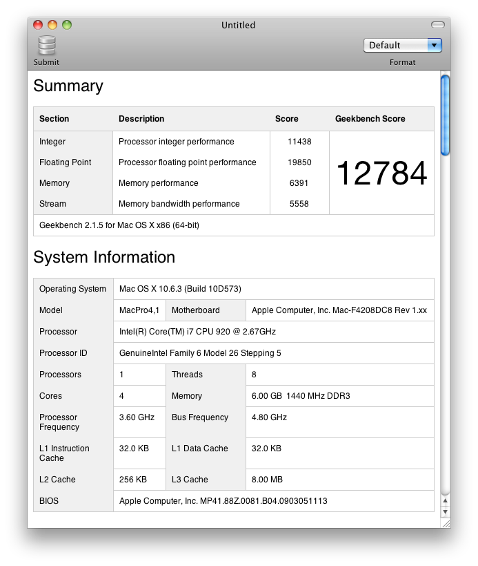

ErmaC Posted May 4, 2010 Share Posted May 4, 2010 All below using MacPro4,1 model identifier and the respective FakeSMC plist mod: DSDT 3.14 with MacPro4_1.plist modified for SS: - Temp: 44 - kexstat: ... - MSR Tools: SS working, idling at 60% of total frequency. CPUPLimit loaded (0x0). - Geekbench: DSDT 3.21 with MacPro4_1.plist modified for SS: - Temp 44 - kexstat: ... - MSR Tools: SS working, idling at 60% of total frequency. CPUPLimit loaded (0x0). - Geekbench: ... DSDT 3.21 without MacPro4_1.plist modified for SS: - Temp: 44 - kexstat: ... - MSR Tools: SS not working. CPUPLimit not loaded. - Geekbench: ... Gracias Kari por las pruebas... a seguir tengo una buena novedad... THX Karineko for your tests... I find a important news... Fabio, Interesting findings: 1.When I inject Imac 11.1 with the new fakesmskext from Andy(or original from netkas, its the same rezult), with default sms version 1.70 (this is for fakesms from Andy=default value)or the appropriate for Imac11.1 = sms-piketon, after putting the SL 2-3 time to sleep and wake up, the other Hard disk is stocked and the SL just slows down(after that, I have to reboot and with DiskWarrior to rebuild the partition in the other HD) 2.Same happens when I inject Macpro 3.1 and appropriate SMSversion 1.25 =sms napa 3.My SL is stable only when injected as Macpro 4.1 and smc thurley The problems occurs after couple of sleeps and wake ups. Strange? Any Idea Also the temp are 2-3 C down as Macpro3.1 and the Nvidia fan speed is quiter Thx fc bayern too -------------------- NEWS: Apple release today this "Mac Pro Audio Update 1.1" -- > http://support.apple.com/kb/DL1042 About Mac Pro Audio Update 1.1 This update addresses an audio anomaly that some customers may hear coming from inside their Mac Pro computer when using FireWire audio devices. This update is for Mac Pro (Early 2009) computers running Mac OS X v10.6.3. No need for modding Macpro4.1.plist anymore. Apple released today a Macpro Audio Update 1.1 that replaces IoplatformPluginFamily.kext. The Macpro4.1 Plist has now PlimitDict 0 and StepDataDict. It doesnt have new AppleHDA.kext. So... Probably with this Update we can finally use MacPro4,1 setup w/o problem... ( vanilla Macpro4.1.plist ????) Onestly I don't Know... Tomorrow I do some test on this... People if someone try this please report if this work! Fabio EDIT : news here too... --> MacPro Audio Update = changes in CPU Powermanagement! Link to comment https://www.insanelymac.com/forum/topic/208724-guide-new-snow-leopard-retail-on-asus-p6t-deluxe-v1v2/page/29/#findComment-1461543 Share on other sites More sharing options...

KariNeko Posted May 6, 2010 Share Posted May 6, 2010 Wanted to add a new result to the previous ones, but this time with MacProAudioUpdate1.1 installed. DSDT 3.21 with new MacPro4_1.plist from MacProAudioUpdate1.1: - Temp: 44 - kexstat: Index Refs Address Size Wired Name (Version) <Linked Against> 1 63 0 0 0 com.apple.kpi.bsd (10.3.0) 2 4 0 0 0 com.apple.kpi.dsep (10.3.0) 3 89 0 0 0 com.apple.kpi.iokit (10.3.0) 4 94 0 0 0 com.apple.kpi.libkern (10.3.0) 5 76 0 0 0 com.apple.kpi.mach (10.3.0) 6 27 0 0 0 com.apple.kpi.private (10.3.0) 7 43 0 0 0 com.apple.kpi.unsupported (10.3.0) 8 10 0xffffff7f80600000 0x4000 0x4000 com.apple.iokit.IOACPIFamily (1.3.0) <7 6 4 3> 9 21 0xffffff7f80604000 0x12000 0x12000 com.apple.iokit.IOPCIFamily (2.6) <7 5 4 3> 10 1 0xffffff7f80616000 0x44000 0x44000 com.apple.driver.AppleACPIPlatform (1.3.2) <9 8 7 6 5 4 3> 11 0 0xffffff7f8065a000 0x2000 0x2000 com.superhai.driver.PlatformUUID (1.0.0) <4 3> 12 0 0xffffff7f8065c000 0x1c000 0x1c000 com.apple.driver.AppleIntelCPUPowerManagement (104.3.0) <7 6 5 4 3 1> 13 5 0xffffff7f80678000 0x1a000 0x1a000 com.apple.iokit.IOStorageFamily (1.6) <7 6 5 4 3 1> 14 0 0xffffff7f80692000 0x12000 0x12000 com.apple.driver.DiskImages (283) <13 7 6 5 4 3 1> 15 0 0xffffff7f806a4000 0x3000 0x3000 com.apple.driver.AppleIntelCPUPowerManagementClient (104.3.0) <7 6 5 4 3 1> 16 0 0xffffff7f806a7000 0x8000 0x8000 com.apple.nke.applicationfirewall (2.1.11) <7 6 5 4 3 1> 17 2 0xffffff7f806af000 0x3000 0x3000 com.apple.kext.AppleMatch (1.0.0d1) <4 1> 18 0 0xffffff7f806b2000 0x4000 0x4000 com.apple.security.quarantine (0) <17 7 6 5 4 2 1> 19 0 0xffffff7f806b6000 0x8000 0x8000 com.apple.security.sandbox (0) <17 7 6 5 4 2 1> 20 0 0xffffff7f806be000 0x3000 0x3000 com.apple.security.TMSafetyNet (6) <7 6 5 4 2 1> 21 0 0xffffff7f806c1000 0x3000 0x3000 com.apple.driver.AppleAPIC (1.4) <4 3> 22 0 0xffffff7f806c4000 0x4000 0x4000 com.apple.driver.AppleSMBIOS (1.5) <7 4 3> 23 0 0xffffff7f806c8000 0x6000 0x6000 com.apple.driver.AppleRTC (1.3.1) <8 5 4 3 1> 24 0 0xffffff7f806ce000 0x3000 0x3000 com.apple.driver.AppleHPET (1.5) <8 7 5 4 3> 25 6 0xffffff7f806d1000 0x42000 0x42000 com.apple.iokit.IOHIDFamily (1.6.2) <7 6 5 4 3 1> 26 0 0xffffff7f80713000 0x4000 0x4000 com.apple.driver.AppleACPIButtons (1.3.2) <25 10 8 7 6 5 4 3 1> 27 0 0xffffff7f80717000 0x4000 0x4000 org.netkas.fakesmc (2) <8 7 4 3> 28 11 0xffffff7f8071b000 0x35000 0x35000 com.apple.iokit.IOUSBFamily (3.9.6) <9 7 5 4 3 1> 29 0 0xffffff7f80750000 0x10000 0x10000 com.apple.driver.AppleUSBUHCI (3.9.6) <28 9 7 5 4 3 1> 30 3 0xffffff7f80760000 0x7000 0x7000 com.apple.iokit.IOAHCIFamily (2.0.3) <5 4 3 1> 31 0 0xffffff7f80767000 0x12000 0x12000 com.apple.driver.AppleAHCIPort (2.1.1) <30 9 5 4 3 1> 33 0 0xffffff7f8077b000 0x5000 0x5000 com.apple.AppleFSCompression.AppleFSCompressionTypeZlib (1.0.0d1) <6 4 3 2 1> 34 0 0xffffff7f80780000 0x16000 0x16000 com.apple.driver.AppleUSBEHCI (3.9.6) <28 9 7 5 4 3 1> 35 1 0xffffff7f80796000 0x3000 0x3000 com.apple.driver.AppleEFIRuntime (1.3.0) <7 5 4 3> 36 2 0xffffff7f80799000 0x4b000 0x4b000 com.apple.iokit.IOFireWireFamily (4.2.6) <5 4 3 1> 37 0 0xffffff7f807e4000 0x28000 0x28000 com.apple.driver.AppleFWOHCI (4.5.7) <36 9 7 6 5 4 3 1> 38 0 0xffffff7f8080c000 0x4000 0x4000 com.apple.BootCache (31) <7 6 5 4 3 1> 39 1 0xffffff7f80810000 0xf000 0xf000 com.apple.iokit.IOATAFamily (2.5.1) <5 4 3 1> 40 0 0xffffff7f8081f000 0x7000 0x7000 com.apple.driver.AppleVIAATA (1.0.2) <39 9 5 4 3> 41 0 0xffffff7f80826000 0x2000 0x2000 com.apple.iokit.IOUSBUserClient (3.9.6) <28 7 5 4 3 1> 42 0 0xffffff7f80828000 0x7000 0x7000 com.apple.driver.AppleEFINVRAM (1.3.0) <35 7 5 4 3> 43 0 0xffffff7f8082f000 0x44000 0x44000 at.obdev.nke.LittleSnitch (2.2.05) <7 5 4 3 1> 44 0 0xffffff7f80873000 0x11000 0x11000 com.apple.driver.AppleUSBHub (3.9.6) <28 5 4 3 1> 45 3 0xffffff7f80884000 0x19000 0x19000 com.apple.iokit.IOSCSIArchitectureModelFamily (2.6.2) <5 4 3 1> 46 0 0xffffff7f8089d000 0x9000 0x9000 com.apple.iokit.IOAHCISerialATAPI (1.2.3) <45 30 5 4 3 1> 47 0 0xffffff7f808a6000 0x15000 0x15000 com.apple.iokit.IOAHCIBlockStorage (1.6.1) <30 13 5 4 3 1> 48 0 0xffffff7f808bb000 0x3000 0x3000 com.apple.driver.XsanFilter (402.1) <13 5 4 3 1> 49 1 0xffffff7f808be000 0x4000 0x4000 com.apple.driver.AppleUSBComposite (3.9.0) <28 4 3 1> 50 0 0xffffff7f808c2000 0x5000 0x5000 com.apple.driver.AppleUSBMergeNub (3.9.6) <49 28 4 3 1> 51 0 0xffffff7f808c7000 0xc000 0xc000 com.apple.iokit.IOUSBMassStorageClass (2.6.1) <45 28 13 5 4 3 1> 53 0 0xffffff7f808d5000 0x10000 0x10000 com.apple.iokit.IOSCSIBlockCommandsDevice (2.6.2) <45 13 5 4 3 1> 55 1 0xffffff7f808ec000 0x2000 0x2000 com.apple.driver.AppleHIDKeyboard (1.2.0a3) <25 4 3> 56 2 0xffffff7f808ee000 0x6000 0x6000 com.apple.iokit.IOUSBHIDDriver (3.9.6) <28 25 5 4 3 1> 57 0 0xffffff7f808f4000 0x2000 0x2000 com.apple.driver.AppleUSBHIDKeyboard (1.2.0a3) <56 55 25 4 3> 58 2 0xffffff7f808f6000 0x42000 0x42000 com.apple.iokit.IOBluetoothFamily (2.3.1f4) <7 5 4 3 1> 59 0 0xffffff7f80938000 0xb000 0xb000 com.apple.driver.AppleUSBBluetoothHCIController (2.3.1f4) <58 28 7 5 4 3> 61 2 0xffffff7f80947000 0x8000 0x8000 com.apple.iokit.IOHDAFamily (9.9.9) <5 4 3 1> 62 7 0xffffff7f8094f000 0x26000 0x26000 com.apple.iokit.IOGraphicsFamily (2.1) <9 7 5 4 3> 63 1 0xffffff7f80975000 0x14000 0x14000 com.apple.driver.AppleHDAController (9.9.9) <62 61 9 5 4 3 1> 64 3 0xffffff7f80989000 0x1a000 0x1a000 com.apple.iokit.IONetworkingFamily (1.9) <7 6 5 4 3 1> 65 0 0xffffff7f809a3000 0x2d000 0x2d000 com.apple.iokit.AppleYukon2 (3.1.14b1) <64 9 5 4 3 1> 66 0 0xffffff7f809d0000 0x3000 0x3000 com.apple.driver.AppleLPC (1.4.11) <9 5 4 3> 67 0 0xffffff7f809d3000 0x2000 0x2000 com.apple.driver.AppleSMBusPCI (1.0.8d0) <9 5 4 3> 68 2 0xffffff7f809d5000 0xc000 0xc000 com.apple.driver.IOPlatformPluginFamily (4.1.1d0) <6 5 4 3> 69 2 0xffffff7f809e1000 0xb000 0xb000 com.apple.driver.AppleSMC (3.0.1d2) <8 7 5 4 3> 70 0 0xffffff7f809ec000 0x11000 0x11000 com.apple.driver.ACPI_SMC_PlatformPlugin (4.1.1d0) <69 68 9 8 7 6 5 4 3> 71 7 0xffffff7f809fd000 0x34000 0x34000 com.apple.iokit.AppleProfileFamily (41) <9 7 6 5 4 3 1> 73 0 0xffffff7f80a39000 0x9000 0x9000 com.apple.iokit.IOFireWireIP (2.0.3) <64 36 5 4 3 1> 74 3 0xffffff7f80a42000 0xe000 0xe000 com.apple.iokit.IONDRVSupport (2.1) <62 9 7 5 4 3> 75 2 0xffffff7f80a50000 0x2ba000 0x2ba000 com.apple.NVDAResman (6.1.0) <74 62 9 5 4 3 1> 76 0 0xffffff7f80d0a000 0x40d000 0x40d000 com.apple.nvidia.nv50hal (6.1.0) <75 4 3> 77 0 0xffffff7f81117000 0x8000 0x8000 jp.plentycom.driver.SteerMouse (4.0.1) <56 28 25 5 4 3 1> 78 2 0xffffff7f8111f000 0x5000 0x5000 com.apple.kext.OSvKernDSPLib (1.3) <5 4> 79 4 0xffffff7f81124000 0x1b000 0x1b000 com.apple.iokit.IOAudioFamily (1.7.6fc2) <78 5 4 3 1> 80 1 0xffffff7f8113f000 0x7c000 0x7c000 com.apple.driver.DspFuncLib (9.9.9) <79 78 5 4 3 1> 81 0 0xffffff7f811bb000 0xb3000 0xb3000 com.apple.driver.AppleHDA (9.9.9) <80 79 74 63 62 61 5 4 3 1> 82 1 0xffffff7f8126e000 0x2000 0x2000 com.apple.iokit.IOSMBusFamily (1.1) <5 4 3> 83 0 0xffffff7f81270000 0xb000 0xb000 com.apple.driver.AppleSMBusController (1.0.8d0) <82 9 8 5 4 3> 84 0 0xffffff7f8127b000 0x4000 0x4000 com.apple.driver.AudioIPCDriver (1.1.2) <79 5 4 3 1> 85 0 0xffffff7f8127f000 0x8000 0x8000 com.apple.driver.AppleIntelNehalemProfile (11) <71 6 4 3> 86 0 0xffffff7f81287000 0xb5000 0xb5000 com.apple.GeForce (6.1.0) <75 74 62 9 7 6 5 4 3 1> 87 0 0xffffff7f8133c000 0x6000 0x6000 com.apple.driver.IOBluetoothBNEPDriver (2.3.1f4) <64 58 7 5 4 3 1> 89 0 0xffffff7f81344000 0x5000 0x5000 com.apple.Dont_Steal_Mac_OS_X (7.0.0) <69 7 4 3 1> 91 0 0xffffff7f81351000 0x5000 0x5000 com.apple.driver.AppleUpstreamUserClient (3.3.2) <62 9 8 7 5 4 3 1> 93 1 0xffffff7f81358000 0xa000 0xa000 com.apple.iokit.IOSerialFamily (10.0.3) <7 6 5 4 3 1> 94 0 0xffffff7f81362000 0xa000 0xa000 com.apple.iokit.IOBluetoothSerialManager (2.3.1f4) <93 7 5 4 3 1> 95 0 0xffffff7f8136c000 0xc000 0xc000 com.apple.iokit.IOSurface (74.0) <7 5 4 3 1> 96 0 0xffffff7f81378000 0x6000 0x6000 com.Cycling74.driver.Soundflower (1.4.4) <79 5 4 3> 97 0 0xffffff7f8137e000 0x3000 0x3000 com.apple.driver.AppleProfileCallstackAction (20) <71 5 4 3 1> 99 0 0xffffff7f81386000 0x2000 0x2000 com.apple.driver.AppleProfileKEventAction (10) <71 4 3 1> 100 0 0xffffff7f81388000 0xa000 0xa000 com.apple.driver.AGPM (100.10.21) <62 9 5 4 3> 101 0 0xffffff7f81392000 0x9000 0x9000 com.apple.driver.AppleTyMCEDriver (1.0.1d8) <68 9 8 7 6 5 4 3 1> 102 0 0xffffff7f8139b000 0x2000 0x2000 com.apple.driver.AppleProfileRegisterStateAction (10) <71 4 3 1> 103 0 0xffffff7f8139d000 0x2000 0x2000 com.apple.driver.AppleProfileThreadInfoAction (14) <71 6 4 3 1> 104 0 0xffffff7f8139f000 0x2000 0x2000 com.apple.driver.AppleProfileTimestampAction (10) <71 5 4 3 1> 105 0 0xffffff7f813a1000 0x3000 0x3000 com.apple.driver.AppleProfileReadCounterAction (17) <71 6 4 3> 106 0 0xffffff7f813a4000 0xa000 0xa000 com.apple.filesystems.autofs (2.1.0) <7 6 5 4 3 1> 107 0 0xffffff7f813ae000 0xe000 0xe000 com.taoeffect.ispy.kext (2.0.1) <5 4 3 1> 108 0 0xffffff7f813bc000 0x5000 0x5000 com.apple.driver.AppleHWSensor (1.9.3d0) <5 4 3> 109 0 0xffffff7f813c1000 0x3000 0x3000 com.regularrateandrhythm.driver.RowmoteIREmu (1.0) <28 25 5 4 3> 110 0 0xffffff7f813c4000 0x32000 0x32000 com.apple.filesystems.smbfs (1.6.1) <7 6 5 4 3 1> - MSR Tools: SS working. CPUPLimit loaded (0x0). Link to comment https://www.insanelymac.com/forum/topic/208724-guide-new-snow-leopard-retail-on-asus-p6t-deluxe-v1v2/page/29/#findComment-1462517 Share on other sites More sharing options...
