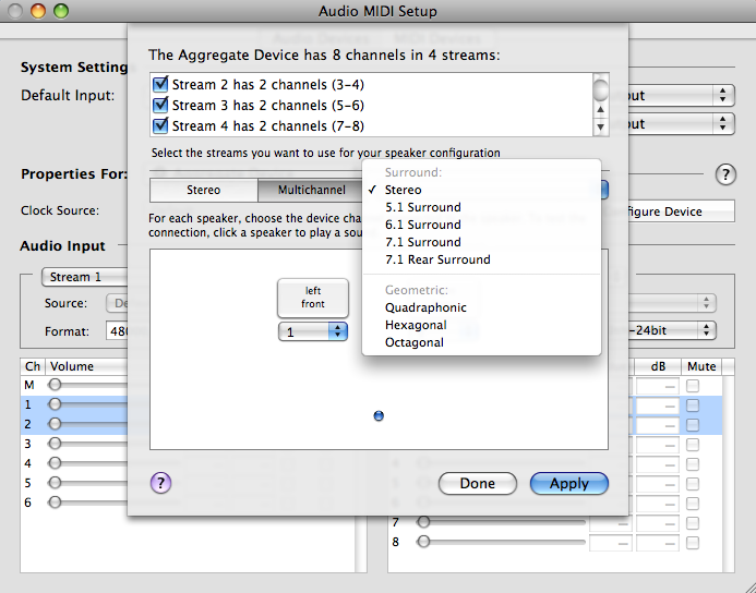

ANARCHiNTOSH Posted February 24, 2010 Share Posted February 24, 2010 You're welcome.The eject buttons don't have to be seen, but the fix changes the chipset name from ICH10 to ESB2, and may cause drive problems (see post 392). The patcher looks interesting, I'll check it out when I get some time. With the ALC889a.kext one can get 5.1 by using the digital out. thanks, i didnt know that about the drives... this method should also enable digital out and i think it is superior to both ALC889a.kext and LegacyHDA+HDAEnabler, but it will break every time apple updates these plugins for AppleHDA.kext: AppleHDAHardwareConfigDriver.kext AppleHDAPlatformDriver.kext i made the patcher so its really easy to repatch them after an update. i personally dont have a 5.1 Amp, they are all individual hifi amps cobbled together, and it would cost over £100 to upgrade to one --- so for me its much cheaper to hack. Link to comment https://www.insanelymac.com/forum/topic/196771-ga-ex58-and-ga-x58a-dsdt-native-power-management-modifications/page/21/#findComment-1416850 Share on other sites More sharing options...

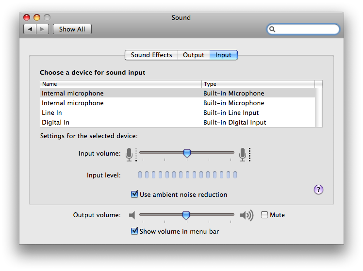

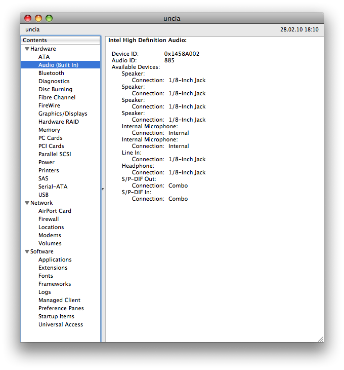

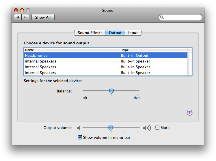

x.di Posted February 28, 2010 Share Posted February 28, 2010 I've made a better LegacyHDA.kext for 889a sound. No assertions, every port work but no "Digital Out" - AppleHda just can't handle so much ports. You will have working : Front HDA Mic Front HDA Headphone (swapped with Green Line Out) --- Back Mic Back Line In Back Digital In Back Line Out (4 ports) In DSDT you must enter this lines : Device (HDEF) { Name (_ADR, 0x001B0000) Method (_PRW, 0, NotSerialized) { Return (Package (0x02) { 0x0D, 0x03 }) } Method (_DSM, 4, NotSerialized) { Store (Package (0x06) { "built-in", Buffer (One) { 0x01 }, "layout-id", Buffer (0x04) { 0x75, 0x03, 0x00, 0x00 }, "PinConfigurations", Buffer (Zero) {} }, Local0) DTGP (Arg0, Arg1, Arg2, Arg3, RefOf (Local0)) Return (Local0) } } add LegacyHDA.kext in your /Extra/Extensions/ folder The advantages of my LegacyHDA.kext that you will have "Ambient noise reduction" for MICs and on ALL Line OUTs you will have CLEAR Sound with BASSES unlike other kexts that give you really bad sound without basses on lineouts... The trick was to change in "pinconfig" all LineOuts to "Speaker"... LegacyHDA.kext.zip Link to comment https://www.insanelymac.com/forum/topic/196771-ga-ex58-and-ga-x58a-dsdt-native-power-management-modifications/page/21/#findComment-1419945 Share on other sites More sharing options...
ANARCHiNTOSH Posted February 28, 2010 Share Posted February 28, 2010 I've made a better LegacyHDA.kext for 889a sound.No assertions, every port work but no "Digital Out" - AppleHda just can't handle so much ports. That sounds really good (no pun intended)! So you could get analog 7.1 surround using that kext.... Have you had a look at this method for 5.1 Analog & Digital: http://www.infinitemac.com/f57/guide-alc88...surround-t3746/ its what i wrote my patcher for. id like to do a comparison when i get the time.... also, could you explain to me what LegacyHDA actually is? ive used it before, i just was wondering if its a tweaked AppleHDA thats been renamed.... @goblin gangstah why do people buy AMD for hackintoshes? it really confuses me. you will find it really hard to get a stable system. plus, 10 euros or a COD2 cd-key is the worst incentive ive ever heard. Link to comment https://www.insanelymac.com/forum/topic/196771-ga-ex58-and-ga-x58a-dsdt-native-power-management-modifications/page/21/#findComment-1420031 Share on other sites More sharing options...
