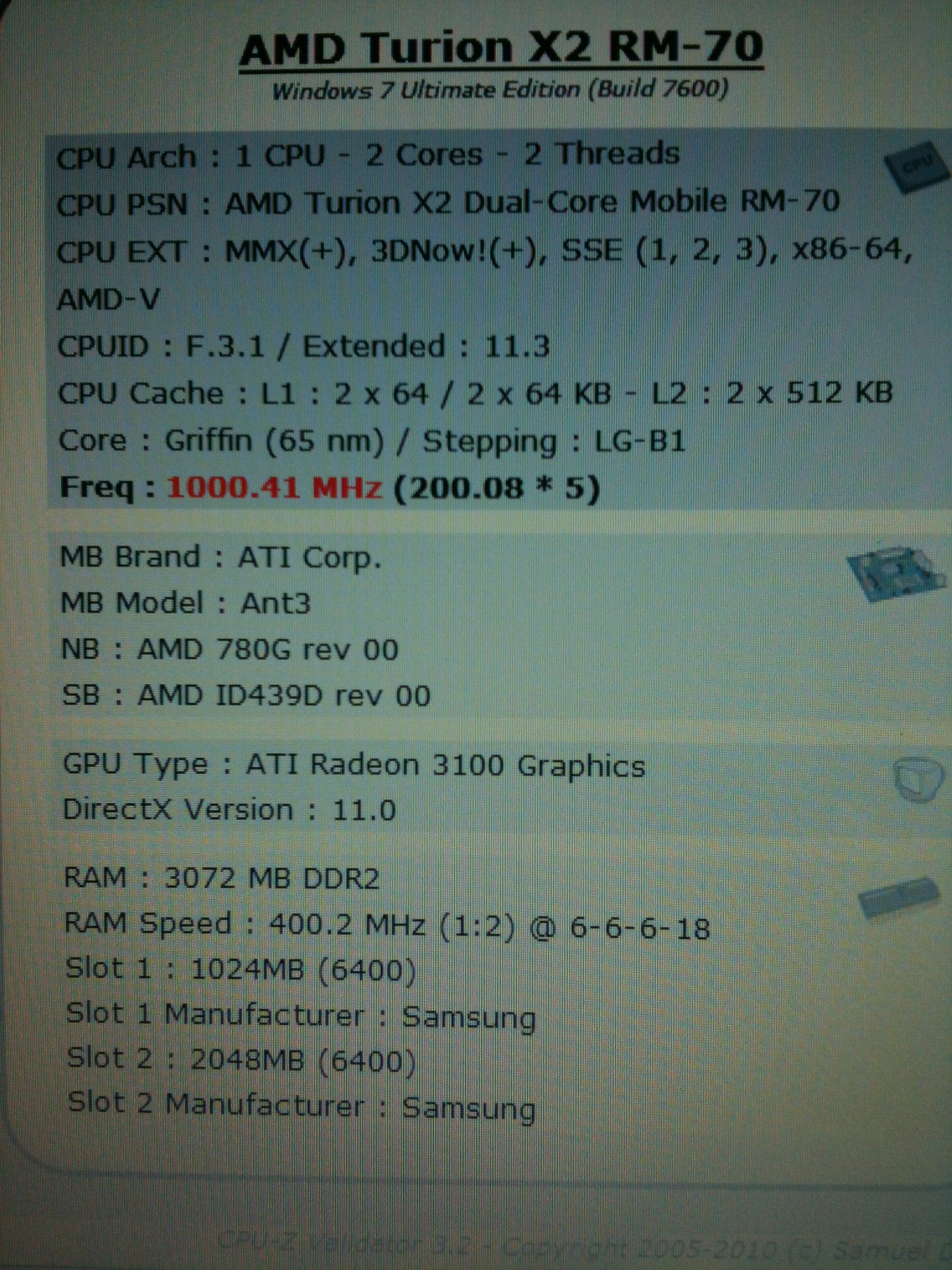

Anyone help me? which kind of mac OSX is suitable for my notebook. I tried to almost 6 Mac operating systems. But it says kernel panic. Maybe i out of luck. Haha
My labtop's information:
Cpu: AMD TURION x2 RM-70
Memory: 3072mb DDR2
Motherboard's model:Ant3, AMD 780G chipset,
Graphics: ATI RADEON 3100 graphic
I really want to install Mac OSX
Please anyone help me?

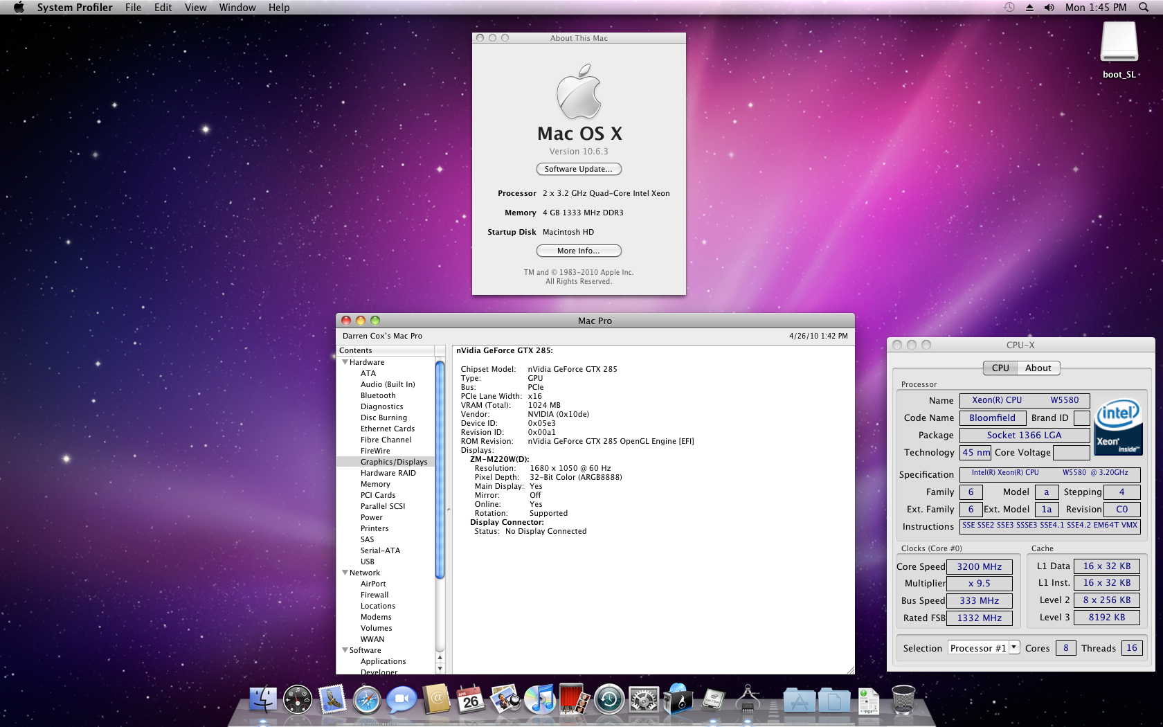

HI guys,
I have finally managed to get my Dual Xeon running 10.6.3 perfectly..
8 cores and 16 simultaneous Threads.. is awesome
Running 2 x W5580 Xeons on a Supermicro X8DAi Mobo.
Both Lan work and were both automatically recognized by SL.
I installed my PC EFI 10.6 to a small USB stick with the necessery Kexts that way my Installation is Pure Vanilla.
I only installed one Kext to HDD (Audio) even the NVEnablers for my GTX285 (was a pain in the A**) are on the usb Stick. Screen shot as proof attached.
I can warmly recommend these Supermicro Boards, no hassle works great.
Hmm, so now this is done I need a new project :D
