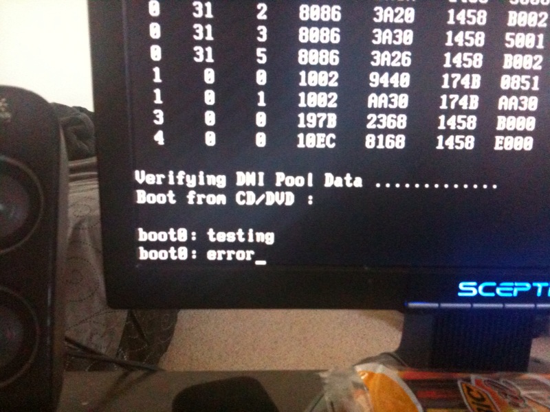

iTravis Posted January 16, 2010 Share Posted January 16, 2010 Hi, I just built a PC from my spare parts and I follow the guide here but I couldn't get the CD or DVD to boot. This is the error I got: I read through the entire thread and tried every possible ways but still no luck. Here's the specs of my rig: E7400 Gigabyte EP45-UD3L 2x1GB Corsair DDR2 Seagate 500GB HD SATA DVD Burner XFX 8800GT 512MB Anybody have suggestions? Link to comment https://www.insanelymac.com/forum/topic/187906-ga-ep45-ud3l-snow-leopard-install-guide-v10-for-newbies/page/11/#findComment-1386639 Share on other sites More sharing options...
breakingbad Posted January 16, 2010 Share Posted January 16, 2010 Do you know of a RTL8111C kext driver?? Not just the 8169 kext in the IONetWorkingFamily.kext In fact, I had to do nothing to get my RTL8111C to work. Just plugged the cable into it and that's it. Done. No config or extra kexts needed. Maybe you need to do some changes to your DSDT. Sometimes it's all about DSDT modding. Cheers. bb. P.S. - Can post my DSDT for you to try with your system. Hi,I just built a PC from my spare parts and I follow the guide here but I couldn't get the CD or DVD to boot. This is the error I got: I read through the entire thread and tried every possible ways but still no luck. Here's the specs of my rig: E7400 Gigabyte EP45-UD3L 2x1GB Corsair DDR2 Seagate 500GB HD SATA DVD Burner XFX 8800GT 512MB Anybody have suggestions? What's the connection interface of your HD? Sata or IDE? Have you checked all the BIOS settings to see if they're exactly as asked in first post? In the screen you posted, seems like your AHCI is not setted right and it's having problem to start it. Check this option. Cheers. bb. Link to comment https://www.insanelymac.com/forum/topic/187906-ga-ep45-ud3l-snow-leopard-install-guide-v10-for-newbies/page/11/#findComment-1386858 Share on other sites More sharing options...
iTravis Posted January 16, 2010 Share Posted January 16, 2010 Hi breakingbad, Thanks for the reply. My HD interface is SATA and as I mention above, I did go through everything that posted in this thread including the BIOS setting on the first page since I know it's important and if I don't set to AHCI then I won't be able to use Mac OS. And you're right, it seems I have problem with AHCI since it didn't even go to the boot process, just stuck at that screen there. When I put the SATA cable for my DVD burner on the 1st SATA port of my motherboard, it recognizes as port 00 but when I swap with the SATA cable for my HD then it won't show up anything as you can see my screenshot. So my thought is that I might have a faulty HD or it just doesn't see the HD for some reasons. But it's weird since the BIOS can recognize both my DVD and HD. This is just confusing, I might swap it with a another HD and see what's going on but I really need suggestions of what to do here. Link to comment https://www.insanelymac.com/forum/topic/187906-ga-ep45-ud3l-snow-leopard-install-guide-v10-for-newbies/page/11/#findComment-1387069 Share on other sites More sharing options...
breakingbad Posted January 16, 2010 Share Posted January 16, 2010 Hi breakingbad,Thanks for the reply. My HD interface is SATA and as I mention above, I did go through everything that posted in this thread including the BIOS setting on the first page since I know it's important and if I don't set to AHCI then I won't be able to use Mac OS. And you're right, it seems I have problem with AHCI since it didn't even go to the boot process, just stuck at that screen there. When I put the SATA cable for my DVD burner on the 1st SATA port of my motherboard, it recognizes as port 00 but when I swap with the SATA cable for my HD then it won't show up anything as you can see my screenshot. So my thought is that I might have a faulty HD or it just doesn't see the HD for some reasons. But it's weird since the BIOS can recognize both my DVD and HD. This is just confusing, I might swap it with a another HD and see what's going on but I really need suggestions of what to do here. Well, here in my BIOS I have in Integrated Peripherals under SATA Port 0-3 Native Mode set do Disabled and everything loads fine. To check if you have a faulty DVD or HDD, you should connect each one separetely and try to boot to see what you get. You can even try to plug DVD into the first SATA port and HDD to another one. Is SL already installed to your HDD or are you still trying to install it? That's important too... Another point... what is your BIOS version? Are you using version F7 from Gigabyte? Cheers. bb. Link to comment https://www.insanelymac.com/forum/topic/187906-ga-ep45-ud3l-snow-leopard-install-guide-v10-for-newbies/page/11/#findComment-1387113 Share on other sites More sharing options...
iTravis Posted January 17, 2010 Share Posted January 17, 2010 Well, here in my BIOS I have in Integrated Peripherals under SATA Port 0-3 Native Mode set do Disabled and everything loads fine.To check if you have a faulty DVD or HDD, you should connect each one separetely and try to boot to see what you get. You can even try to plug DVD into the first SATA port and HDD to another one. Is SL already installed to your HDD or are you still trying to install it? That's important too... Another point... what is your BIOS version? Are you using version F7 from Gigabyte? Cheers. bb. That's what I did, I mean I did plug the SATA cable for the DVD to the 1st SATA port and it does recognize right after that Controller Bus #00......as port 00 - "The name of my DVD burner" but if I plug the SATA cable of the HD to the 1st port then it doesn't recognize so I assume there's something wrong with my HD. By the way I started from scratch so I don't have anything in my HD yet. And I use F7 BIOS. Link to comment https://www.insanelymac.com/forum/topic/187906-ga-ep45-ud3l-snow-leopard-install-guide-v10-for-newbies/page/11/#findComment-1387150 Share on other sites More sharing options...

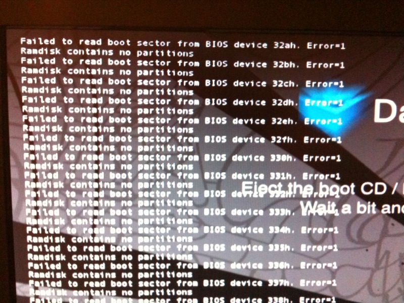

iTravis Posted January 17, 2010 Share Posted January 17, 2010 Well, after the installation process, did you copied the boot file and the Extra/Extensions folder to the root of your system install? Did you installed the Chameleon 2 RC3 to the system? It's necessary to do it so you can boot without the CD/DVD. Cheers. bb. I tried both the CD and DVD boot but couldn't get it working as I got the eBIOS error, so now I'm using the USB method and use it as a Snow Leopard boot disk. I did copy the Extra folder along with Chameleon 2 RC2 into the thumb drive. These are the errors: Error: Uncompressed file is not the length recorded. Error: couldn't uncompress plist file from multikext archive entry 0. Link to comment https://www.insanelymac.com/forum/topic/187906-ga-ep45-ud3l-snow-leopard-install-guide-v10-for-newbies/page/11/#findComment-1387209 Share on other sites More sharing options...
breakingbad Posted January 17, 2010 Share Posted January 17, 2010 I tried both the CD and DVD boot but couldn't get it working as I got the eBIOS error, so now I'm using the USB method and use it as a Snow Leopard boot disk. I did copy the Extra folder along with Chameleon 2 RC2 into the thumb drive. These are the errors:Error: Uncompressed file is not the length recorded. Error: couldn't uncompress plist file from multikext archive entry 0. Huum... did you created the whole process of restoring the Snow Leopard to the flash drive? The eBIOS error happens when you record a boot DVD into a CD media, but in most cases after all the errors, it starts loading the system disk normally. I installed my system this way. Are you using the Boot disk provided by Gurujee or the one provided by verdant? I would use the verdant's one. Many people complained about the Gurujee file unfortunatelly. You can find the boot DVD provided by verdant in the forum. Don't remember which page. Just take a look around page between 8 and 12... don't know for sure... I'll check and post it right here. EDIT - Boot DVD disk Download this file here - Record it into a DVD or DVD-RW disk as slow as you can; - Boot with this disk. When it starts, eject the media, insert SL install disk and press F5. Instructions are already on screen; - Boot using flags -v -f arch=i386 EDIT 2 - Bootloader Sorry, forgot to mention. Don't use Chameleon 2 RC2. Use Chameleon 2 RC3 with PC_EFI 10.5 version that you can find googling for netkas site. Cheers. bb. Link to comment https://www.insanelymac.com/forum/topic/187906-ga-ep45-ud3l-snow-leopard-install-guide-v10-for-newbies/page/11/#findComment-1387217 Share on other sites More sharing options...
iTravis Posted January 17, 2010 Share Posted January 17, 2010 Huum... did you created the whole process of restoring the Snow Leopard to the flash drive? The eBIOS error happens when you record a boot DVD into a CD media, but in most cases after all the errors, it starts loading the system disk normally. I installed my system this way. Are you using the Boot disk provided by Gurujee or the one provided by verdant? I would use the verdant's one. Many people complained about the Gurujee file unfortunatelly. You can find the boot DVD provided by verdant in the forum. Don't remember which page. Just take a look around page between 8 and 12... don't know for sure... I'll check and post it right here. EDIT - Boot DVD disk Download this file here - Record it into a DVD or DVD-RW disk as slow as you can; - Boot with this disk. When it starts, eject the media, insert SL install disk and press F5. Instructions are already on screen; - Boot using flags -v -f arch=i386 EDIT 2 - Bootloader Sorry, forgot to mention. Don't use Chameleon 2 RC2. Use Chameleon 2 RC3 with PC_EFI 10.5 version that you can find googling for netkas site. Cheers. bb. Thank you so much breakingbad, I'm writing this on my new Hackintosh now (happy dancing). So after I install Chameleon bootloader, I no longer need the boot DVD but I still have to type -v -f arch=i386 in order for it to boot into Mac OS? Is there a way that I can boot it straight from my HD without entering any command line? I somehow manage to get it working with my native resolution by editing the .com.Apple.boot.plist file so I think I'm good with that for now. I still can't get the sound working though but after browsing through the thread again, I saw you posted a solution without using the Voodoo one so I might give it a try and report back. I also downloaded the 10.6.2 update and I guess I'll be fine if I just delete 2 files like you said and replace with the SleepEnabler from netkas? I have another question, is it just me or when I use Snow Leopard it's kinda...not really sluggish performance but I still feel like it's not as smooth as...let's say Windows or compare to when I use my Macbook. Are my E7400 and 2GB RAM enough to handle or I would benefit more if I upgrade to a Quad with 4GB RAM? Regards! Link to comment https://www.insanelymac.com/forum/topic/187906-ga-ep45-ud3l-snow-leopard-install-guide-v10-for-newbies/page/11/#findComment-1387242 Share on other sites More sharing options...
breakingbad Posted January 17, 2010 Share Posted January 17, 2010 Thank you so much breakingbad, I'm writing this on my new Hackintosh now (happy dancing). So after I install Chameleon bootloader, I no longer need the boot DVD but I still have to type -v -f arch=i386 in order for it to boot into Mac OS? Is there a way that I can boot it straight from my HD without entering any command line?I somehow manage to get it working with my native resolution by editing the .com.Apple.boot.plist file so I think I'm good with that for now. I still can't get the sound working though but after browsing through the thread again, I saw you posted a solution without using the Voodoo one so I might give it a try and report back. I also downloaded the 10.6.2 update and I guess I'll be fine if I just delete 2 files like you said and replace with the SleepEnabler from netkas? I have another question, is it just me or when I use Snow Leopard it's kinda...not really sluggish performance but I still feel like it's not as smooth as...let's say Windows or compare to when I use my Macbook. Are my E7400 and 2GB RAM enough to handle or I would benefit more if I upgrade to a Quad with 4GB RAM? Regards! After installing the Chameleon Bootloader to the HDD where you installed system you won't need the Boot CD anymore. Be sure to place the boot file into the root. As it's a hidden file, you can fire up Terminal and type: defaults write com.apple.finder AppleShowAllFiles TRUE killall Finder After that, open Finder and look for the boot file in root. If it's present, you won't need the cd anymore. You can boot directly from your HDD. To hide files again type in Terminal. defaults write com.apple.finder AppleShowAllFiles FALSE killall Finder Remember that you need to have Extra/Extensions folder in the root too and all the files that is mentioned in first post. About the performance, I don't really now if you're facing problems. I'll try to start my system here with 2 cores and 2 Gb of RAM and see if system behaves different. I believe it won't slow down performance. I'm happy you're able to use your hackintosh. EDIT - Performance Issue Hi mate. As mentioned above, started my system using 2 cores of my CPU and 2 GB RAM and performance was quite the same as using full capacity. My suggestion is do all the updates needed and them check performance to see if it's really slow. Cheers. bb. Link to comment https://www.insanelymac.com/forum/topic/187906-ga-ep45-ud3l-snow-leopard-install-guide-v10-for-newbies/page/11/#findComment-1387544 Share on other sites More sharing options...
