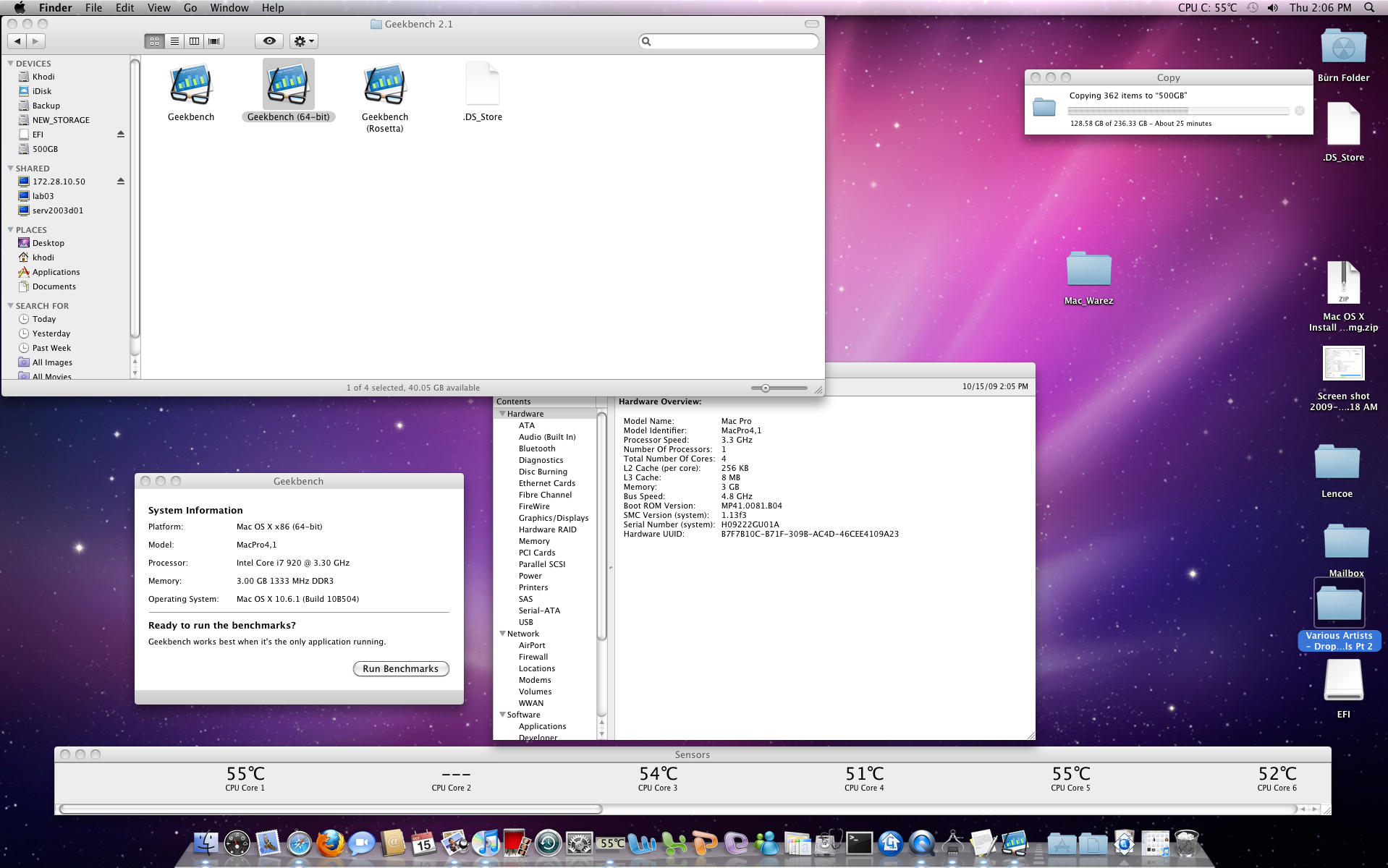

Khodi Posted October 15, 2009 Share Posted October 15, 2009 Thanks Ryan for everything Here is my new geekbench results Geekbench reults Link to comment Share on other sites More sharing options...
bamf Posted October 15, 2009 Share Posted October 15, 2009 Thanks Ryan for everything Here is my new geekbench results Geekbench reults Nice Geekbench score. I've got you beaten by just a tad, and I'm running at 3.6Ghz instead of 4.0. If you want Geekbench to show the correct processor speed, then you can update the smbios.plist file (inside the Extra folder) on your EFI magic stick. You do this by opening it in TextEditor and looking for the following key(s): <key>SMmaximalclock</key> <string>3600</string> Change the 3600 to 4000 for you (and then reboot of course) and it will display the speed properly. You can also look in the file and change your memory speed if you want to (among other things)... Link to comment Share on other sites More sharing options...

Khodi Posted October 16, 2009 Share Posted October 16, 2009 Nice Geekbench score. I've got you beaten by just a tad, and I'm running at 3.6Ghz instead of 4.0. If you want Geekbench to show the correct processor speed, then you can update the smbios.plist file (inside the Extra folder) on your EFI magic stick. You do this by opening it in TextEditor and looking for the following key(s): <key>SMmaximalclock</key> <string>3600</string> Change the 3600 to 4000 for you (and then reboot of course) and it will display the speed properly. You can also look in the file and change your memory speed if you want to (among other things)... Its worked for me , thanks Geekbench Link to comment Share on other sites More sharing options...
