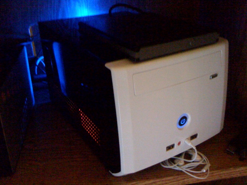

Yoni Yoni Posted February 20, 2010 Share Posted February 20, 2010 OK I finally got the K45 motherboard inside this case. I could barely fit the power supply in there... This hackintosh looks a lot sexier now... Link to comment https://www.insanelymac.com/forum/topic/185123-%EF%A3%BF-quick-guide-shuttle-k45k48-running-snow-leopard/page/9/#findComment-1413829 Share on other sites More sharing options...
Squirrelf Posted February 20, 2010 Author Share Posted February 20, 2010 cool looking Link to comment https://www.insanelymac.com/forum/topic/185123-%EF%A3%BF-quick-guide-shuttle-k45k48-running-snow-leopard/page/9/#findComment-1413831 Share on other sites More sharing options...
