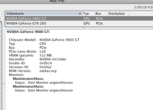

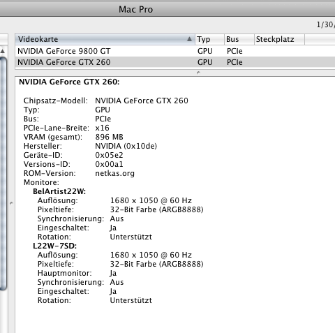

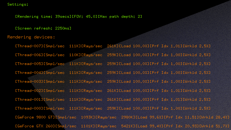

pcace Posted January 30, 2010 Share Posted January 30, 2010 PS.: Next Question: Right now i use a nVidia 9800GT in my hackintosh. I'm thinking about adding a 260GTX to have one more openCL capable device. Is it possible to have both parallel working? would it improve renderingspped, when using openCL renderer? Hey, i did it right now! And its rendering like a charme!! (openCL). I Followed this Tutorial: http://www.insanelymac.com/forum/index.php?showtopic=183349 Pcace Link to comment https://www.insanelymac.com/forum/topic/185097-guide-scripted-yosemitemavericks-install-on-gigabyte-mobos/page/78/#findComment-1399716 Share on other sites More sharing options...
LocusOfControl Posted January 30, 2010 Share Posted January 30, 2010 Hey, i did it right now! And its rendering like a charme!! (openCL). I Followed this Tutorial: http://www.insanelymac.com/forum/index.php?showtopic=183349 Pcace So the obvious question is how did your performance improve eg as measured by open gl viewer? Link to comment https://www.insanelymac.com/forum/topic/185097-guide-scripted-yosemitemavericks-install-on-gigabyte-mobos/page/78/#findComment-1399746 Share on other sites More sharing options...

pcace Posted January 31, 2010 Share Posted January 31, 2010 So the obvious question is how did your performance improve eg as measured by open gl viewer? Hmm, the OpenGL performance is only slightly better then before. (but only because i use the 260GTX instead of the 9800GT as the primary card i think). BUT like i said the openCL Performance increased a lot - see sceenshots... 10716K Rays/Sec..... Pcace Link to comment https://www.insanelymac.com/forum/topic/185097-guide-scripted-yosemitemavericks-install-on-gigabyte-mobos/page/78/#findComment-1400508 Share on other sites More sharing options...
LocusOfControl Posted January 31, 2010 Share Posted January 31, 2010 Hmm, the OpenGL performance is only slightly better then before. (but only because i use the 260GTX instead of the 9800GT as the primary card i think). BUT like i said the openCL Performance increased a lot - see sceenshots... 10716K Rays/Sec..... Pcace I haven't seen that prog before, what are you using for your test ? Link to comment https://www.insanelymac.com/forum/topic/185097-guide-scripted-yosemitemavericks-install-on-gigabyte-mobos/page/78/#findComment-1400544 Share on other sites More sharing options...
pcace Posted January 31, 2010 Share Posted January 31, 2010 I haven't seen that prog before, what are you using for your test ? This is an early early buggy development version of a small Luxrender version with openCL support! A milestone in opensource renderers... --> luxrender.net or: http://www.luxrender.net/wiki/index.php?ti...nder_and_OpenCL "CPU Vs GPU ? No, thanks, CPU + GPU + Network rendering is better"..... pcace Link to comment https://www.insanelymac.com/forum/topic/185097-guide-scripted-yosemitemavericks-install-on-gigabyte-mobos/page/78/#findComment-1400637 Share on other sites More sharing options...
