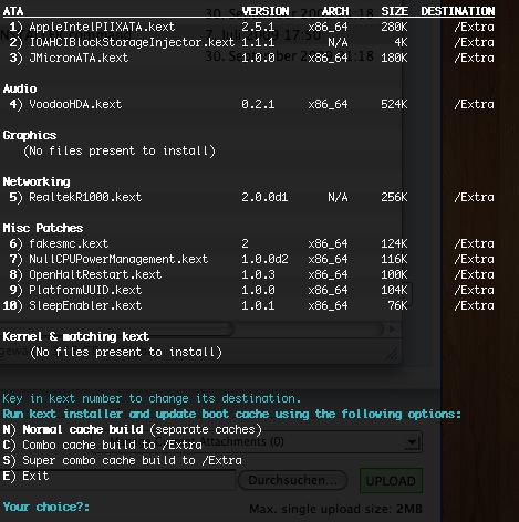

AppleIIGuy Posted January 21, 2010 Share Posted January 21, 2010 Hey AppleGuy.Yeah I went out on sunday and bought a SATA->USB docking stand for the HD and did just that. Although I don't know if I the AppleRTC.kext is being used. How can I make sure it is used? Also, from what you said, I assume once it is booted I then put the script on thumb drive along with all the other files and then run the DSDT portion? Cheers! Make sure the AppleRTC.kext is in the /extra/Stored_Kexts then run the script and rebuild caches on the drive. The AppleRTC keeps your cmos being from being reset after the DSDT is built you can delete the AppleRTC.kext and rebuild caches again. Link to comment https://www.insanelymac.com/forum/topic/185097-guide-scripted-yosemitemavericks-install-on-gigabyte-mobos/page/75/#findComment-1392200 Share on other sites More sharing options...
Dalgar Posted January 21, 2010 Share Posted January 21, 2010 Thanks. I will do that. How do I get to the single-user -s so I can build the cache? I was stuck at that stage because everytime I select SINGLE USER from the boot menu I was launched into booting. I can't seem to get to a prompt the let me initiate a boot with parameters. I selected the PC EFI boot loader when I made the drive. Cheers and thanks for all the time you are taking to answer my questions. Link to comment https://www.insanelymac.com/forum/topic/185097-guide-scripted-yosemitemavericks-install-on-gigabyte-mobos/page/75/#findComment-1392210 Share on other sites More sharing options...

AppleIIGuy Posted January 22, 2010 Share Posted January 22, 2010 Thanks. I will do that. How do I get to the single-user -s so I can build the cache? I was stuck at that stage because everytime I select SINGLE USER from the boot menu I was launched into booting. I can't seem to get to a prompt the let me initiate a boot with parameters. I selected the PC EFI boot loader when I made the drive. Cheers and thanks for all the time you are taking to answer my questions. It doesn't show a boot menu? the other way would be to mount the drive in the mini and rebuild the cache from there. Link to comment https://www.insanelymac.com/forum/topic/185097-guide-scripted-yosemitemavericks-install-on-gigabyte-mobos/page/75/#findComment-1392300 Share on other sites More sharing options...

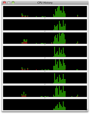

LocusOfControl Posted January 22, 2010 Share Posted January 22, 2010 2. The OS only seems to see 1 core. At least that what I think is happening. Activity monitor only shows one. iStat Menus and CPU-X only show one as well. Edit: I see this when the computer boots which makes me believe something is seeing all of the cores: 1/22/10 12:44:52 PM kernel AppleACPICPU: ProcessorId=0 LocalApicId=0 Enabled 1/22/10 12:44:52 PM kernel AppleACPICPU: ProcessorId=1 LocalApicId=2 Enabled 1/22/10 12:44:52 PM kernel AppleACPICPU: ProcessorId=2 LocalApicId=4 Enabled 1/22/10 12:44:52 PM kernel AppleACPICPU: ProcessorId=3 LocalApicId=6 Enabled 1/22/10 12:44:52 PM kernel AppleACPICPU: ProcessorId=4 LocalApicId=1 Enabled 1/22/10 12:44:52 PM kernel AppleACPICPU: ProcessorId=5 LocalApicId=3 Enabled 1/22/10 12:44:52 PM kernel AppleACPICPU: ProcessorId=6 LocalApicId=5 Enabled 1/22/10 12:44:52 PM kernel AppleACPICPU: ProcessorId=7 LocalApicId=7 Enabled If you click on the black box that shows your cpu activity a pop up window will appear showing 8 cores Yes, i read it. And i tried it... but nothing helps! Right now i need the ethernetconnection sooo mutch! What else can i do? Thanks... PS.: i also can use the PCI ASUS WL-138G V2 for WiFi, But the Problem is, it is incredible slow! ~50kbyte... anything i can do there? Are you really using RealtekR1000.kext ? Is it really installed in /Extra as your picture shows Are you running in 32 bit mode or 64 bit mode? Have you tried turning the power switch off for 30 s? Link to comment https://www.insanelymac.com/forum/topic/185097-guide-scripted-yosemitemavericks-install-on-gigabyte-mobos/page/75/#findComment-1393177 Share on other sites More sharing options...

InsanelyOne Posted January 22, 2010 Share Posted January 22, 2010 If you click on the black box that shows your cpu activity a pop up window will appear showing 8 cores It does show 8 cores... but only one of them is ever used. Here's a screenshot of when I was doing a video encode with Handbrake: And as I illustrated in my earlier post, CPU-X only shows one core. Here's a screenshot of iStat Menus cpu settings: As you can see the option to show multiple cores as one item is grayed out because it doesn't think there is more than one core. Aside from the activity monitor, no other application I run thinks there is more than one cpu core. I'm fearing the worst (the CPU is bad). Any other suggestions? It sounds like you haven't installed a bootloader on your hard drive. I was under the impression that running the option "Install bootloader - Chameleon 2.0 RC3" in DD's script did just that but I can try installing the bootloader via another method to see if that works. Link to comment https://www.insanelymac.com/forum/topic/185097-guide-scripted-yosemitemavericks-install-on-gigabyte-mobos/page/75/#findComment-1393221 Share on other sites More sharing options...

LocusOfControl Posted January 22, 2010 Share Posted January 22, 2010 It does show 8 cores... but only one of them is ever used. Here's a screenshot of when I was doing a video encode with Handbrake: And as I illustrated in my earlier post, CPU-X only shows one core. Here's a screenshot of iStat Menus cpu settings: As you can see the option to show multiple cores as one item is grayed out because it doesn't think there is more than one core. Aside from the activity monitor, no other application I run thinks there is more than one cpu core. I'm fearing the worst (the CPU is bad). Any other suggestions? I was under the impression that running the option "Install bootloader - Chameleon 2.0 RC3" in DD's script did just that but I can try installing the bootloader via another method to see if that works. Hmm Mine shows 4 when idle and 8 when busy don't know why yours doesn't Link to comment https://www.insanelymac.com/forum/topic/185097-guide-scripted-yosemitemavericks-install-on-gigabyte-mobos/page/75/#findComment-1393290 Share on other sites More sharing options...
InsanelyOne Posted January 23, 2010 Share Posted January 23, 2010 I'd think the boot.plist has a CPU flag that's doing this. Check your boot plist and remove any flag indicating number of CPUs, like "cpus=1" I agree. Make sure the bootloader is installed on all OS X bootable partitions. regards, MAJ I'm not finding "cpus=1" in the boot.plist but this brings up a good question. Just which com.apple.boot.plist is being used? To narrow things down, I disconnected 2 of my 3 hard drives so only the drive with SL is connected. I tried restarting the computer and I get this: boot 0: GPT boot 0: testing boot 0: testing boot 0: error I manually installed Chameleon and it still won't boot. Maybe I'll try one more time with your script and see what happens. But here lies my confusion. There are 3 potential com.apple.boot.plist files that could be involved here. 1. The one on the Empire EFI cd I'm using to boot the machine. 2. The one in the /Extra folder on my hard drive. 3. The one in /Library/Preferences/SystemConfiguration on my hard drive. I've double checked all three and none have "cpus=1". As a matter of fact, none of them have "-v" in the KernelFlags section either yet when my computer boots, it's always in verbose mode. So can someone help me out here. When I boot off the Empire EFI cd and then select my SL installation from the list I'm presented with, just what com.apple.boot.plist file is being used when SL boots? One would presume the one in /Extra but why is it booting in verbose mode when I don't have the "-v" switch in the KernelFlags section? Thanks again for everyone's help! Link to comment https://www.insanelymac.com/forum/topic/185097-guide-scripted-yosemitemavericks-install-on-gigabyte-mobos/page/75/#findComment-1393304 Share on other sites More sharing options...
