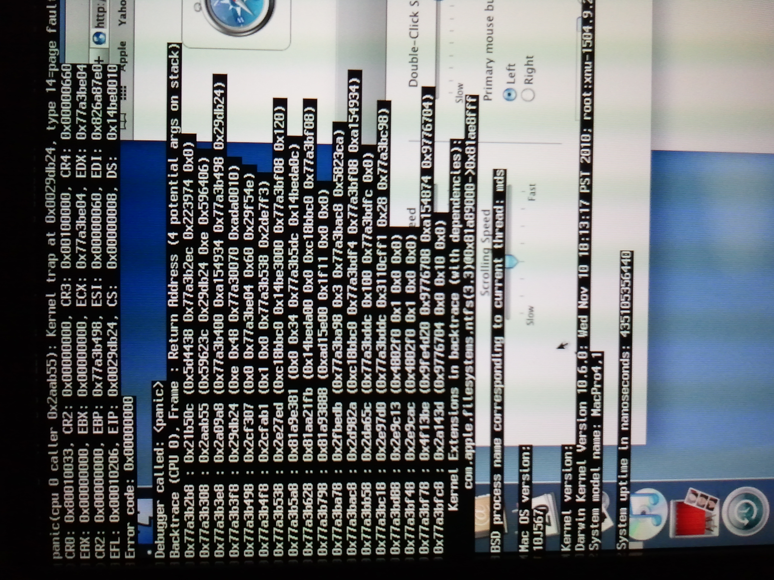

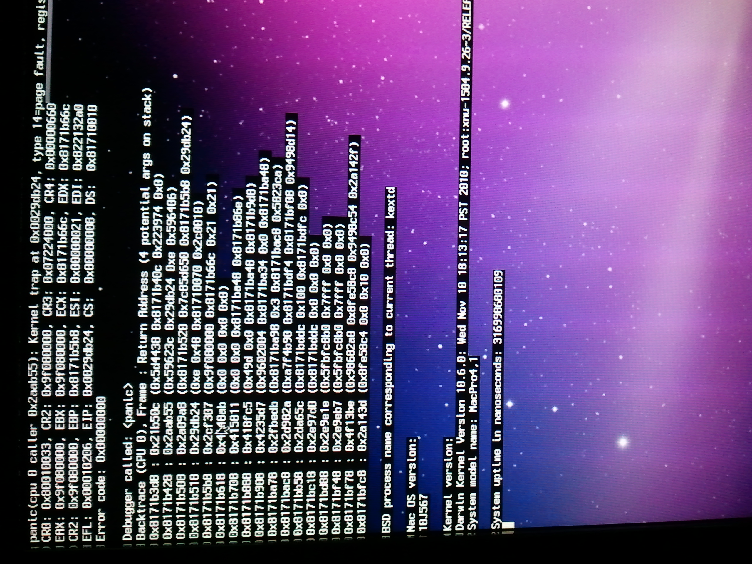

digital_dreamer Posted February 22, 2011 Author Share Posted February 22, 2011 Hi Charles, I just did a fresh install with 10.6.6 and your DSDT. As you described, I only left FakeSMC and IONetworkingFamily in extra and the latest Cham_2.0_RC5_mozo bootloader. System boots up fine. In 32bit, the systems goes to sleep and wakes up perfectly, but I get a KP after some time (see attachments). In 64bit sleep works fine _without_ KP. I prefer 64bit - so no worries about the KP - it's just FYI. But the reason why I'm writing: I don't get a internet/network connection! Neither with IONetworkFamily nor with RealtekR1000SL.kext in /extra (installed with DD's script). Systems preferences says 'no cable connected'. I tried pulling the power cable for a minute without success. I'm writing this with my first install with IONetworkingFamily in /extra so the problem has to be with your DSDT working together with my network kext... For testing reasons and more audio outputs options, I put HDAEnabler and Legacy kexts in /extra - could that be the problem? thanks in advance for your help! Maxim EDIT: it works! ok... What did I do? I tried the dsdt file from d00d's thread. With his version, network worked but I got KP after sleep and there were some other issues (orange icons etc). So I took the code of d00d's file (everything between 'PEX4' and 'PEX5', pasted it into your (CruiSAr) dsdt.aml and now network works. HDAEnabler and Legacy working in /extra. I think the KP is due to the fact that the huge monitor doesn't like laying on its side. Doesn't that hurt your neck? Try updating to the latest official BIOS. I notice you are using v7 and the DSDTs can be very dependent on BIOS versions, depending on the nature of the changes. EDIT: I just noticed Sapricot touched on this already. The first KP is very low level and doesn't reveal much useful info, but the second KP is related to the NTFS filesystem. Might you have a Windows install or NTFS partition on a JMicron (White SATA) port or PATA/IDE drive? Are you using any software for writing to NTFS? I've had good success with Paragon's NTFS for Mac OS X and used to use NTFS-3G via MacFUSE. The individual LAN kexts, like RealtekR1000SL.kext, won't work in /Extra due to their dependency on the IONetworkingFamily.kext in /System. So, you should either install them into /System or put them in the PlugIns folder inside a recent copy of a IONetworkingFamily.kext (remove the AppleRTL8169Ethernet.kext) and install that into /Extra. Best of wishes, MAJ Link to comment https://www.insanelymac.com/forum/topic/185097-guide-scripted-yosemitemavericks-install-on-gigabyte-mobos/page/129/#findComment-1643523 Share on other sites More sharing options...
VirusX Posted February 22, 2011 Share Posted February 22, 2011 I think the KP is due to the fact that the huge monitor doesn't like laying on its side. Doesn't that hurt your neck? With this method I can read best when I'm lying in my bed I just forgot to rotate my pictures ^^ Try updating to the latest official BIOS. I notice you are using v7 and the DSDTs can be very dependent on BIOS versions, depending on the nature of the changes. EDIT: I just noticed Sapricot touched on this already. I have already updated to F9 but didn't change my sig. But I had F9 and not F9m - don't know if there's a difference. But yesterday I had the same thought. But here's the problem: I changed cruiSAr's DSDT, restarted, updated my bios and then it worked. That was a little stupid because now we don't know what the "real" solution was... The first KP is very low level and doesn't reveal much useful info, but the second KP is related to the NTFS filesystem. Might you have a Windows install or NTFS partition on a JMicron (White SATA) port or PATA/IDE drive? Are you using any software for writing to NTFS? I've had good success with Paragon's NTFS for Mac OS X and used to use NTFS-3G via MacFUSE. Yes, I have another harddisk with NTFS (Win7) in my system and I'm using Paragon on my stable OSX install. But the all 3 harddisks are connected via the blue SATA ports. The individual LAN kexts, like RealtekR1000SL.kext, won't work in /Extra due to their dependency on the IONetworkingFamily.kext in /System. So, you should either install them into /System or put them in the PlugIns folder inside a recent copy of a IONetworkingFamily.kext (remove the AppleRTL8169Ethernet.kext) and install that into /Extra. Maybe this would have the solution AFAIK, the DSDT works regardless of what kext is used for network, that is IOnetworking or Realtek1000 kexts. Yes the 2 audio kexts work but I dont use them since my DSDT enables 2 channel audio and digital out and since I use digital out well I guess the rest is history, and NO that could not be the problem to your KP's. yeah I ruled that out with deleting those audio kexts.. I have also not experienced any KP's be it in 32 or 64 bit mode so your reports baffle me a lot. normally I could decipher the issue from a boot log so if u can make that available I could put some notes in the guide. Maybe that was because of my old F9 Bios? I attached my kernel.log (renamed to .txt so that I can upload it..) - maybe there's something useful in it? Well, huge thanks to all three of you! I am writing this from my new install - sleep works fine. I will install the stuff I need and sooner or later, I think this will be my new "main&stable" install Cheers, Maxim kernel.txt Link to comment https://www.insanelymac.com/forum/topic/185097-guide-scripted-yosemitemavericks-install-on-gigabyte-mobos/page/129/#findComment-1643533 Share on other sites More sharing options...
CruiSAr Posted February 22, 2011 Share Posted February 22, 2011 I think the KP is due to the fact that the huge monitor doesn't like laying on its side. Doesn't that hurt your neck? Best of wishes, MAJ LMAO...that one was funny MAJ, Maxim, no disrespect.. :-I Cant stop laughing. I was actually wondering why the pictures were vertical, I had pains in the neck trying to read the Kp info...hahaha. Thanks for pitching in on the KP info there. Maybe that was because of my old F9 Bios? I attached my kernel.log (renamed to .txt so that I can upload it..) - maybe there's something useful in it? Well, huge thanks to all three of you! I am writing this from my new install - sleep works fine. I will install the stuff I need and sooner or later, I think this will be my new "main&stable" install Cheers, Maxim Oh yes I failed to mention that the DSDT was extracted from F9m bios and patched, it works on all bios after F9m. So yeah that could have been the problem. What you can do to figure out if it was the bios version is to just replace the DSDT with the original one from my guide. I took a look at the log and as MAJ stated, the NTFS partition is issuing some errors. But again I believe it is bios related as I also have an NTFS drive present and no KP's. Since we are not on generic Mac's a couple of log errors pop up here and there but nothing to worry about. Thanks for pitching MAJ and Sapricot :-) Regards Cheers Link to comment https://www.insanelymac.com/forum/topic/185097-guide-scripted-yosemitemavericks-install-on-gigabyte-mobos/page/129/#findComment-1643594 Share on other sites More sharing options...
VirusX Posted February 24, 2011 Share Posted February 24, 2011 Oh yes I failed to mention that the DSDT was extracted from F9m bios and patched, it works on all bios after F9m. So yeah that could have been the problem. What you can do to figure out if it was the bios version is to just replace the DSDT with the original one from my guide. Alright it seems that my new install is rock-solid. Haven't restarted the last few days- only used standby I just replaced my modified DSDT with your original DSDT from your post and restarted. Went to sleep, woke up fine and the internet connection works without any problems. So the F9 Bios was definitely the problem. My next install will be LION in summer Thanks again for your DSDT and support and of course MAJ for your awesome script and all the other helpful people here in this thread! Maxim Link to comment https://www.insanelymac.com/forum/topic/185097-guide-scripted-yosemitemavericks-install-on-gigabyte-mobos/page/129/#findComment-1644622 Share on other sites More sharing options...
