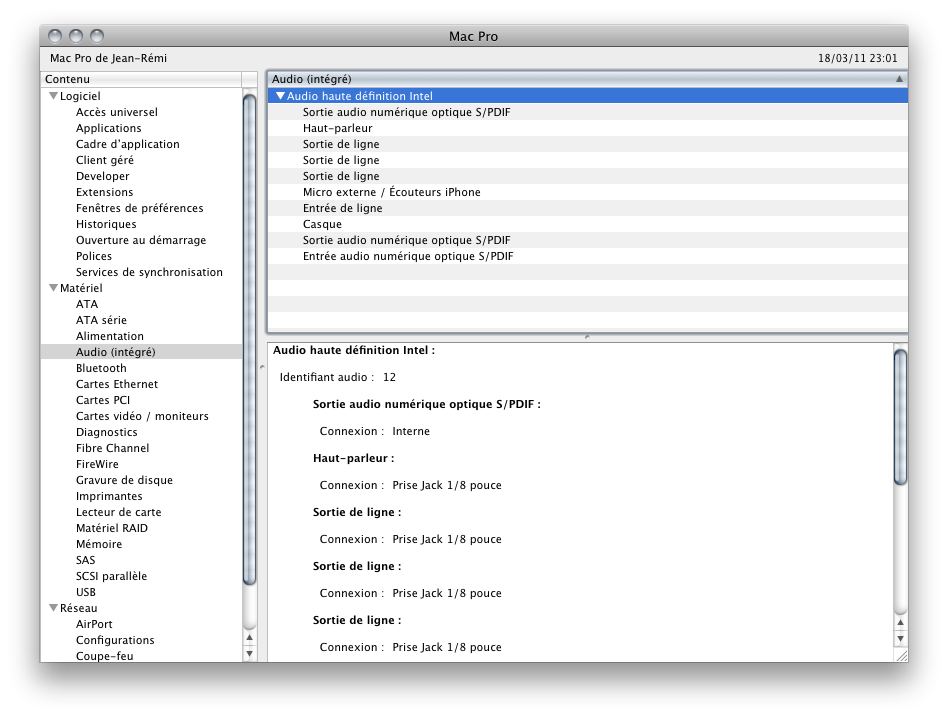

beboy Posted March 18, 2011 Share Posted March 18, 2011 Hello everyone, My GA-X58-UD5 died 3 weeks ago, and Gigabyte sent me a X58A-UD5 as a replacement. OS X still boots fine, but I can't get audio to work. I ran the last script to be up to date. I don't understand why it's not working, since it's listed in my devices (see below, sorry for the french language eheh). But in sound preferences, there's no output or input device... Anyone knows how to solve this problem ? Thank you Link to comment https://www.insanelymac.com/forum/topic/185097-guide-scripted-yosemitemavericks-install-on-gigabyte-mobos/page/131/#findComment-1657195 Share on other sites More sharing options...
everdone Posted March 18, 2011 Share Posted March 18, 2011 The X58 board uses an 889a codec for audio. The X58A board uses an 889 codec for audio. You need to change the audio kexts for the X58A board from the ones you were using for the X58 board. Link to comment https://www.insanelymac.com/forum/topic/185097-guide-scripted-yosemitemavericks-install-on-gigabyte-mobos/page/131/#findComment-1657231 Share on other sites More sharing options...

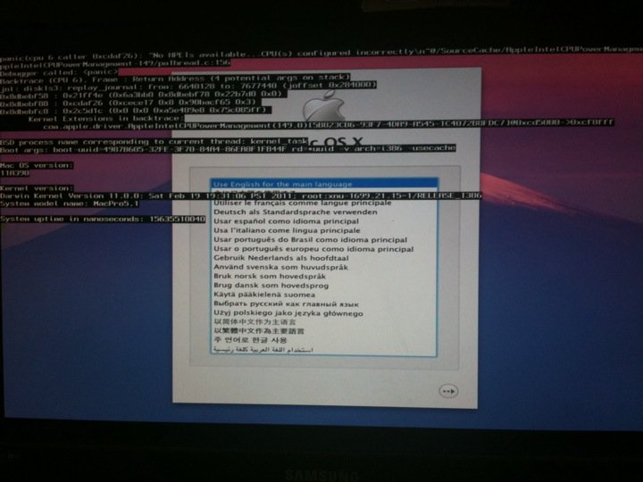

everdone Posted March 19, 2011 Share Posted March 19, 2011 I got that same KP on my X58-UD3R board (AppleIntelCPU....kext). I installed the DSDT file from the SnowLeopard install in /Extra folder and the KP did not recur. (now if I could just solve the double fault KP!!) Link to comment https://www.insanelymac.com/forum/topic/185097-guide-scripted-yosemitemavericks-install-on-gigabyte-mobos/page/131/#findComment-1657303 Share on other sites More sharing options...
imasmak Posted March 19, 2011 Share Posted March 19, 2011 thanks dd change the name of the AppleIntelCPUPowerManagement.kext in /System/Library/Extensions I tried but it did not work with me Link to comment https://www.insanelymac.com/forum/topic/185097-guide-scripted-yosemitemavericks-install-on-gigabyte-mobos/page/131/#findComment-1657502 Share on other sites More sharing options...
imasmak Posted March 19, 2011 Share Posted March 19, 2011 work fine 1- dd script 2- change the name of the AppleIntelCPUPowerManagement.kext in /System/Library/Extensions so that it doesn't load. 3- Use the BIOS HPET 32 4- DSDT.AML in Extra Link to comment https://www.insanelymac.com/forum/topic/185097-guide-scripted-yosemitemavericks-install-on-gigabyte-mobos/page/131/#findComment-1657722 Share on other sites More sharing options...

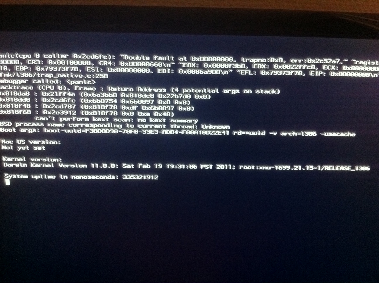

DariosF Posted March 20, 2011 Share Posted March 20, 2011 i've this problem http://www.insanelymac.com/forum/index.php...st&id=89024 how can i solve?? Thx Link to comment https://www.insanelymac.com/forum/topic/185097-guide-scripted-yosemitemavericks-install-on-gigabyte-mobos/page/131/#findComment-1658156 Share on other sites More sharing options...
digital_dreamer Posted March 21, 2011 Author Share Posted March 21, 2011 DariosF, That's the common double-fault kernel panic that occurs when attempting to boot Lion with the Chameleon bootloader. Everyone running Lion on the Chameleon bootloader runs into it. At this point, there is nothing you can do about it, except keep trying. For some, the success rate is as high as 1 out of 10. I've gotten better odds with 1 out of 5 or better. I typically will hit the return key after the bootloader loads, but before the interface shows up. MAJ Link to comment https://www.insanelymac.com/forum/topic/185097-guide-scripted-yosemitemavericks-install-on-gigabyte-mobos/page/131/#findComment-1658261 Share on other sites More sharing options...

DariosF Posted March 21, 2011 Share Posted March 21, 2011 DariosF,That's the common double-fault kernel panic that occurs when attempting to boot Lion with the Chameleon bootloader. Everyone running Lion on the Chameleon bootloader runs into it. At this point, there is nothing you can do about it, except keep trying. For some, the success rate is as high as 1 out of 10. I've gotten better odds with 1 out of 5 or better. I typically will hit the return key after the bootloader loads, but before the interface shows up. MAJ Thx...so i'll wait some news... Link to comment https://www.insanelymac.com/forum/topic/185097-guide-scripted-yosemitemavericks-install-on-gigabyte-mobos/page/131/#findComment-1658400 Share on other sites More sharing options...
