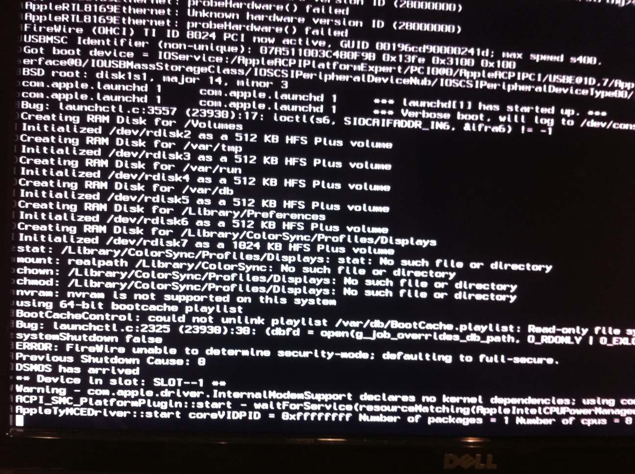

...still working with the boot flash drive and am getting this when I am first booting into my hackintosh from it. Is this a KP? Can anyone interpret what it is telling me?
I accepted all defaults when making the boot flash drive which I installed from macbookpro on 10.6. (just upgraded it to SL)
Thumb drive gets recognized as a regular drive so I put it first in boot order.
Things I have tried:
I removed all drives but the one I want to install to.
switched bois from raid back to achi mode.
Hardware:
gigabyte ex58-ud5
i7 920
sapphire 4870 1gb
wd caviar drive
Hardware:
gigabyte ex58-ud5
i7 920
sapphire 4870 1gb
wd caviar drive
Alas! More ATI video card problems! Your boot drive does not 'like' your video card. The next 'step' beyond where you have stopped is switch to Mac GUI video. Unfortunately, you video card is not recognized and you can't go past where you are.
suggestion: swap in an Nvidia 9500GT and there is a 98% probably you will have video and can proceed with the install. After you have the OS installed you can chase after the drivers for your ATI card and spend a few days getting that card to work. (ATI cards will work but you need the right kexts. I gave up using ATI because of the hassle of making them work)
Ah, thanks for the assessment. I have had this machine/video card working on 10.6 before using this script about a year ago (before my SSD crashed). The difference was that I installed directly into my hdd by tethering it to my macbook and running the script vs this new flash install method. At that time, I was just using the kexts included in DD's installer.
Doesn't the flash boot method use those kexts?
The other thing I just thought of, is maybe I don't have the monitor plugged into the primary video port. Not sure if that could cause this behavior, but I can try it again tonight.
I don't know what kexts are included in the flash boot, but apparently at least one of those you were using in the previously install is not on your boot drive. I would suggest trying Tonymacx's [url="http://www.insanelymac.com/forum/topic/279450-why-insanelymac-does-not-support-tonymacx86/"]#####[/url] disk for ATI. I have used his Nvidia version to boot a couple of my installs. You can use DD's script to do the install no matter what you use to boot the machine with - the important thing is to find something that will boot.

FYI - got the boot flash drive working with this card. I guess I needed to add EVOEnabler and LegacyATI4800Controller.kext to the boot_disk/extra/extensions folder.
Now I got stuck on booting the 2nd time to copy the script over to the main drive. As I was installing the first time, I saw out of the corner of my eye a black sreeen flash with text, then got a reboot. The flash drive only gave me the option of installing so I am thinking it crashed during the first install? If it fails again, I might try the ATI_Init.kext and try again.
Ah! I got it. It wasn't clear to me from the instructions... after install, boot from the flash drive, and once you are at the bootloader screen select the hdd you just installed to. Copy the script from there and proceed...

Unfortunately by using the new bootloaders, I see only a black screen and hear helicopters inside Zalman, nothing else :)
