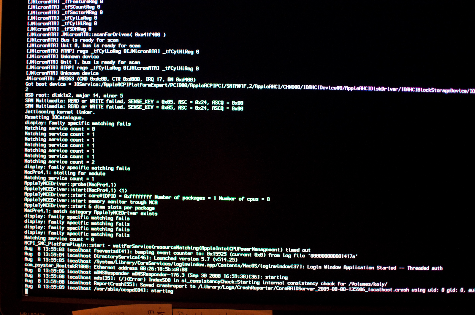

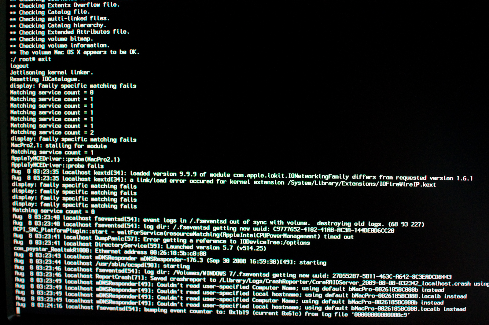

Multisaft Posted August 8, 2009 Share Posted August 8, 2009 i've done the fcking hole thing again and again mdns responder... dunno would someone plz help me? when i boot into safe-mode and run fsck it tells me at the end ***** File System Was Modified ***** and now? Link to comment https://www.insanelymac.com/forum/topic/176881-guide-asus-p6t-se-retail-vanilla-w-chameleon-100-working/#findComment-1220316 Share on other sites More sharing options...
Multisaft Posted August 8, 2009 Share Posted August 8, 2009 done the whole thing again. most of the time my coreRaidServer crashes. network card: realtek 8111c updated the realtek kext from the official realtek-side and used the IONetworkingFamily.kext from the X58_Mobo_Patch-pakage and the hardware-adress for the nic that is displayed on startup doesn't match with the hardware-adress that is displayed inside kaly 10.5.2. a hint for problems mit nic-kext? inside kaly 10.5.2 my nic is working. btw. i have disabled my firewire port because there was an error, too. ____ UPDATE 2 my efi-strings in boot.plist messed it up. not the raidserver stop the startup but: /usr/sbin/ocspd[xx]: starting means nothing else, that the graphics-driver should be initialised. but when your system crashs at this time your efi-string and your /S/L/E/NVDAResman.kext have some trouble with each other. Workaround: 1. delete your efi-string out of /Extra/com.apple.boot.plist and reboot 2. install the gt200 drivers (see gt200 thread) and reboot (you will get a dark or blue screen at first startup), use your second installation or vesa-startup -x, -s 3. add your efi-string again to /Extra/com.apple.boot.plist and reboot 4. cross your fingers that you wont get the ocspd message again (see verbose mode) but right now: now sound! Link to comment https://www.insanelymac.com/forum/topic/176881-guide-asus-p6t-se-retail-vanilla-w-chameleon-100-working/#findComment-1220583 Share on other sites More sharing options...
