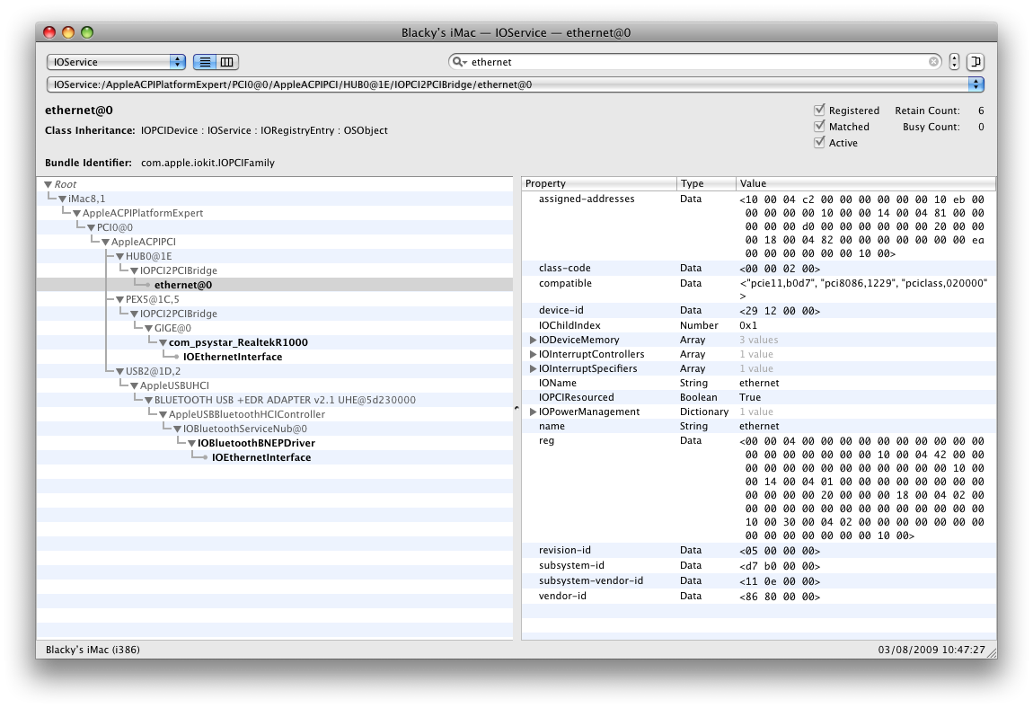

Does anything show in ioreg?
EDIT: Well I found an old Compaq NIC, put it in my hack. I booted up and went to IORegistryExplorer and it shows the device (see attached screengrab). I can't get it to function. But I don't get any PCI errors in the system.log either.
Does it show in system profiler?
I didn't think of using IOReg, but I'm guessing it wouldn't appear (it's in another machine now) - see notes about voltage above. It seems it may just be this card that isn't compatible.
