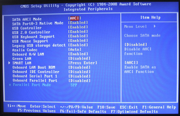

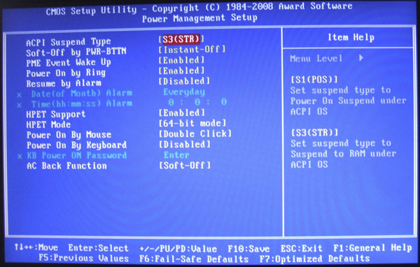

To wake my system up from sleep, I have to tap the power button on the case. The keyboard or mouse won't wake it up. (But I used to be able to wake it up with the keyboard/mouse?.... Maybe it did have something to do with the removal of those two extensions after all?, or maybe it's the DSDT.aml file I am using/testing... I will have to check.)
Anyone else have other devices etc allowed to wake the machine in their bios?
Not too sure what settings you mean here, but if it helps for comparison, I have attached photos of the settings on two of my BIOS screens. One for Integrated Peripherals and the other for Power Management. I you need me to supply any other info, just ask.
Note: to anyone looking at these BIOS pics, these are just what mine are currently set to, they might not be optimum settings for this install...For instance, Power On By Mouse, only refers to a PS/2 mouse not USB. One day I will get round to tweaking each setting (but the old adage applies.... if it ain't broke then don't fix it).
Thanks again :blink:
