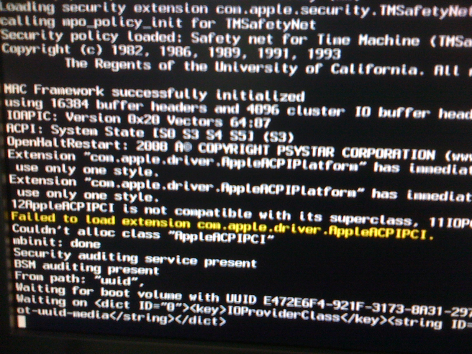

zangieff Posted August 13, 2009 Share Posted August 13, 2009 Yes it would. But first, zangieff, can you try following this to make yourself a boot USB stick? Using your Mac with Tiger on it. Insert your USB Stick Open Disk Utility and partition the USB stick with 1 x partition with GUID Partition Table, as Mac OS Extended. From the attached files, double click the Chameleon r431 installer and do a standard install to the USB stick, select the default options. When it's finished installing, add the kexts from the attached files in to the /Extra/Extensions folder. Delete the Extensions.mkext from /Extra Then run mkext tool, add the extensions from /Extra/Extensions in to the mkext tool window, point it to the /Extra folder and click build to make an updated Extensions.mkext. Then reboot, using F12 to select boot options. Select HD's and choose the USB HD from the menu. Fingers crossed that helps. If not, then we'll look at the option Geithals suggested. its finally working. I dont know what i did to be honest. i downloaded some other boot 123 disk (weak sauce) it booted even though ahci was disabled. I updated to 10.8 with software update. But now i'm lost i have no sound and the graphics card i bought is longer listed on the wiki asus en9400 gt 512, i have however read that its supported from a few threads. i tried installing with with kext helper & osx tools as suggested in a post. i copied your kext to the extra folder( thats as far as i got) the rest is kinda confusing. The other issue i have is that i have 2 hardrives 1 with windows and the other with osx. Windows only work with the ahci disabled & osx only works when its enabled. The only way i can boot at the moment is to change the settings then press f12 to select the hardrive to boot. I'm Happy its working at least so thanks for all your help so far. Verry much appreciated Link to comment https://www.insanelymac.com/forum/topic/173651-guide-vanilla-retail-1057-with-chameleon-v2-rc2-for-gigabyte-ga-ep45-ds3l-optional-update-to-1058/page/15/#findComment-1225393 Share on other sites More sharing options...
blackosx Posted August 13, 2009 Author Share Posted August 13, 2009 its finally working. I dont know what i did to be honest. i downloaded some other boot 123 disk (weak sauce)it booted even though ahci was disabled. Well done to get it working After all your attempts today, surely you must know exactly what you did to get it up and running? But thanks for letting me know about the weak sauce boot 132 CD. it booted even though ahci was disabled. AHCI is recommended for OSX because the OS will take advantage of the new advanced features. See here for more details. I updated to 10.8 with software update. But now i'm lost i have no sound. After you booted with the weak sauce boot CD, did you at any point put my Boot CD back in and finish the instructions to add the kexts etc.? This guide was written for 10.5.7 as the 10.5.8 update has only just come out. Because you will need to use a DSDT for sleep with 10.5.8 (as mentioned in the boot CD instructions) it makes sense to add audio with DSDT rather than using the kexts. and you will gain a better audio experience. See my DSDT guide. the graphics card i bought is longer listed on the wikiasus en9400 gt 512, i have however read that its supported from a few threads. The Hardware Compatability List for 10.5.7 lists a 9400GT 512 MB and reports it works, so I am sure you will get it working. i tried installing with with kext helper & osx tools as suggested in a post. Kext helper will add kexts to the /System/Library/Extensions folder and with this install you ideally only want to be adding kexts to Chameleon's /Extra/Extensions therefore, leaving the retail install untouched. It's your system to play with but read and try to understand what you have and what others tell you so at least you can undo anything if it goes wrong. i copied your kext to the extra folder( thats as far as i got) the rest is kinda confusing. You need to add the kexts to the /Extra folder and rebuild Extensions.mkext to get the system functioning to the best that we've been able to work out. What's confusing? I can't make the install guide PDF any simpler.. it's step by step... It's now up to you to read, research and learn just like we all did. The other issue i have is that i have 2 hardrives 1 with windows and the other with osx. Windows only work with the ahci disabled & osx only works when its enabled. The only way i can boot at the moment is to change the settings then press f12 to select the hardrive to boot. Read the wiki link I posted above.. I have also written a guide for dual booting with Windows 7 if that's any use to you. I'm Happy its working at least so thanks for all your help so far. Verry much appreciated I am glad you're happy Link to comment https://www.insanelymac.com/forum/topic/173651-guide-vanilla-retail-1057-with-chameleon-v2-rc2-for-gigabyte-ga-ep45-ds3l-optional-update-to-1058/page/15/#findComment-1225444 Share on other sites More sharing options...
justmetoo Posted August 14, 2009 Share Posted August 14, 2009 QUOTE (zangieff @ Aug 13 2009, 09:51 PM) The other issue i have is that i have 2 hardrives 1 with windows and the other with osx. Windows only work with the ahci disabled & osx only works when its enabled. The only way i can boot at the moment is to change the settings then press f12 to select the hardrive to boot. My memory may be bad, but don't we have the option with this board to save multiple BIOS settings and select which one we wish to use when booting? An extra step or two. Not sure why this would be necessary; perhaps due to different Windows versions? I'm running Windows Vista 64 just fine with the same BIOS settings that Blackosx recommends for this install. Link to comment https://www.insanelymac.com/forum/topic/173651-guide-vanilla-retail-1057-with-chameleon-v2-rc2-for-gigabyte-ga-ep45-ds3l-optional-update-to-1058/page/15/#findComment-1225852 Share on other sites More sharing options...
