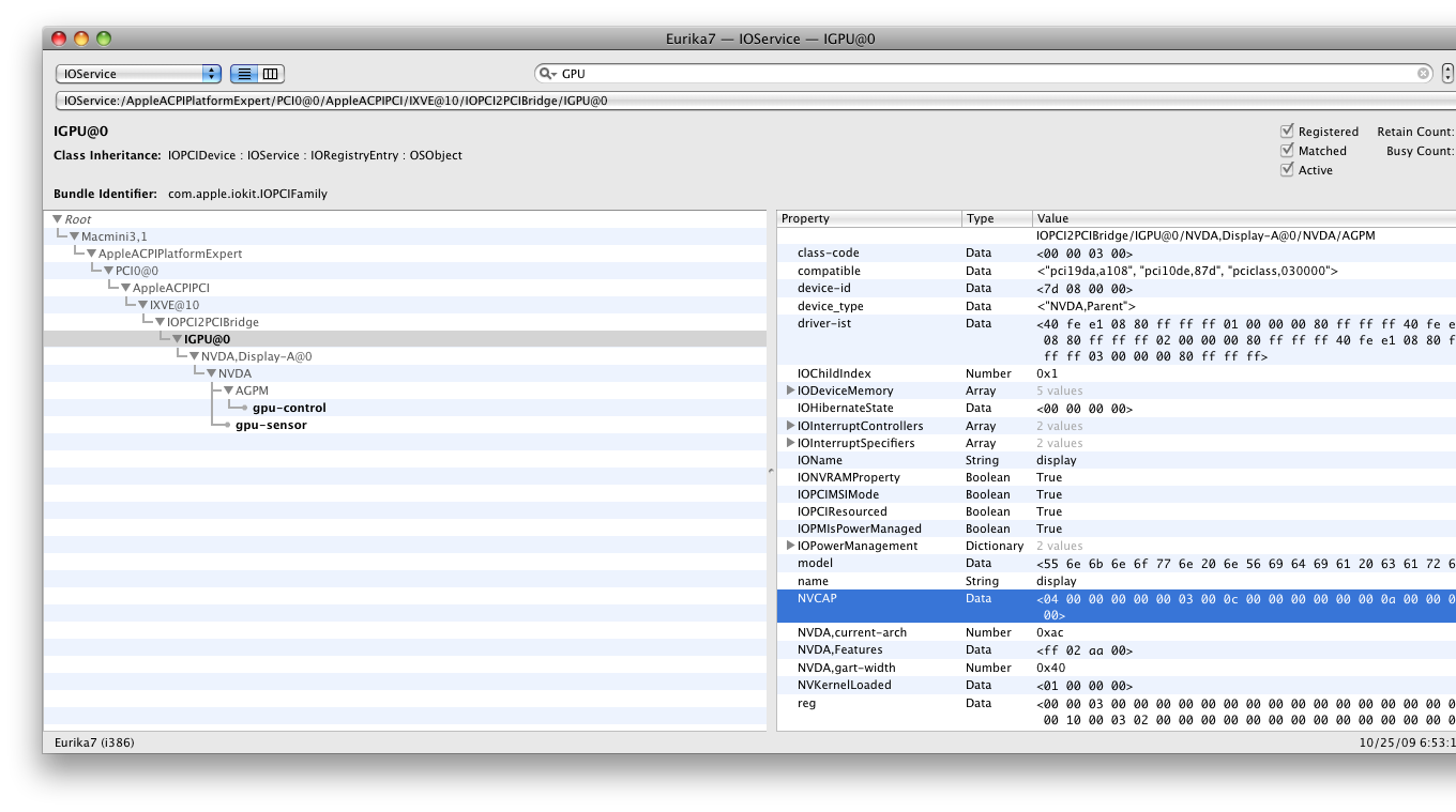

wrc4 Posted October 30, 2009 Share Posted October 30, 2009 ... . . hmm: slightly surprised by issue 2 Suggest you put attached dsdst.aml in /Extra; & attached *.kext in E/E - then rebuild your caches & Extensions.mkext using, if lazy like me, the latest version of Cvad's natty tool. Suuggest you use the graphicsenabler in PC-EFI, together with the NVIDIA.ROM I attached to post 133, remembering to edit your apple.com.boot.plist as in that post. Please report back Hi shoarthing, Thanks for the file. Yes. I do have problems with Ethernet. It still doesn't work after using your kext & DSDT.aml. Sound works after adding the kext for ALC662 and updating everything using Cvad's tool. (BTW, it's a great tool!) But my video is still not working. Here is what I did: 1. copy NVIDIA.ROM to / of my HD. 2. Modify com.apple.Boot.plist in /Extra to include the following: <key>GraphicsEnabler</key> <string>Yes</string> <key>VideoROM</key> <string>/NVIDIA.ROM</string> <key>VBIOS</key> <string>Yes</string> 3. Run KextUtility & Reboot But after that, nothing seems have changed. Am I doing this wrong? Or is there any other steps to use GraphicsEnabler? Link to comment Share on other sites More sharing options...

shoarthing Posted October 30, 2009 Share Posted October 30, 2009 wrc4 - Hi - first suggest you check you have allocated 256M or 512M to video [in the southbridge section of the BIOS] Then please get hold of ioregistryexplorer [included in xcode tools, also in dsdtse] & take a look at what is shown when you type 'igpu' into it . . you can see the sort of output Mushishi & I see above in his thread. Link to comment Share on other sites More sharing options...
