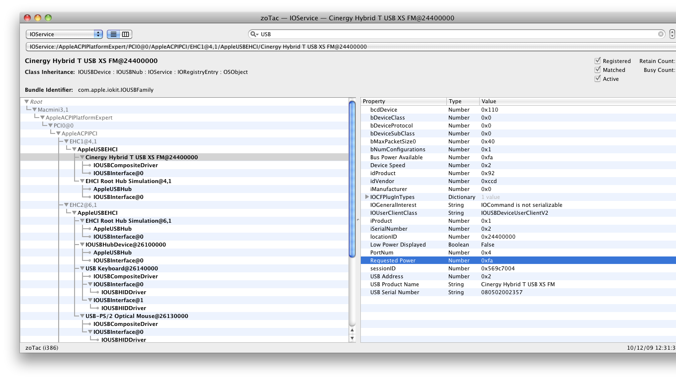

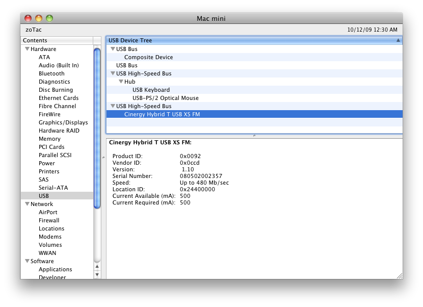

Mushishi Posted October 9, 2009 Share Posted October 9, 2009 hi shoarthing I have some usb problems on my board that i have written on the zotacusa.com forum about. I wonder if the EyeTV problem could be a underpowering problem on the zotac boards and that the asrock dont underpower.. But here is the link to my tread on the zotac forum. http://www.zotacusa.com/forum/index.php?/t...;-usb-20-issue/ Link to comment https://www.insanelymac.com/forum/topic/164051-nvidias-ion-platform-and-os-x/page/5/#findComment-1294090 Share on other sites More sharing options...

Mushishi Posted October 9, 2009 Share Posted October 9, 2009 Well i allready have it working fine with Legacy enablet in the bios so i can use my usb k/b in the bios... but i still want it the bios to be fully working so to speak... And my Fullspeed problem is not only osx.. as soon as i enable it, it hangs every os i try... And as you could see the zotac guy say they are not able to reproduce the problem. As it is now i can see 4 usb hubs in osx.. 2 that are usb 1.1 and 2 that are usb 2.0 but if there is some bad code in there AMI ({censored}) bios they need to fix it.. Ohh and where i did see the EHCI Handoff text was in osx boot verbosen but i did deside not to say that on there forum... looool... Link to comment https://www.insanelymac.com/forum/topic/164051-nvidias-ion-platform-and-os-x/page/5/#findComment-1294257 Share on other sites More sharing options...
kaiou Posted October 9, 2009 Share Posted October 9, 2009 I do not think it's a problem with usb. I will use with legacy off. And they work all 8 USB ports, I also have 2 controllers 1.0 and 2 2.0. You might get in the bios by pressing del, enter me! By placing the antenna well, DDT is also ok. Some channels keep the CPU at 50% .. And the vision is perfect .. Changes channels faster than mine hackpro .. if I pause the playback, EyeTV continues to "register", and in this situation, the CPU is below 10%. Indeed, all video, even of very low quality is hard, and the CPU rises dramatically .. I am increasingly convinced that the performance of the GPU is not fully active .. Now the audio works fine, but not to HDMI, the HDMI output from me still having problems with blue images, blue, and I can not find when it happens .. Link to comment https://www.insanelymac.com/forum/topic/164051-nvidias-ion-platform-and-os-x/page/5/#findComment-1294400 Share on other sites More sharing options...

shoarthing Posted October 10, 2009 Share Posted October 10, 2009 Edit: The EyeyTV issues were my fault (of course): I had forgotten the application buffers its TV streams onto the volume where your EyeTV library is - in my case this is a Time Capsule not just far far away; but with the TC's default spindown - hence the skipping & so o as the remote HDD was spun up. Have now set the buffer to RAM. Link to comment https://www.insanelymac.com/forum/topic/164051-nvidias-ion-platform-and-os-x/page/5/#findComment-1295137 Share on other sites More sharing options...
Mushishi Posted October 11, 2009 Share Posted October 11, 2009 Hi. No i dont use the widget, i did't know there was one and i dont need it.. Well been playing with EyeTV a little over the weekend, and here on mine it is only on some of the channels i get the skipping. But most of my channels are fine... i am running at 2GHz at the moment and i might give it a bit more to see if i can solve the last skipping.. i know i have been running 2.2 GHz with no problems. Here are the screenshots you did request. Link to comment https://www.insanelymac.com/forum/topic/164051-nvidias-ion-platform-and-os-x/page/5/#findComment-1295638 Share on other sites More sharing options...
