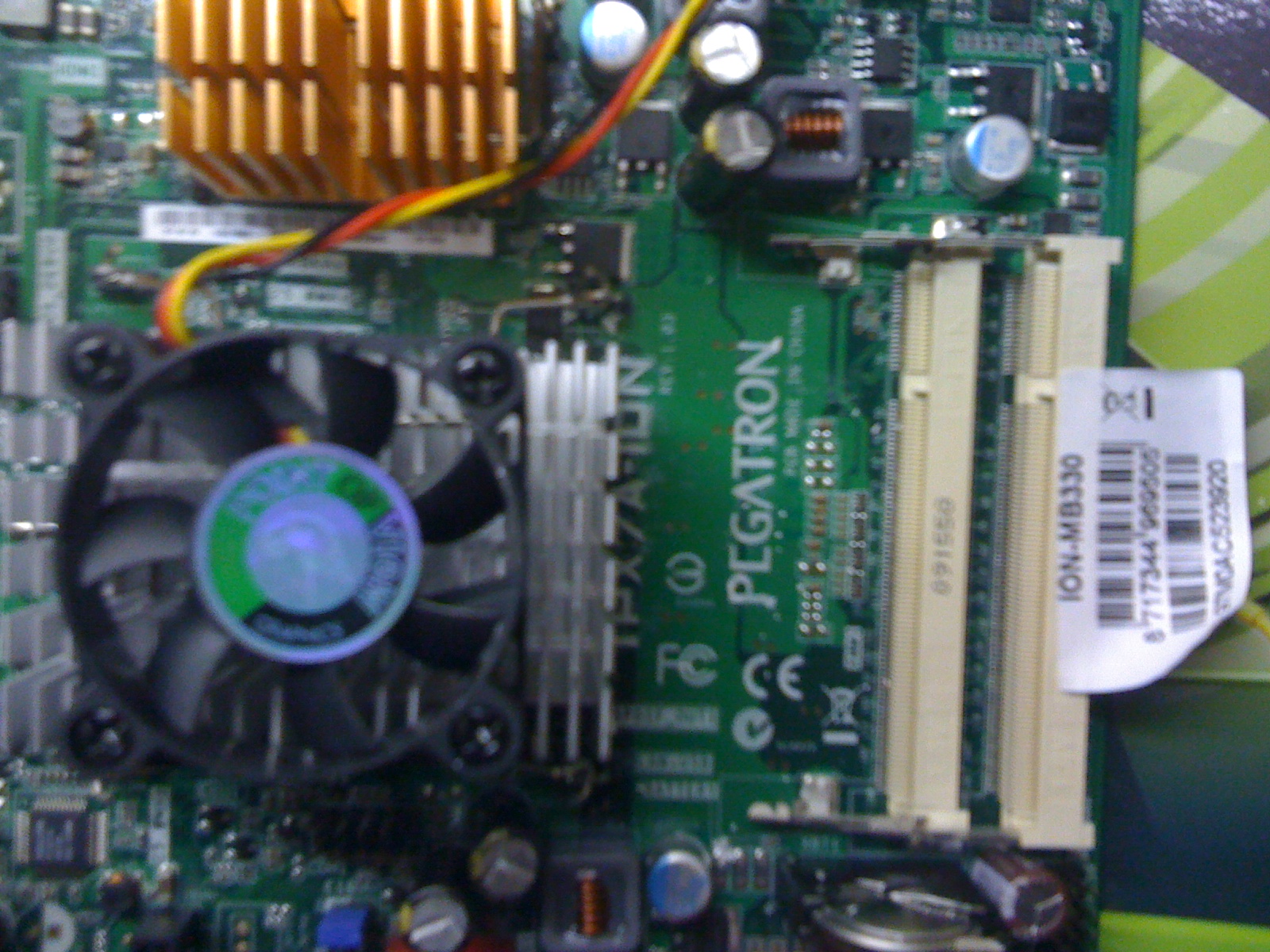

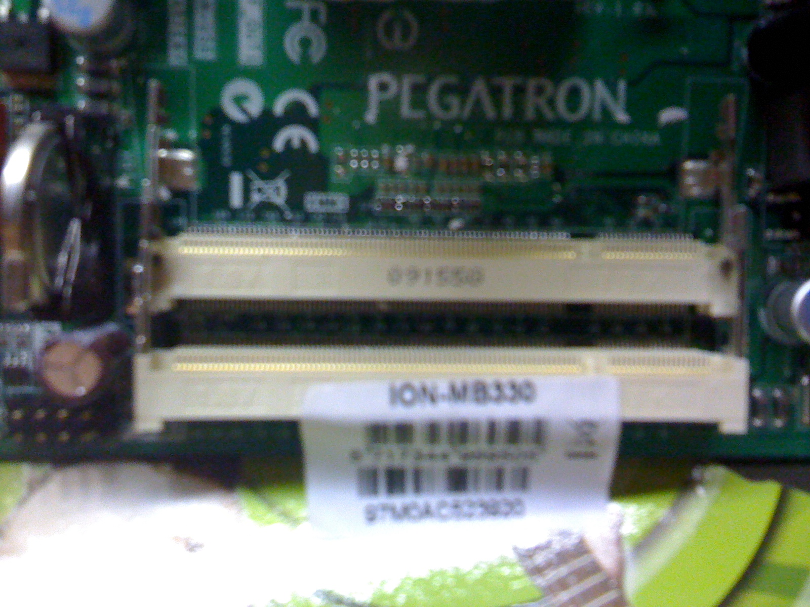

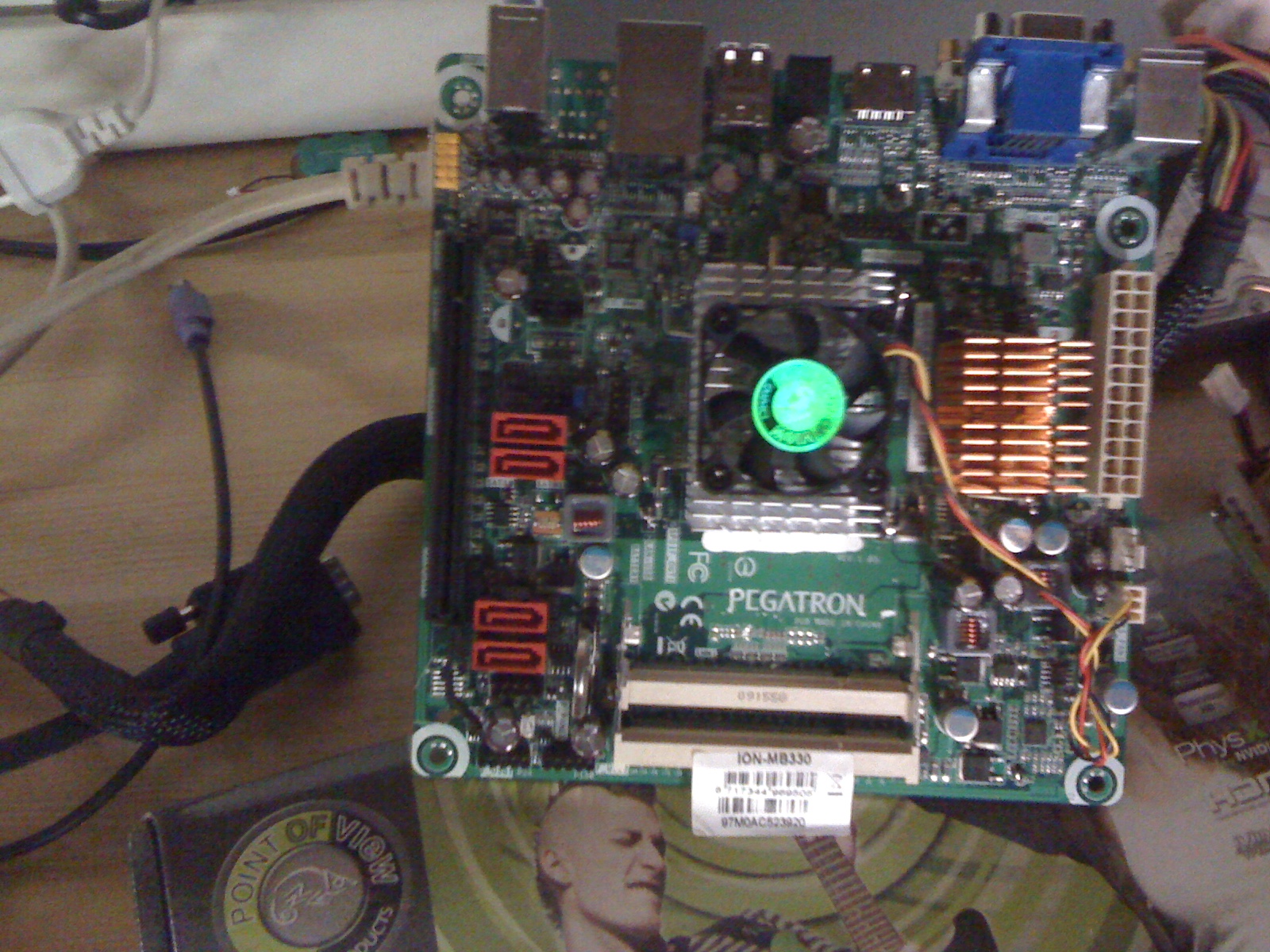

mc-iceman Posted August 14, 2009 Share Posted August 14, 2009 LOOOOL POINT OF VIEW sells the board to same ION-330 as PEGATRON View Photo: The name became with lacquer over covers!! I laugh my dead ps. Sorry for my Englisch ::Edit:: has who that link to Pegatron HP??? Link to comment https://www.insanelymac.com/forum/topic/164051-nvidias-ion-platform-and-os-x/page/3/#findComment-1226102 Share on other sites More sharing options...
