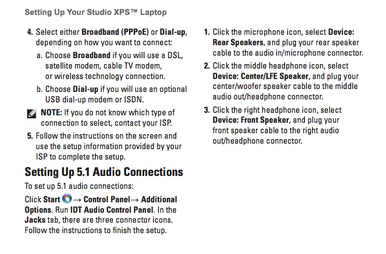

jarodsix Posted May 18, 2009 Share Posted May 18, 2009 I dont know how far the audio progress is right now (I read through this thread a couple of days ago) but I have found this interesting bit in Dell Manual for this notebook (see picture attached). The mic input is actually being used also as an output when using 5.1? Link to comment https://www.insanelymac.com/forum/topic/161650-dell-xps-1340-mostly-working-with-osx-10561057/page/8/#findComment-1159141 Share on other sites More sharing options...
