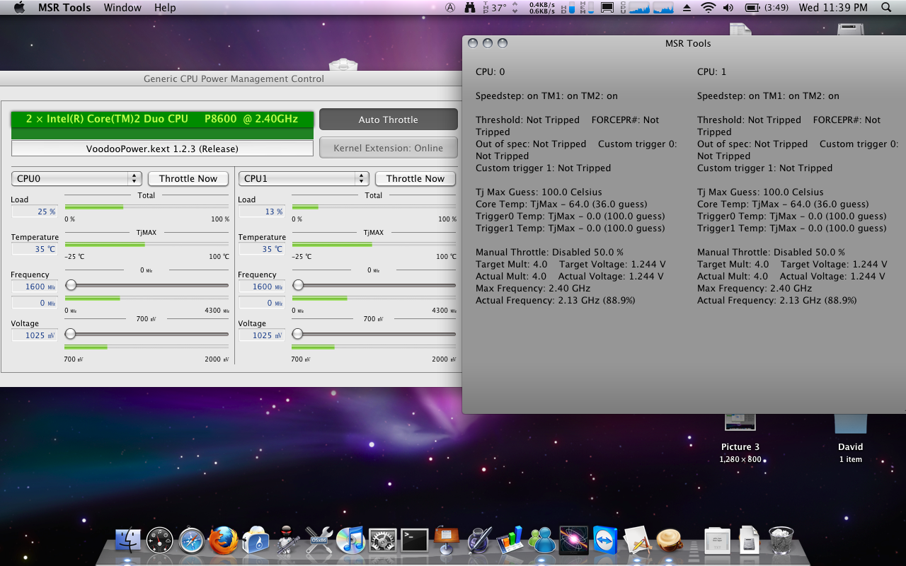

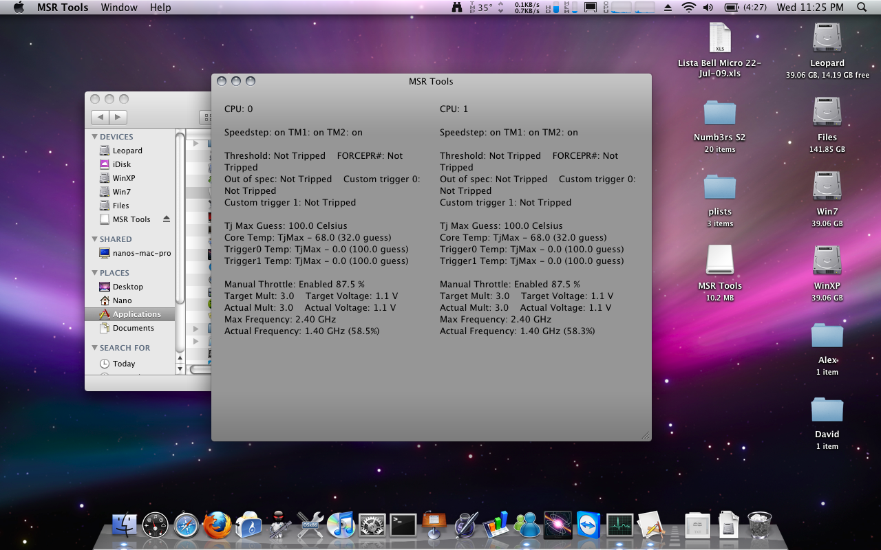

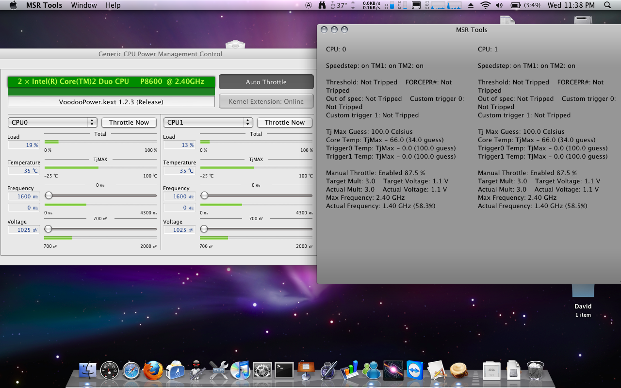

pmcnano Posted August 6, 2009 Share Posted August 6, 2009 I dont think The voltage is reported correctly..........but check this out..........ill post a pic in some minutes! edit: Ok, I DONT KNOW what changes when AppleIntelCPUPowerManagement.kext is loaded here are pics, I deleted the kext and restarted and magicaly from 4 hours (battery time) i went to 3 hours, restored and restarted and 4 hours again!...Here are pics, MSRtools reports something different than superhai's tool! And, btw If i unload voodoopower in msrtools it will stick at 1.6ghz......see by yourself.. Link to comment https://www.insanelymac.com/forum/topic/161650-dell-xps-1340-mostly-working-with-osx-10561057/page/18/#findComment-1217988 Share on other sites More sharing options...

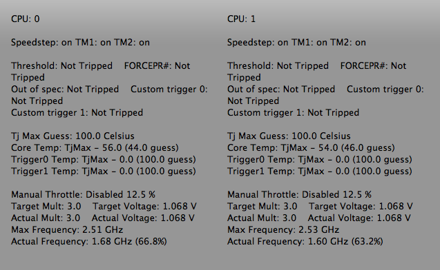

bcc9 Posted August 7, 2009 Author Share Posted August 7, 2009 IRegarding the super-lfm modes, it seems I am stuck at 1.068 V as the minimum voltage at idle.So I don't get it. I tried AppleIntelCPUPowerManagement under 10.5.8 and it also doesn't allow the CPU to throttle across different P-states. The CPU stays pagged at 1 individual state. Are you seeing the P-states change dynamically without voodoopower? If you kextunload VoodooPower, then the P-state remains frozen at whatever state it last left it at. So perhaps you were running voodoopower, switched to appleintelcpupowermanagent, and thought that it was throttling the cpu because of that. Also I still don't see the point of the dsdt change you posted. I get that you used an older version of the aml compiler and so had to clean up cosmetic errors. But I posted a dsdt.aml that I pre-compiled with a newer version of the compiler and doesn't require those changes. I see no other difference in what you posted, and don't see why or how any of those changes would matter to AppleIntelCPUPowerManagement. Do you know which change does? (It doesn't make a difference in my testing). Ok, I DONT KNOW what changes when AppleIntelCPUPowerManagement.kext is loaded here are pics, I deleted the kext and restarted and magicaly from 4 hours (battery time) i went to 3 hours, restored and restarted and 4 hours again!...Here are pics, MSRtools reports something different than superhai's tool! And, btw If i unload voodoopower in msrtools it will stick at 1.6ghz......In your screen shots I notice that msr tools and cpu-x aren't even agreeing on the current core speed. I think this shows that the two applications are fighting over getting the status info from the hardware. On my machine MSR tools readily hogs 100% of the CPU and so it seems to really be misbehaving. The fact that unloading voodoopower shows your cpu sticking at one rate shows that AppleIntelCPUPowerManagement isn't working when it comes to managing P-states. I'm having that problem with it as well, and thus I don't see any benefit from appleintelcpupowermanagemnt. When you say your batter life changes between 3 & 4 hours depending upon just appleintelcpupowermanagemnt, how are you measuring? If you're just checking the time remaining reported by an application, maybe it is being faked out like msr tools above. Also, my machine would not upgrade from 10.5.7 to 10.5.8 unless I ran disabler.kext to disable appleintelcpupowermanagemnt. Otherwise the system would crash at about 10% thru the upgrade. This was with cheesy's dsdt version of the dsdt loaded... Link to comment https://www.insanelymac.com/forum/topic/161650-dell-xps-1340-mostly-working-with-osx-10561057/page/18/#findComment-1219012 Share on other sites More sharing options...

Cheesy Posted August 7, 2009 Share Posted August 7, 2009 So I don't get it. I tried AppleIntelCPUPowerManagement under 10.5.8 and it also doesn't allow the CPU to throttle across different P-states. The CPU stays pagged at 1 individual state. Are you seeing the P-states change dynamically without voodoopower? Yes, the clock is idle at 1.6 GHz then goes to 2.53 GHz under increased CPU load. With MSR Tools I see the clock value changing. If you kextunload VoodooPower, then the P-state remains frozen at whatever state it last left it at. So perhaps you were running voodoopower, switched to appleintelcpupowermanagent, and thought that it was throttling the cpu because of that. Nope, voodoopower is not installed on my machine and never was. Also I still don't see the point of the dsdt change you posted. I get that you used an older version of the aml compiler and so had to clean up cosmetic errors. But I posted a dsdt.aml that I pre-compiled with a newer version of the compiler and doesn't require those changes. I see no other difference in what you posted, and don't see why or how any of those changes would matter to AppleIntelCPUPowerManagement. Do you know which change does? (It doesn't make a difference in my testing). I know that any of those changes should not matter. Attached is my compiled dsdt.aml, try it, if it has to do with the compiler version we will then know. Maybe it has to do with the CPU used (should not matter but...) my 1340 has the P8700. Also, my machine would not upgrade from 10.5.7 to 10.5.8 unless I ran disabler.kext to disable appleintelcpupowermanagemnt. Otherwise the system would crash at about 10% thru the upgrade. This was with cheesy's dsdt version of the dsdt loaded... I upgraded from 10.5.8 using software update without disabler.kext. dsdt.aml.zip Link to comment https://www.insanelymac.com/forum/topic/161650-dell-xps-1340-mostly-working-with-osx-10561057/page/18/#findComment-1219044 Share on other sites More sharing options...
pmcnano Posted August 7, 2009 Share Posted August 7, 2009 Eh...well bcc9, I checked the remaining time in the battery status? Left my laptop IDLE and the remaining time is completely different with the kext loaded than unloaded (you have to restart). Why dont you try it yourself??? It shouldnt be difficult to notice the difference, at least for me its pretty obvious. edit: @cheesy, could you please check your cpu freq with cpu-x?? I dont trust in msr tools, they tell me my idle cpu is @ 450mhz lol not even in windows i get that clock speed Link to comment https://www.insanelymac.com/forum/topic/161650-dell-xps-1340-mostly-working-with-osx-10561057/page/18/#findComment-1219066 Share on other sites More sharing options...
bcc9 Posted August 7, 2009 Author Share Posted August 7, 2009 Yes, the clock is idle at 1.6 GHz then goes to 2.53 GHz under increased CPU load. With MSR Tools I see the clock value changing.I used your DSDT.aml, and same result - my p8600 cpu stays fixed at 1.6ghz, no change shown with msr tools or cpu-x. msr tools does still consume all the cpu and cause the system to hang if I use it for very long. Eh...well bcc9, I checked the remaining time in the battery status? Left my laptop IDLE and the remaining time is completely different with the kext loaded than unloaded (you have to restart). Why dont you try it yourself??? It shouldnt be difficult to notice the difference, at least for me its pretty obvious. Um ya, I did try to find a way to get the battery icon to report time remaining (like it does under other OSes), but no such luck. That's why I asked. Under the battery icon details, it still shows "Power source: Power adapter" even when the icon itself has changed to show that the power source is the battery. With the battery icon configured for 'show->Time' it displays "(Charged)" even though 'show->Percentage' reports a number < 100%. Link to comment https://www.insanelymac.com/forum/topic/161650-dell-xps-1340-mostly-working-with-osx-10561057/page/18/#findComment-1219827 Share on other sites More sharing options...
