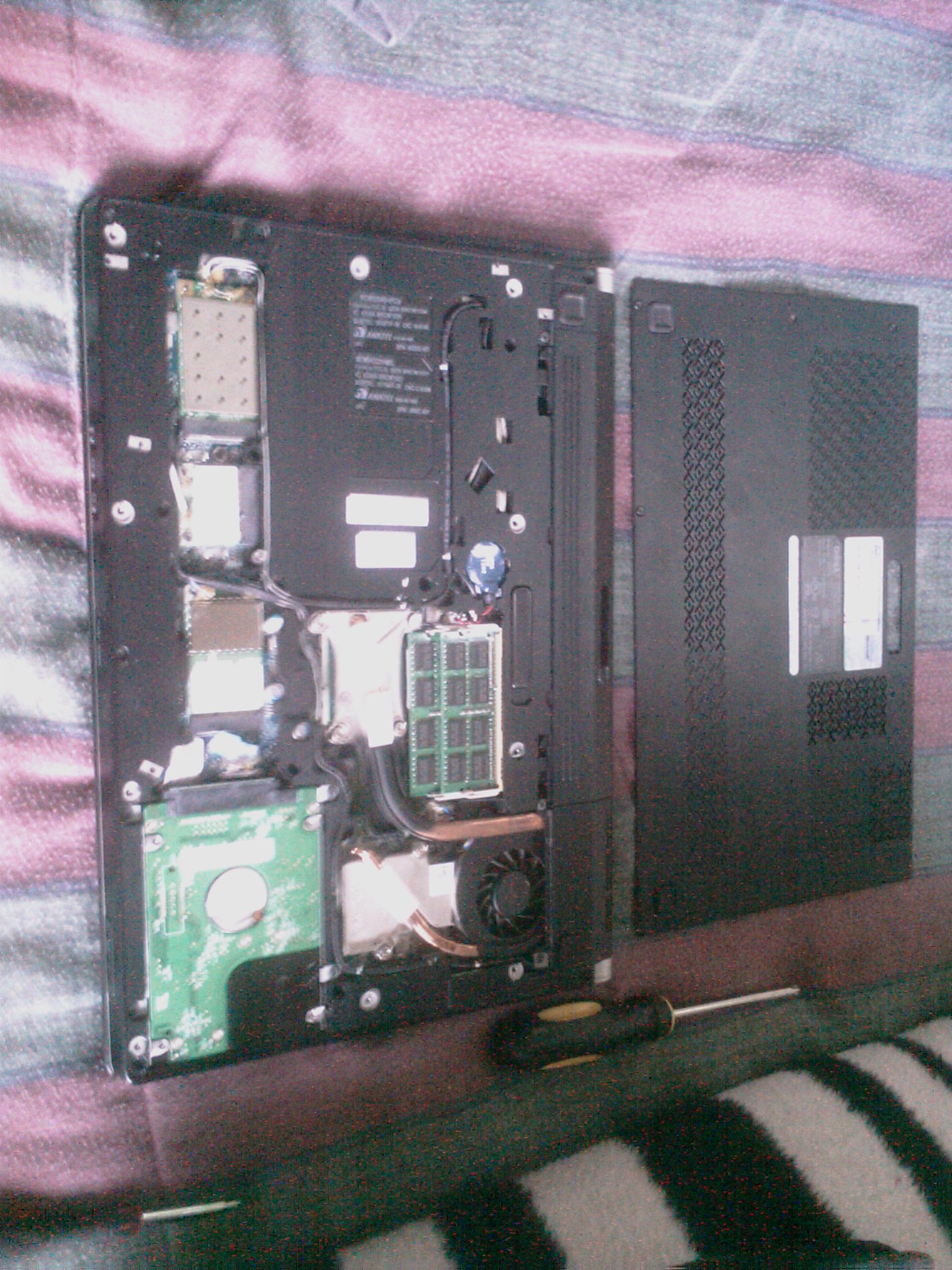

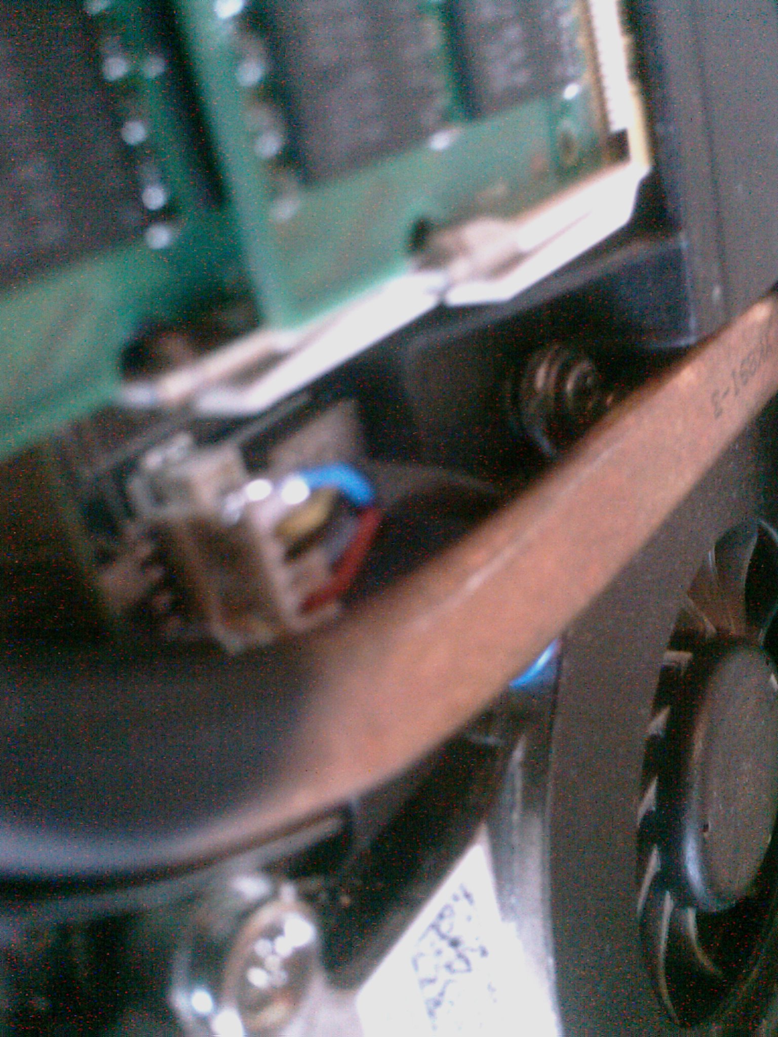

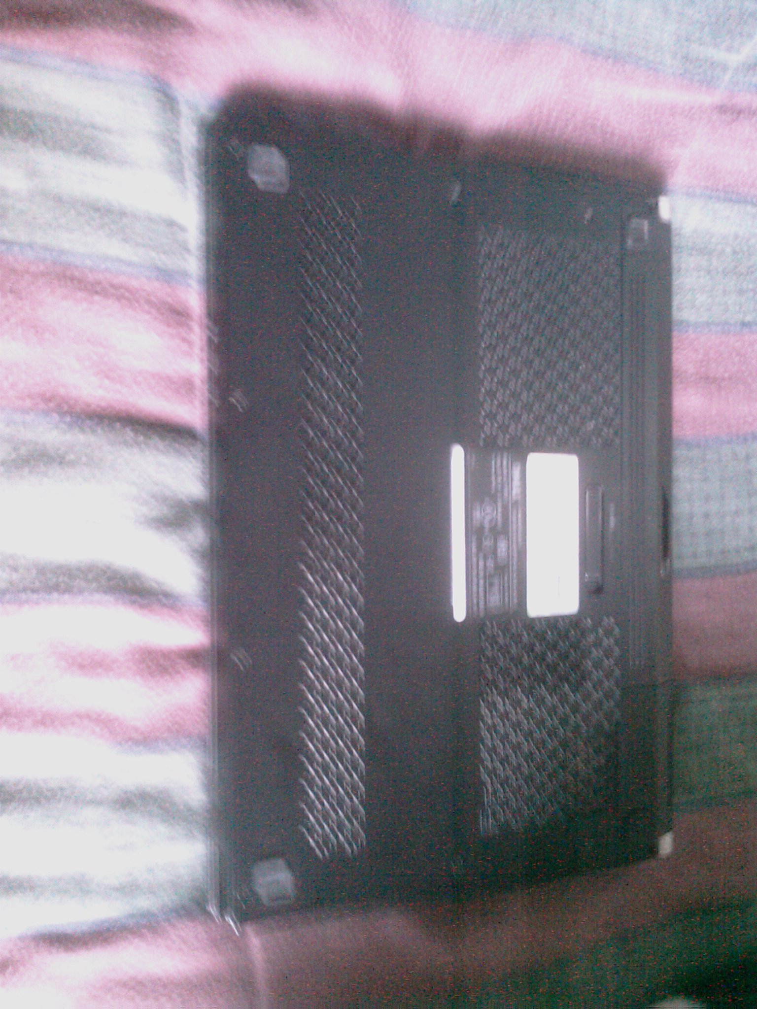

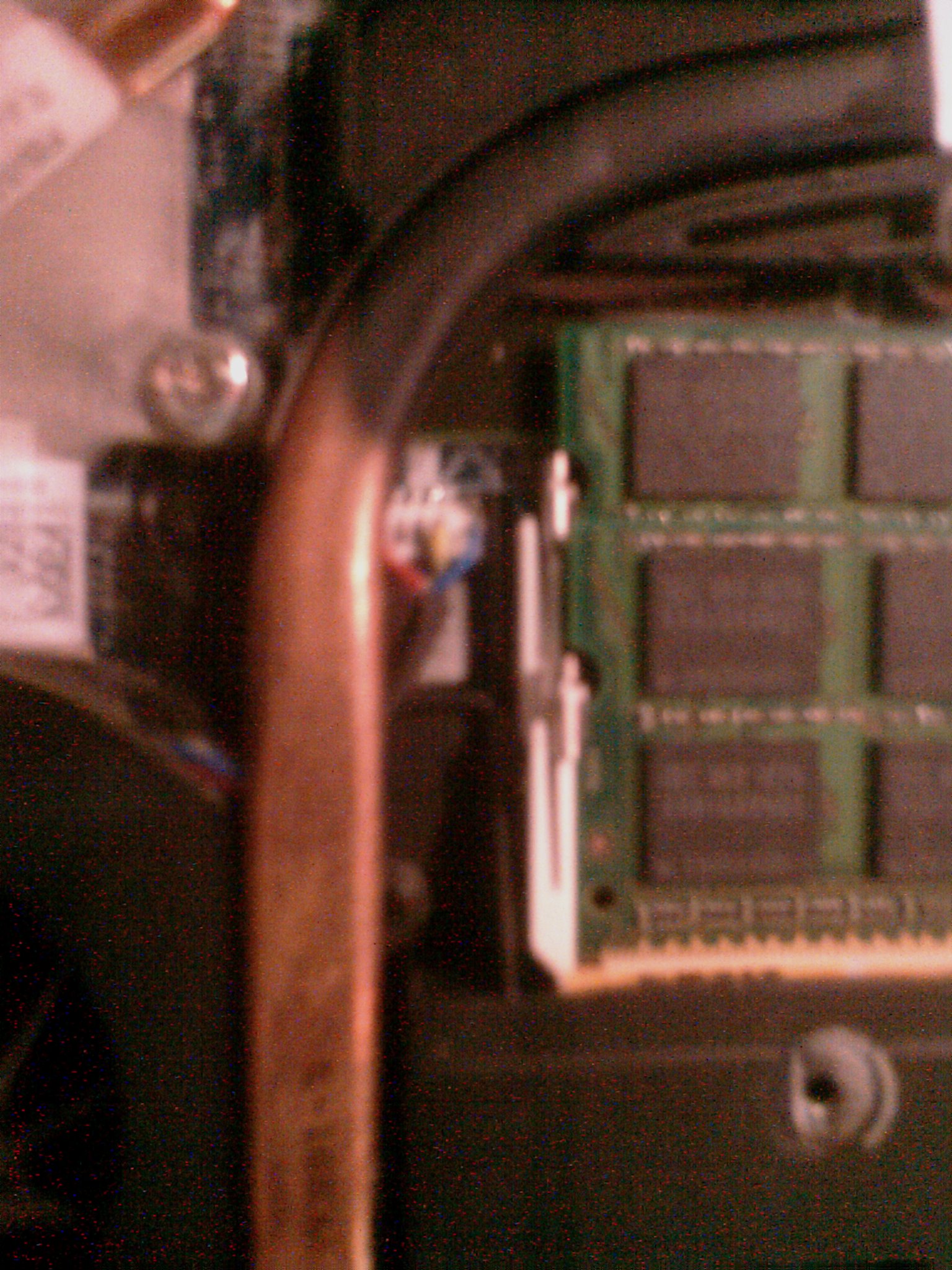

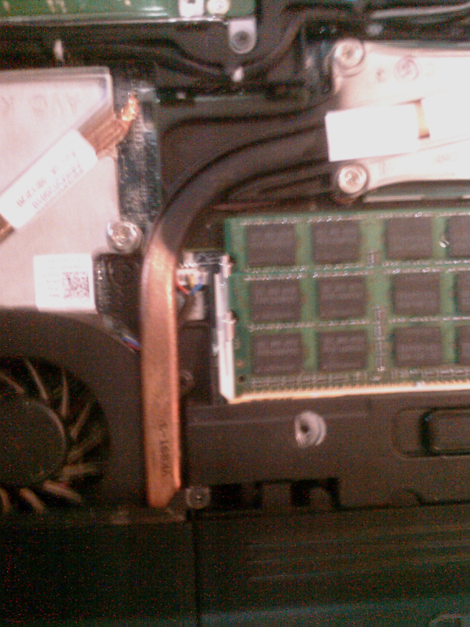

pmcnano Posted July 6, 2009 Share Posted July 6, 2009 Ok here is the ultra mini guide for the hard-mod of the cpu/gpu fan! Ok, first of all sorry for not rotating the pics before but anyway: First: you have your laptop upside down...: Then you take out all the screws: Then..well I was lazy to do it again, you have to take out all the heatsink, because there's no space to work with it in there...........but anyway you are aiming this mini plug: When you take out all the heatsink, you jsut unplug the miniplug..and with a pen or something you will press the metal part in the side of the miniplug (blue wire) that will make it possible to take out the cable......After pressing that metal part, just get some nippers and pull the cable... You should get something like this: As you can (barely) see the blue cable is unplugged and in a side. With that the fan will be at fullspeed all the time and your laptop will be cooler. If you need any other detailed explanation let me know! Cheers Nano Link to comment https://www.insanelymac.com/forum/topic/161650-dell-xps-1340-mostly-working-with-osx-10561057/page/14/#findComment-1193836 Share on other sites More sharing options...

Gambit642 Posted July 7, 2009 Share Posted July 7, 2009 Ok here is the ultra mini guide for the hard-mod of the cpu/gpu fan! Dell + NVidia = My favorite is still the m1330 : http://forum.notebookreview.com/showthread.php?t=268081 ...I suspect you're doing something wrong with installing the kext, like failing to rm -rf /System/Library/Caches That's required? ...I don't see anything obviously wrong there. I am still in vote for a debug of the old HDA unload issue. Less fluff and nice audio. Link to comment https://www.insanelymac.com/forum/topic/161650-dell-xps-1340-mostly-working-with-osx-10561057/page/14/#findComment-1194153 Share on other sites More sharing options...
