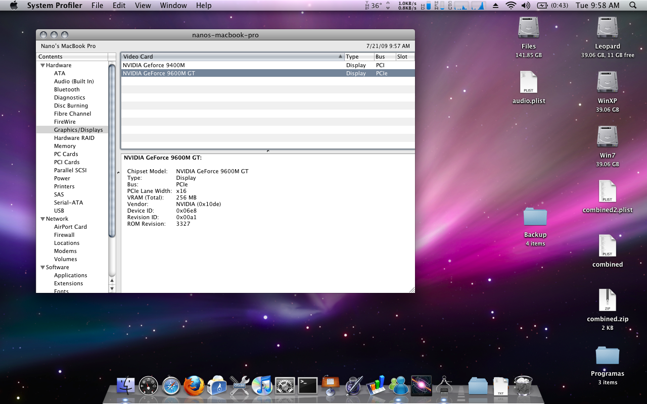

pmcnano Posted July 21, 2009 Share Posted July 21, 2009 Just tried it........same as before, black screen, it freezes! Im going to take a shower, but I ll try just putting the 9400m dev id so at least it works for that one! Thanks for trying!! edit: I was reading in old posts, you asked me to inject part by part too see whats the problem, I dont know if I ever tell you about it, look, wrong name (lazy to changed it) but: I used this plist: combined2.plist.zip As you can see (if compared with the one I atached two or three posts ago) the only change is that I deleted the "name" keys: <key>@0,name</key> <string>NVDA,Display-A</string> and <key>@1,name</key> <string>NVDA,Display-B</string> What do you think? I dont think the problem has to do with the injection, it has to do with the cards management, which happens in the "energy saver" preferences panel, but....I dont know how does that work! Link to comment https://www.insanelymac.com/forum/topic/161650-dell-xps-1340-mostly-working-with-osx-10561057/page/16/#findComment-1205312 Share on other sites More sharing options...
pratik.np Posted July 21, 2009 Share Posted July 21, 2009 What do you think? I dont think the problem has to do with the injection, it has to do with the cards management, which happens in the "energy saver" preferences panel, but....I dont know how does that work! the plist that you attached b4 had a mistake in the devicepath.... you used 'c' instead of '0c' if i am not wrong... and i corrected that and used it.. but same thing.... even with these new injector today no luck... but thanks bcc9... thanks for the try... and abt the two cards.. i mentioned this a long time ago... but i guess was overlooked.... leopard has no way of using the two cards together.... either 9400m or 9200m gs... no sli... so may be they desinged the hardware to use the internal display outputs from both cards... however ours was made for sli... infact dell makes this as a powerful point... so in our laptop its either 9400m or 9400m + 9200m gs... so wat if the internal display was connected to only 9400m and the 9200m gs is using the output through 9400m...??? i am not computer hardware expert but this is possible... right??? i tried using the nvinject without changing the probescore and with changing.... no luck.... but i did get one thing.... instead of using the universal dev id 000010de i used the individual dev id, for both them cards.... first i used only 9400m and i dont remember exactly whether got it working completely or not... but atleast i was able to get the properties changed.... then 9200m gs... same black screen... but in safe mode... the system profiles did accept the changes acc to the kext.... but still its showed only one display only connected to the other graphic adapter... which brings me to my point again.... wat if only 9400m has internal display attachments!!! well enough of speculations... i am gonna open my laptop... ne advice?? Link to comment https://www.insanelymac.com/forum/topic/161650-dell-xps-1340-mostly-working-with-osx-10561057/page/16/#findComment-1205410 Share on other sites More sharing options...
pmcnano Posted July 21, 2009 Share Posted July 21, 2009 Im not sure if its how you say, afaik you can use MBP's dual cards with hybrid sli under windows. Though, it sounds possible, that 9200 doesnt have an output at all, but again, I posted some time ago persons with a HP laptop with the same graphic card having the same problem. And, well go ahead opening your laptop, though im not sure you can find out anything just by watching! good luck Link to comment https://www.insanelymac.com/forum/topic/161650-dell-xps-1340-mostly-working-with-osx-10561057/page/16/#findComment-1205447 Share on other sites More sharing options...
pratik.np Posted July 21, 2009 Share Posted July 21, 2009 Im not sure if its how you say, afaik you can use MBP's dual cards with hybrid sli under windows. Though, it sounds possible, that 9200 doesnt have an output at all, but again, I posted some time ago persons with a HP laptop with the same graphic card having the same problem. And, well go ahead opening your laptop, though im not sure you can find out anything just by watching! good luck you were right... couldn't figure out nething... hahaha... i just opened the thing and closed it back in a few seconds.... and may be 9200m gs cant work under os x altogether seeing that ppl with only one card also have a problem.... and yeah the macbook can use them in sli in windows even if 9600 is not totally dependent on 9400 for output... the real question is can windows on mbp run just 9600 and disable 9400 totally and still get output.. the combined.plist that you had uploaded for me.... did you write the entries yourself....?? Link to comment https://www.insanelymac.com/forum/topic/161650-dell-xps-1340-mostly-working-with-osx-10561057/page/16/#findComment-1205480 Share on other sites More sharing options...
pmcnano Posted July 21, 2009 Share Posted July 21, 2009 Which one? the 1 or 2? Anyway lol I took the entries from the MBP, thats all the entries it has, and the only entries that breaks them is the keys "name" as I copy pasted before. Link to comment https://www.insanelymac.com/forum/topic/161650-dell-xps-1340-mostly-working-with-osx-10561057/page/16/#findComment-1205499 Share on other sites More sharing options...
bcc9 Posted July 21, 2009 Author Share Posted July 21, 2009 Which one? the 1 or 2? Anyway lol I took the entries from the MBP, thats all the entries it has, and the only entries that breaks them is the keys "name" as I copy pasted before. So on the real macbook pro with 9600m those entries exist on the secondary video pci device in the ioregistry. So I'd think they'd be required on the 9200m device as well. I really thought it'd work this time. Link to comment https://www.insanelymac.com/forum/topic/161650-dell-xps-1340-mostly-working-with-osx-10561057/page/16/#findComment-1205618 Share on other sites More sharing options...
pratik.np Posted July 21, 2009 Share Posted July 21, 2009 Which one? the 1 or 2? Anyway lol I took the entries from the MBP, thats all the entries it has, and the only entries that breaks them is the keys "name" as I copy pasted before. is that so.... the name keys are the info abt the displays attached to 9200m gs right??? but what if there are none... this is wat a guy wrote on the apple suport forum: "With the certainty of revealing my ignorance, can someone tell me when is the 9600 used vs 9400? Whenever I look at system profiler is always says no display connected to the 9600. And if two displays, both connected to the 9400. Does it only work with certain types of displays? or applications? or connections? NVIDIA GeForce 9600M GT:"" am trying without ne display entries.... will update Link to comment https://www.insanelymac.com/forum/topic/161650-dell-xps-1340-mostly-working-with-osx-10561057/page/16/#findComment-1205633 Share on other sites More sharing options...
pmcnano Posted July 21, 2009 Share Posted July 21, 2009 Dont worry, it was a good try anyway. So I dont know where to continue with the dual graphic matter. Anyway, as I said a while go, I was reading all the thread again and I found this post where you say your cpu was working at 800mhz with some thread. Its just, I was wondering why is the batterylife difference under windows and osx sooo big. I mean I get almost 5 hours with this new battery under windows, but only 3 in osx ...lol Maybe its not the cpu could be that I guess. is that so.... the name keys are the info abt the displays attached to 9200m gs right??? but what if there are none... this is wat a guy wrote on the apple suport forum:"With the certainty of revealing my ignorance, can someone tell me when is the 9600 used vs 9400? Whenever I look at system profiler is always says no display connected to the 9600. And if two displays, both connected to the 9400. Does it only work with certain types of displays? or applications? or connections? NVIDIA GeForce 9600M GT:"" am trying without ne display entries.... will update Ok, LMAO that dude, bought a MBP and he doesnt even know how to use it, he has to change the power profile to performance mode. I just used a MBP a week ago, it wont show any displays (the 9600GT) when in "Better battery life". When you switch to performance mode, it will logout, restart display (go black and come back again) and you have to login again, after that 9400M has no displays and 9600M GT has both displays. Hope that helps.. Link to comment https://www.insanelymac.com/forum/topic/161650-dell-xps-1340-mostly-working-with-osx-10561057/page/16/#findComment-1205636 Share on other sites More sharing options...
pratik.np Posted July 21, 2009 Share Posted July 21, 2009 Ok, LMAO that dude, bought a MBP and he doesnt even know how to use it, he has to change the power profile to performance mode. I just used a MBP a week ago, it wont show any displays (the 9600GT) when in "Better battery life". When you switch to performance mode, it will logout, restart display (go black and come back again) and you have to login again, after that 9400M has no displays and 9600M GT has both displays. Hope that helps.. well exactly my point... i mentioned this thing abt the gpus being regulated with the battery(which we cant cuz we use a mod) on like the 13th page... but since i got no replies regarding that i guessed thats not the case... cuz i just get crazy ideas... i have not computer background, i am a med student... watever i know is from my interest... and i tried to use the plist without the name entries..... booted up fine... but no changes... but i guess you all already guessed that...lol Link to comment https://www.insanelymac.com/forum/topic/161650-dell-xps-1340-mostly-working-with-osx-10561057/page/16/#findComment-1205651 Share on other sites More sharing options...
pmcnano Posted July 21, 2009 Share Posted July 21, 2009 Yep, that plist just shows 9600GT in the pci-e line in system profiler! But no change. Also as I mentioned before, in the new MBP under system profiler and graphic cards the cards has this line that says Gmux version: 1.7xxxb la bla.... I think it has something to do with the dual card thing. Link to comment https://www.insanelymac.com/forum/topic/161650-dell-xps-1340-mostly-working-with-osx-10561057/page/16/#findComment-1205725 Share on other sites More sharing options...
