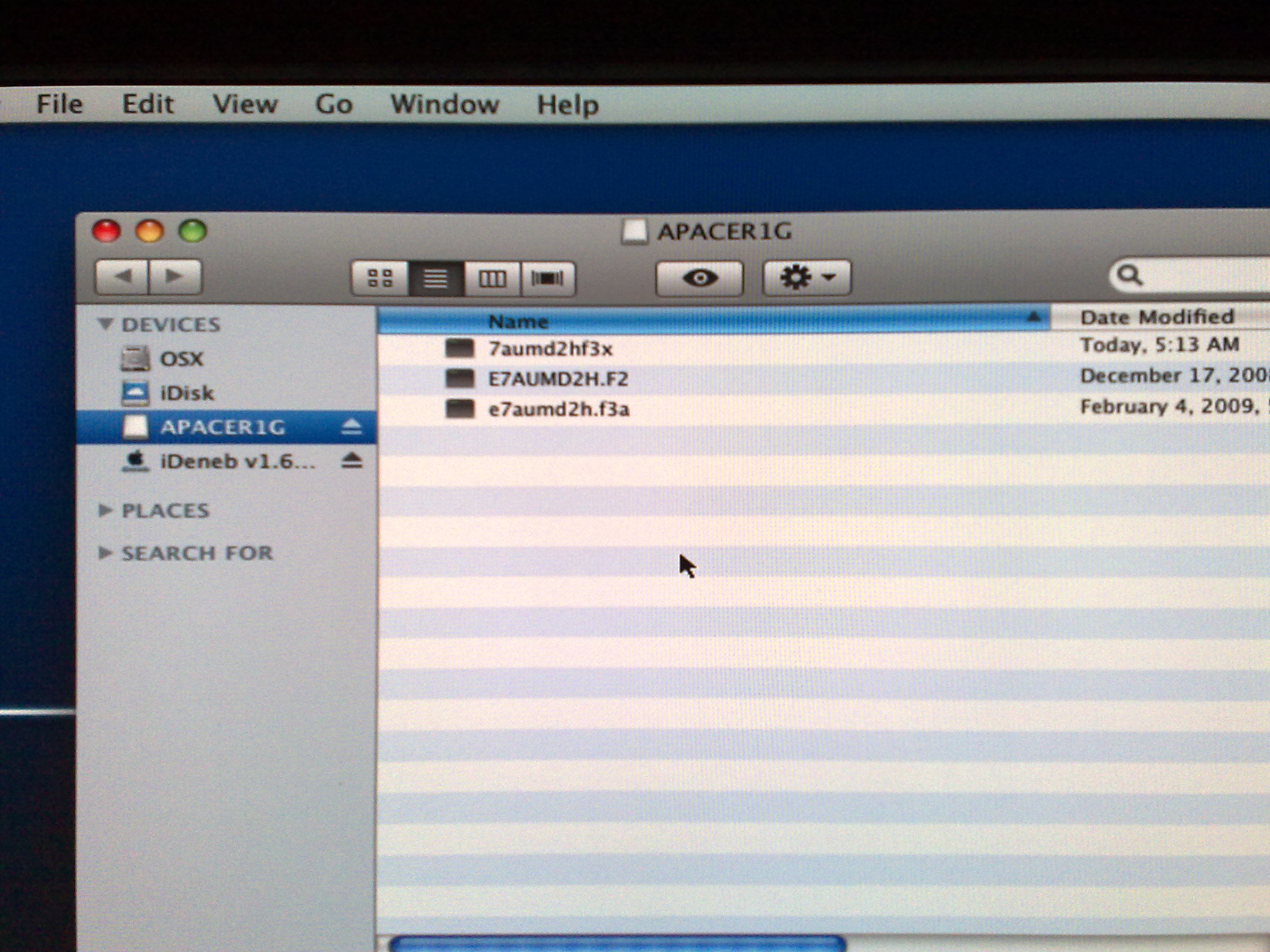

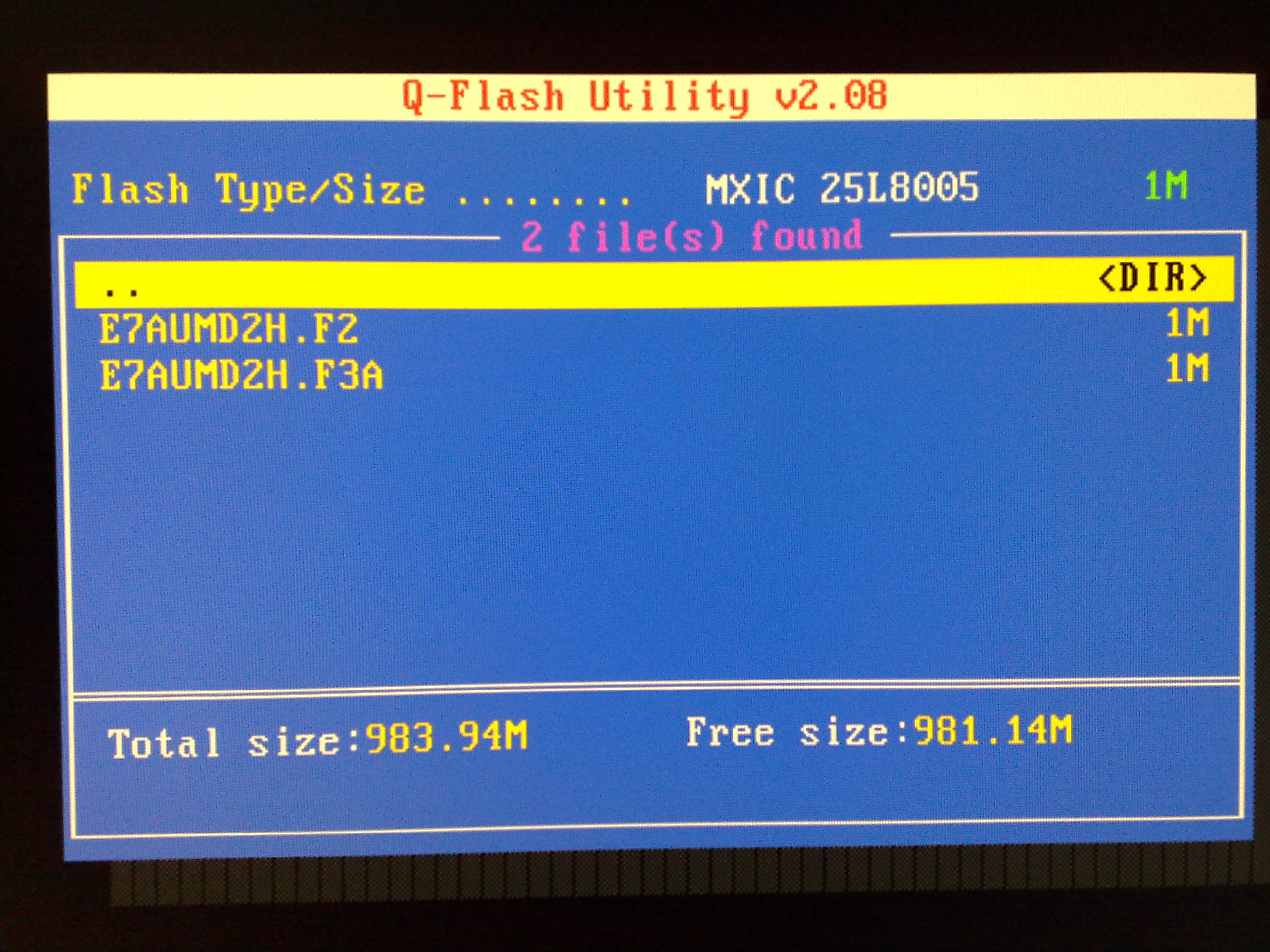

dlach Posted August 25, 2009 Author Share Posted August 25, 2009 Hi! I've got Koalala's bios file, but i can't load it with the Qflash: it doesn't show this file on the flash card (other bios files like original f3a or saved from Qflash to the same disk are there and can be choosed). I've noticed the size difference between original f3a and Koalala's. The orihinal is a 1 megabyte and Koalala's is 503 Kb. Is there any trick to update? Thanks in advance. Koalala's is 1MB if you uncompress it. If you tried to install it without uncompressing it would explain your problem. I used stuffit. Link to comment https://www.insanelymac.com/forum/topic/161348-guide-installing-snow-leopardleopard-retail-dvd-on-the-ga-e7aum-ds2h/page/2/#findComment-1234606 Share on other sites More sharing options...
driveparty Posted August 25, 2009 Share Posted August 25, 2009 Koalala's is 1MB if you uncompress it. If you tried to install it without uncompressing it would explain your problem. I used stuffit. Hi! I've uncompressed it on Vista 32, it was 503Kb uncompressed (Winrar). When i did in under Mac os it became ok (1M). Thank's for attention Link to comment https://www.insanelymac.com/forum/topic/161348-guide-installing-snow-leopardleopard-retail-dvd-on-the-ga-e7aum-ds2h/page/2/#findComment-1234649 Share on other sites More sharing options...
dlach Posted August 25, 2009 Author Share Posted August 25, 2009 Hi!I've uncompressed it on Vista 32, it was 503Kb uncompressed (Winrar). When i did in under Mac os it became ok (1M). Thank's for attention Excellent. Yet another of the many reasons to use OSX. Good luck with the install. Link to comment https://www.insanelymac.com/forum/topic/161348-guide-installing-snow-leopardleopard-retail-dvd-on-the-ga-e7aum-ds2h/page/2/#findComment-1234961 Share on other sites More sharing options...

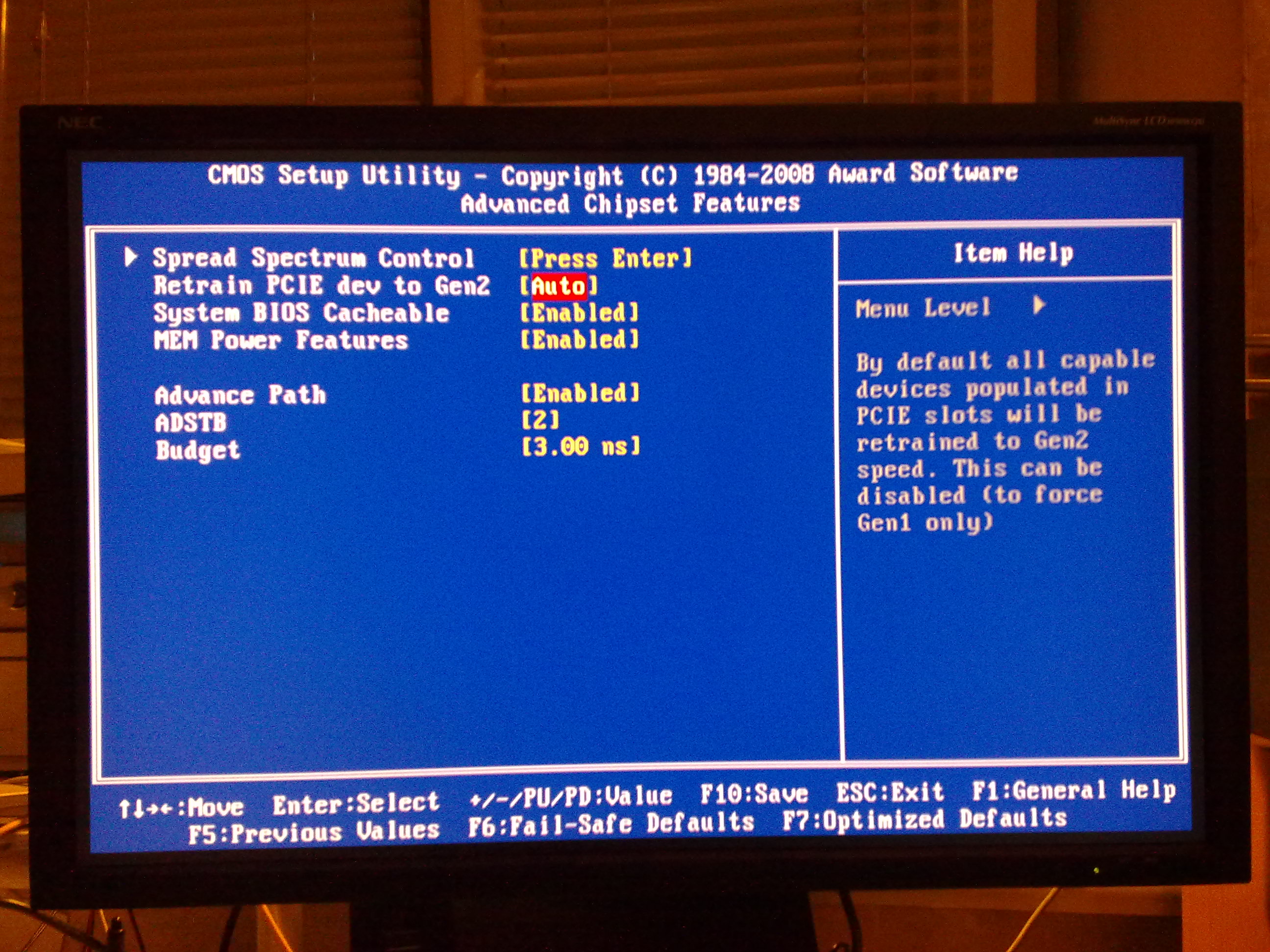

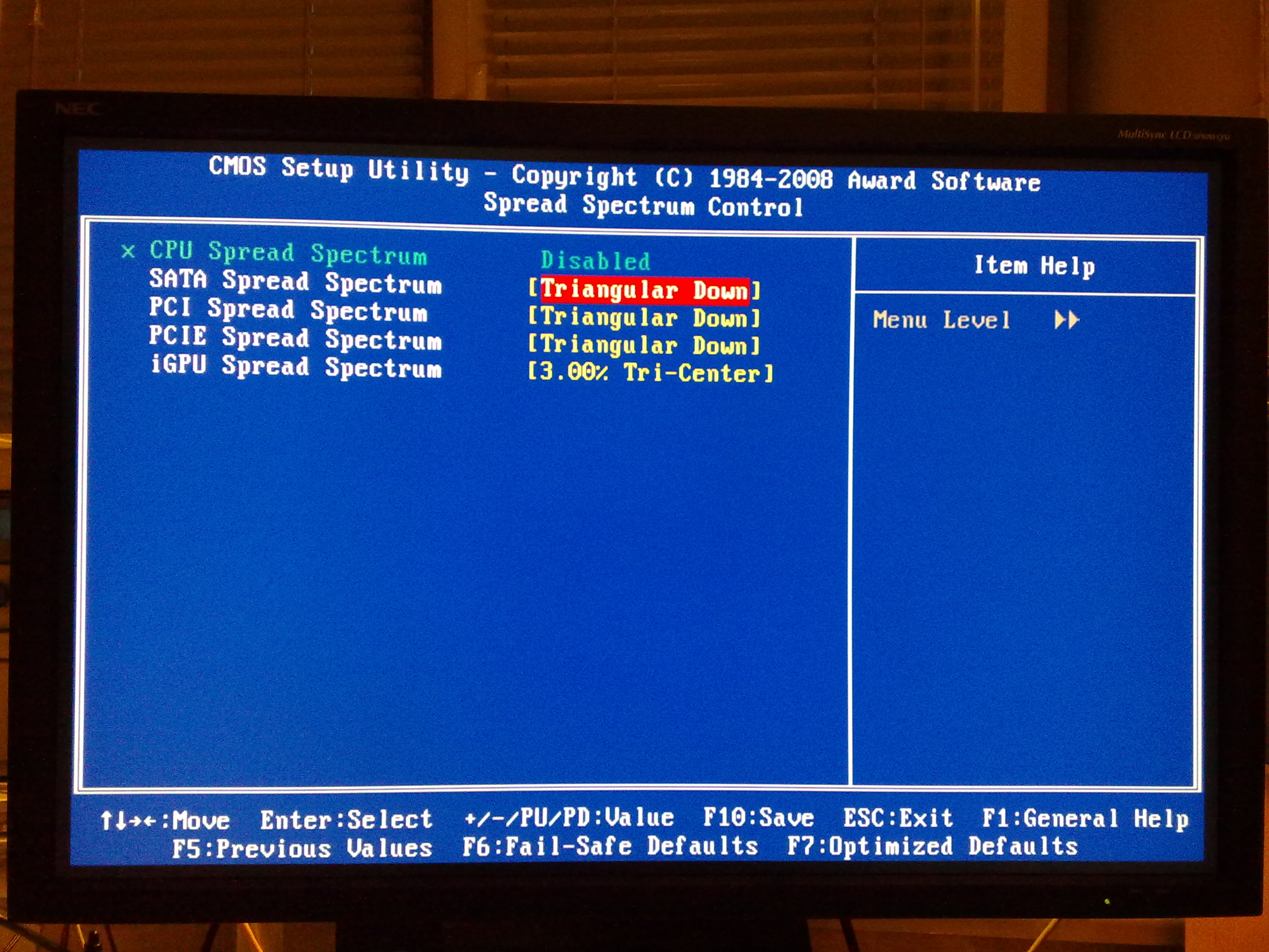

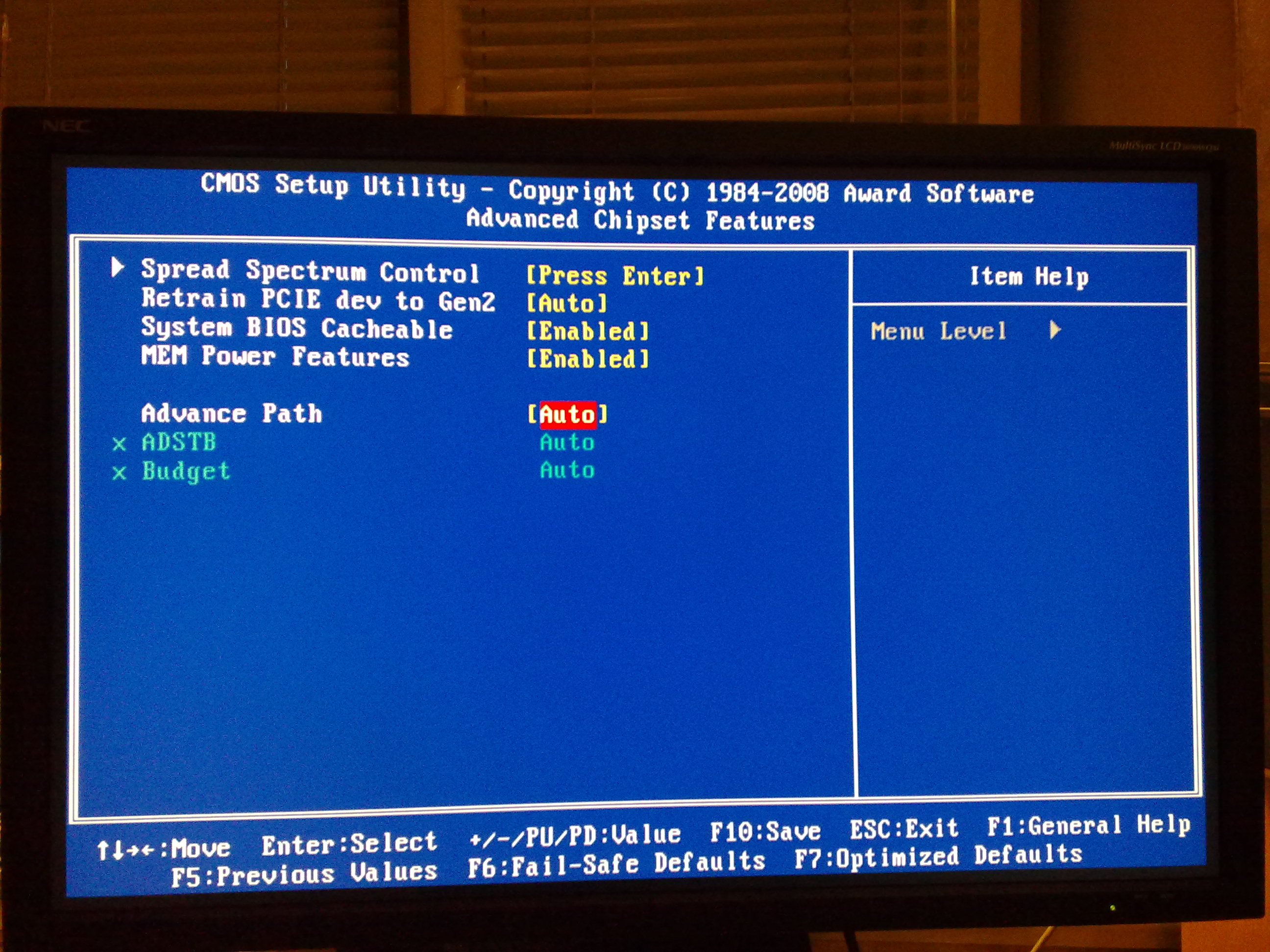

driveparty Posted August 25, 2009 Share Posted August 25, 2009 Installing a retail 10.5.6 DVD on the GA-E7AUM-DS2HLast Updated: 08/09/09 Any help with the sleep issues and 2GB limit welcome. Hi. I wonder if it's a real help, but it may be a begining of some new investigations on 2GB limit. There is a hidden menu in Gigabyte's BIOS setup. The manual does not explain it's options meaning, but in the section of FAQ it sais: Q:In the BIOS Setup program, why are some BIOS options missing? A: Some advanced options are hidden in the BIOS Setup program. Press <Delete> to enter BIOS Setup during the POST. In the Main Menu, press <Ctrl>+<F1> to show the advanced options. So i did it and i've seen this (see attached images). Any ideas if it can bdice used and which way? Or their meaning...? Link to comment https://www.insanelymac.com/forum/topic/161348-guide-installing-snow-leopardleopard-retail-dvd-on-the-ga-e7aum-ds2h/page/2/#findComment-1235516 Share on other sites More sharing options...
