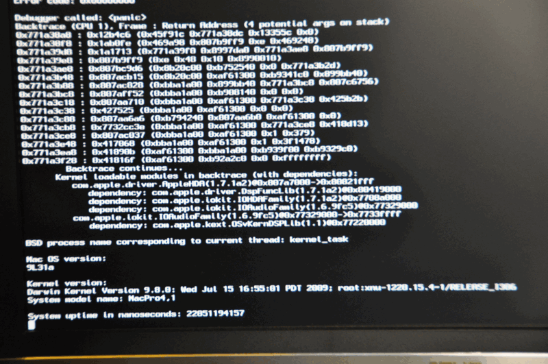

HELP!!! I used DD's method to setup my Hack and everything has been great for months. Then I noticed a problem with sound output in Ichat, so I tried repairing permissions and changed the output audio to another line-out. That worked, but the next day when I went to turn on the machine, I get kernel panic. I have no idea what I did. I even tried to reinstall everything using the same method on a totally different hard drive and I still get the same thing. That leads me to think that something happened with the hardware, but I have no idea of where to look.
I have 6 2GB sticks of RAM, and I tried swapping them in and out to see if one of them might have gone bad, but I always get the same error.
I can boot up the machine in safe mode using "-x" at the boot prompt, but that's as far as I've gotten.
I hope someone can help me. This has been a perfect machine up till now. ALEX
Here is a photo of the error.

An improperly installed sound kext is causing a KP. Do you have a headphone connected to one of the audio out jacks? That will cause a KP.

You were exactly right of course. The problem is I messed up my install so much trying to figure out what was wrong. I decided to go back and reinstall everything.

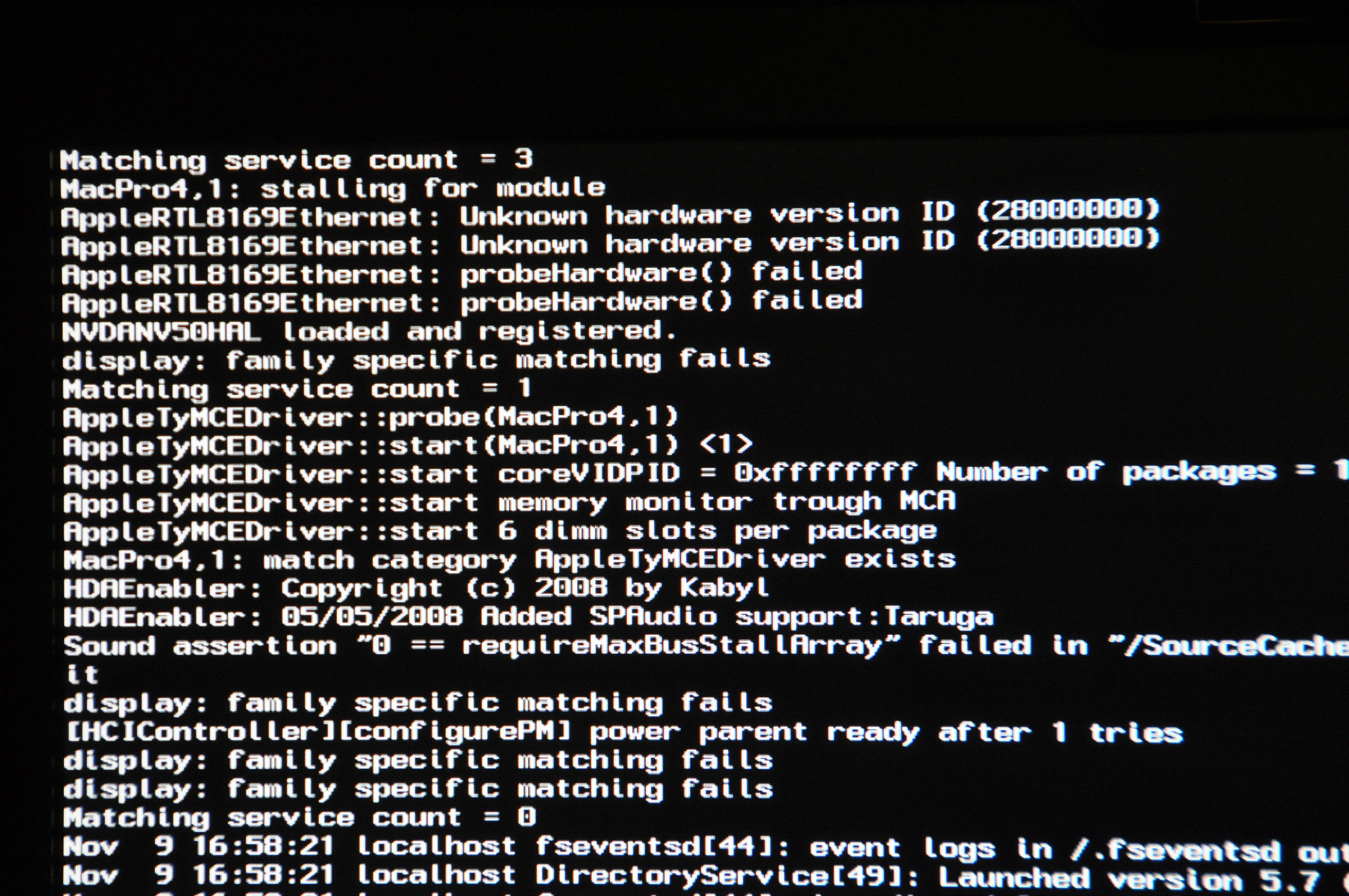

I checked the ports again, and they are working. I have an iDeneb setup for installing the main system and when I boot into that, I can see both ports recognized and working.
I also went into the BIOS and tested both ports. Both gave me cable lengths.
I did this exact same setup with the previous version of the installer, and it was working great.
Do you have the previous version of your installer available for download?
I'm installing from a retail 10.5.2 disc, then updating using the 10.5.8 combo update.
Here is a photo of the boot up.

OK. It's working now. Someone else had the same problem and they used kext helper b7 to reinstall the ionetworkingfamily.kext.

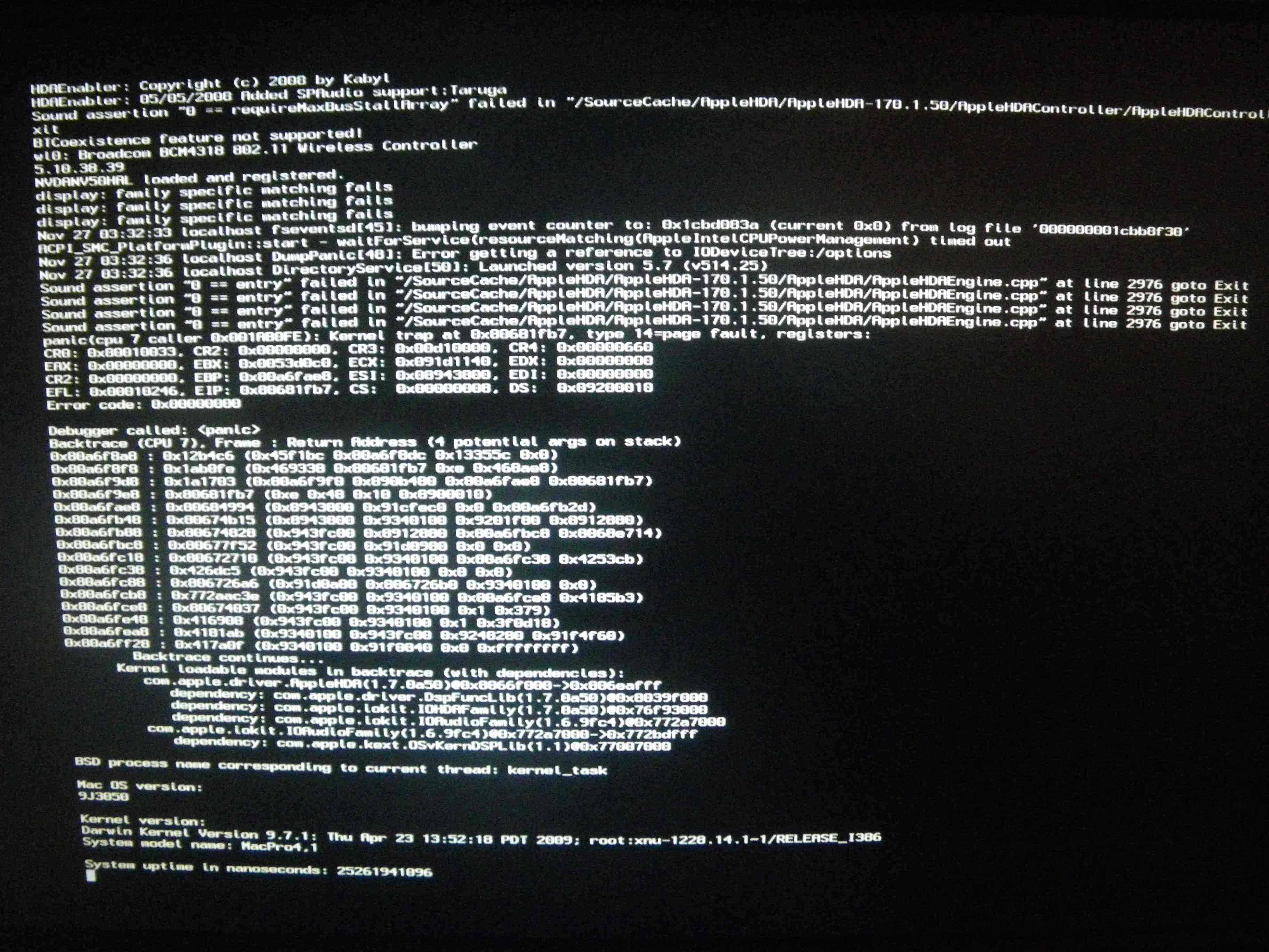

I've been trying to get a working 10.5.8 for some time now. Basically, my hang up is audio. I've done a retail 10.5.6 -> combo update 10.5.8 with the new chameleon in DD's new script using a Mac. I removed the ATY_init and used EFI for my 7600gt card.
When booting I get a KP complaining about the HDA files - remove them and I get perfect boot but no audio. I installed the AppleHDA for the UD3R from the repository to the /system using the script - system boots - no audio.
Seems like this would be a simple one, but I've read a ton of posts and can't seem to find a solution. Your help would be greatly appreciated!
Resolved Sound. I realized I didn't have my speakers plugged in. I added the HDAEnabler.kext and LegacyHDA.kext using the DD's 4.22 script with the kext/kernel install. Seem to work. I updated system in to 10.6.2 using the Apple update. That is sweet, I never expected to be able to do that! Graphics appear to be running fine.
