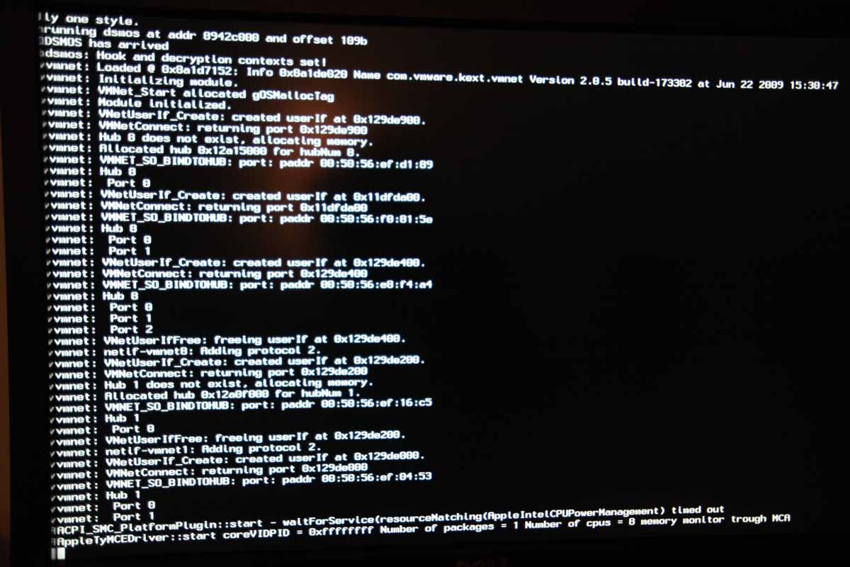

bbchucks Posted September 3, 2009 Share Posted September 3, 2009 I've tried the /Extra install method from DD's 4.0 RC script but i couldn't even boot, just kept getting KP errors. After i changed the method to EFI partition, it loads up to the Below Screenshot and just gets stuck/hung i'm using -v -x32 to boot up... does anyone know why i'm getting stuck/hung? and Link to comment https://www.insanelymac.com/forum/topic/149505-guide-retail-os-x-install-1058-on-gigabyte-ga-ex58-ud5-core-i7-mobo/page/114/#findComment-1248897 Share on other sites More sharing options...
miketress Posted September 3, 2009 Share Posted September 3, 2009 How did you install it?Did you use DD's script? Is Snow with RC2 your main aktive partition or do you have another partition with Leo and RC2? Did you use Netkas Boot 10.2? Where did you put the other Kexts the Disabler.kext or sleepenabler.kext? Thanks I did a clean install, and then used DD's script but replaced the RealtekR1000.kext . Snow is the only partition on is GUID disk, so it's the main active partition. I don't boot Leo anymore.. All the other kexts are in /Extra. Mike Link to comment https://www.insanelymac.com/forum/topic/149505-guide-retail-os-x-install-1058-on-gigabyte-ga-ex58-ud5-core-i7-mobo/page/114/#findComment-1249071 Share on other sites More sharing options...

miketress Posted September 3, 2009 Share Posted September 3, 2009 I've tried the /Extra install method from DD's 4.0 RC script but i couldn't even boot, just kept getting KP errors.After i changed the method to EFI partition, it loads up to the Below Screenshot and just gets stuck/hung i'm using -v -x32 to boot up... does anyone know why i'm getting stuck/hung? and Try changing MacPro4,1 to MacPro3,1 in /Extra/smbios.plist, that fixed this for me.. Mike Link to comment https://www.insanelymac.com/forum/topic/149505-guide-retail-os-x-install-1058-on-gigabyte-ga-ex58-ud5-core-i7-mobo/page/114/#findComment-1249981 Share on other sites More sharing options...

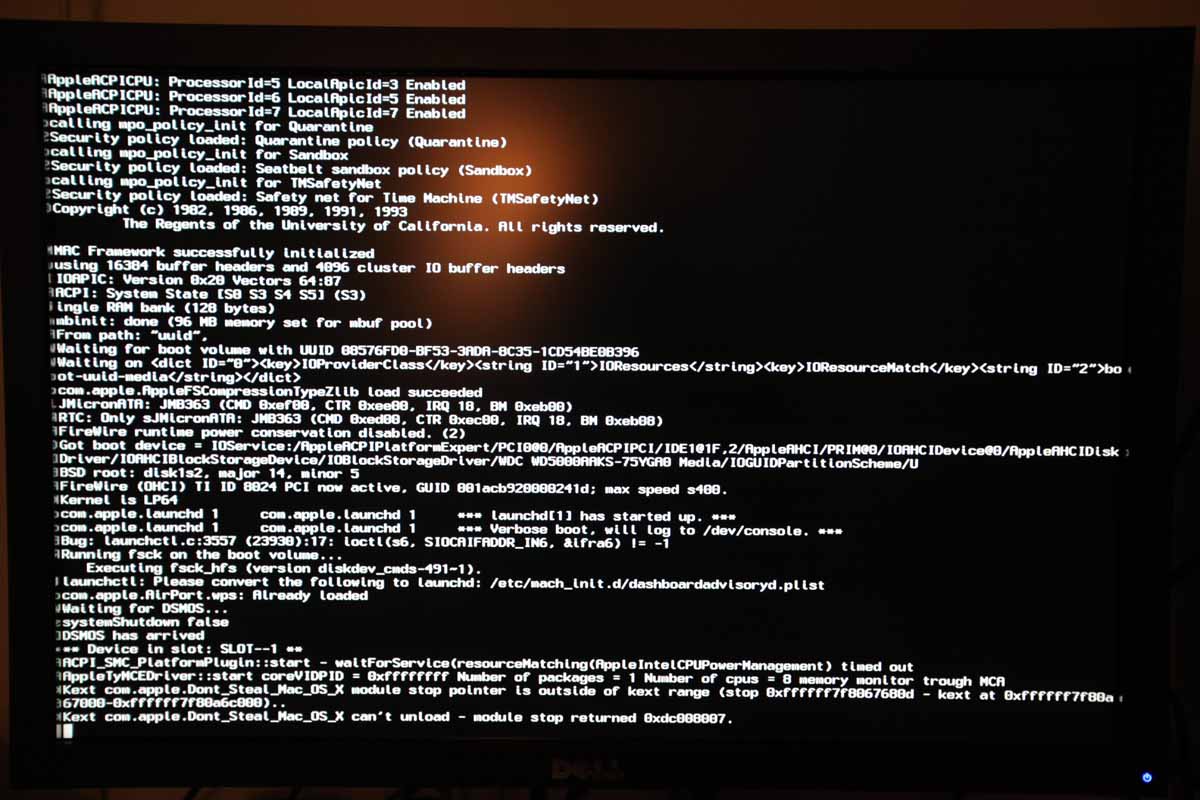

morganpl Posted September 4, 2009 Share Posted September 4, 2009 do you have during boot snow info: Please convert the following lunchchd /etc/mach_init.d/dashboardadvisoryd (I hope I remember it well ..) when boot system stops for a few seconds, later boot normal....? A few pages back someone posted saying they had a fully-functional 64 bit install including network. Has anyone else gotten this to work? I downloaded his kext folder, swapped the realtekr1000 kext with the one from DD's 4.0 script, and rebooted, but it yielded a new detected ethernet port, but no IP address, so I'm not sure what combination of stuff actually works. Any other success stories out there? I have the same Link to comment https://www.insanelymac.com/forum/topic/149505-guide-retail-os-x-install-1058-on-gigabyte-ga-ex58-ud5-core-i7-mobo/page/114/#findComment-1250782 Share on other sites More sharing options...
