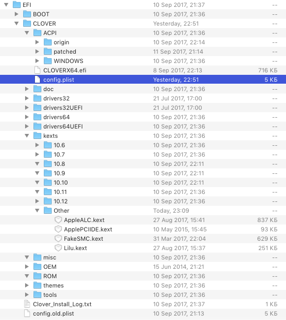

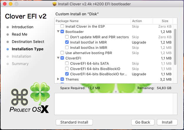

In case any1 is interested, I had a success installing Sierra on this board. Stock BIOS 519, no custom DSDT, Clover bootloader, vanilla System folder.
My rig: Core 2 Duo E7500, 4 Gb RAM, no external video, SATA disk 80 Gb, IDE DVD-RW drive, cheap CSR USB Bluetooth dongle.
Audio is working with Lilu and AppleALC and IDE DVD need ApplePCIIDE.kext from this post. Everything else is just Clover config.plist.

  • 1 month later...
Can you tell me the BIOS settings?
It's blinking an underscore in Clover r4268
(Sorry for my poor English...)
