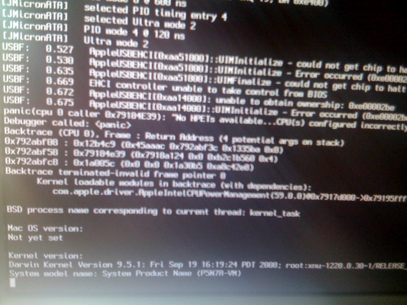

chach Posted January 30, 2009 Share Posted January 30, 2009 Hey Everybody, I pulled the trigger and got the P5N7A and I've been trying to get OS X installed. I've been using Lokoh's method of installation using my unibody MBP, the unibody MBP restore disc, modified OSInstall.mpkg, & an external USB disk as detailed here. Only thing I changed was that i used the dldt for the Asus board rather than the Gigabyte board. When I plug the USB drive back into my Asus motherboard and attempt to boot I get a kernel panic. So I've been trying to figure out what has been causing the panic. The logical thing to do was use the "-v" boot option, but everytime I do that and the system starts to boot it seems to hang at "BSM auditing present". I attached a picture of my screen that i took with my iPhone. So two questions - 1. Anybody know why I might be getting the kernel panic? 2. How can I get this thing to boot correctly in verbose mode? I assume if I was doing it right then I'd see the kernel panic on the console. Thanks in advance! UPDATE: Got it to boot in verbose mode by adding -v to com.apple.boot.plist. The kernel panic seems to be related to AppleIntelCPUPowerManagement.kext. 2nd screenshot of console attached. Would love some help on this.. Thanks. UPDATE 2: I just decided to trash the AppleIntelCPUPowerManagement.kext and now the system doesn't panic, but I'm stuck at "Still waiting for the root device". I had this happen before but I can't remember how I fixed it. I'm using a SATA II disk that is connected to the first SATA port on the board. Link to comment https://www.insanelymac.com/forum/topic/148416-asus-p5n7a-vm/page/5/#findComment-1062800 Share on other sites More sharing options...
chach Posted January 30, 2009 Share Posted January 30, 2009 I just decided to trash the AppleIntelCPUPowerManagement.kext and now the system doesn't panic, but I'm stuck at "Still waiting for the root device". I had this happen before but I can't remember how I fixed it. I'm using a SATA II disk that is connected to the first SATA port on the board. Ok, I figured this out. Probably a good tip worth posting for other users of this motherboard. In order to boot from a SATA drive, you must have your drive plugged into either the of the two black SATA ports as these are the only SATA ports that support AHCI. Lastly, go into the BIOS settings and enable AHCI on the first page under "Storage Settings". Hope this helps and thanks to everybody on this thread for all of their hard work on getting this board going. Link to comment https://www.insanelymac.com/forum/topic/148416-asus-p5n7a-vm/page/5/#findComment-1062926 Share on other sites More sharing options...

2006C6 Posted January 31, 2009 Share Posted January 31, 2009 make sure when you first are booting from the dvd you hit F8 for boot options - enter cpus=1 this will allow you to install. Once installed and before you reboot, copy Diabolik's DSDT.aml to your root on your boot drive. The with UInstaller choose "OSx86 essentials" and check apply kext. Check "Set boot time out to 5 seconds" You shouldn;t have to re-install EFI v9, but if it doesn't boot go ahead and do so. This should get you going - This is thanks to Lokah Hi all,My total inexperience is leading to a chicken/egg problem here... The noob guides aren't specific to this board, so I get problems installing, but the steps outlined here are still a mite too advanced for me. Anyone mind breaking things down for this poor soul? I've tried both the iDeneb and the iPC distributions (burned to DVD), but can't get past the initial loading screen. The iPC distro prompts me for flags and then reboots after whatever I seem to try. iDeneb is a bit more promising...the white apple screen loads, the wheel spins for a few minutes, and a circle with a line through it (think no smoking signs) starts blinking at me. Help? -malfet Link to comment https://www.insanelymac.com/forum/topic/148416-asus-p5n7a-vm/page/5/#findComment-1063835 Share on other sites More sharing options...

Cybex Posted February 1, 2009 Share Posted February 1, 2009 Thanks for the tip. I checked the setting and it was auto. When I enabled USB Legacy mode it worked Thanks! Correction: When I changed USB from FullSpeed to Highspeed it worked! So now I got Leopard booting with cpus=1, dunno if I still need to do that. I'll check that later. Booting without cpus=1 worked great, Leopard sees 2 CPU's now (Core 2 Duo e8200) I'm facing 2 problems still: - Sata controller is an unknown AHCI controller. I saw screenshots that it should appear as an Nvidia Controller? - No VGA hardware acceleration yet... Thank you Diabolik for NVKush!! - Optical / SPDIF out audio Link to comment https://www.insanelymac.com/forum/topic/148416-asus-p5n7a-vm/page/5/#findComment-1064545 Share on other sites More sharing options...
