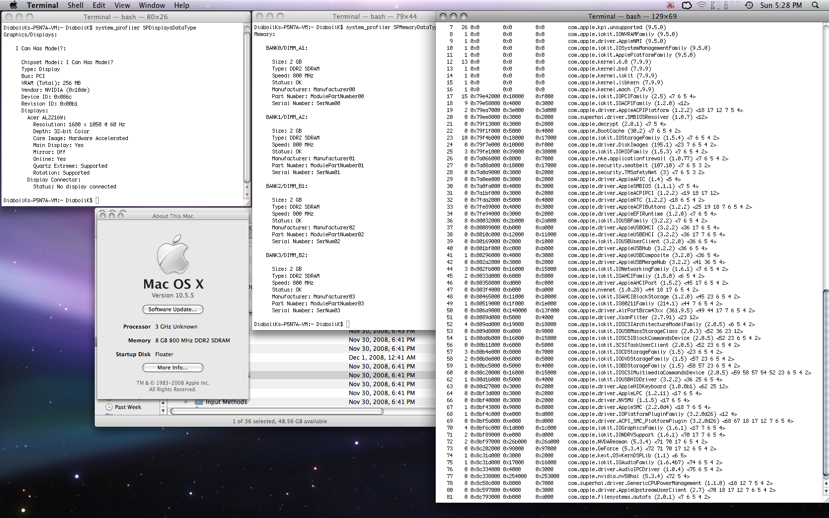

DiaboliK Posted February 9, 2009 Author Share Posted February 9, 2009 Here's my update, Everything Still running perfectly : 8Gb ram (no crashes) 9300 with qe/ci/res sleep/wakes fine restarts and shuts down fine audio works optical and analog in/out (i think, i still have to enable it) only non retail things i used are : nvkush, hdaenabler, genericcpupowermanagement, smbiosresolver, voodoo kernel, dsdt fix all things required to run perfect are qualified ram, an alu mb/mbp restoredisk or 10.5.6 retail disk. anything else is just {censored}, dont use it. -D- and a screenie Link to comment https://www.insanelymac.com/forum/topic/148416-asus-p5n7a-vm/page/7/#findComment-1074291 Share on other sites More sharing options...

Skyfluff Posted February 9, 2009 Share Posted February 9, 2009 Any chance you could link us to the kexts used? And is there anything special we should be doing with the NVkush installer? Or is it maybe something else, say, in the BIOS that's keeping us from getting hardware acceleration? Link to comment https://www.insanelymac.com/forum/topic/148416-asus-p5n7a-vm/page/7/#findComment-1074344 Share on other sites More sharing options...

Skyfluff Posted February 9, 2009 Share Posted February 9, 2009 Well that definitely didn't work. I used the kernel extensions from the 10.5.6 DVD and replaced the GeForce and NVDA files on my current install. It wiped out that stupid custom efi string I created, so that was nice, but I installed NVkush afterwards and it still didn't work. Probably because I was mixing extensions from multiple versions of the OS, who knows. I think I'll start from scratch with the retail 10.5.6 DVD and see how it goes. Wish me luck. By the way: gold star to anyone that gets the reference from post 161 Link to comment https://www.insanelymac.com/forum/topic/148416-asus-p5n7a-vm/page/7/#findComment-1074384 Share on other sites More sharing options...
sanetti Posted February 9, 2009 Share Posted February 9, 2009 Well that definitely didn't work. I used the kernel extensions from the 10.5.6 DVD and replaced the GeForce and NVDA files on my current install. It wiped out that stupid custom efi string I created, so that was nice, but I installed NVkush afterwards and it still didn't work. Probably because I was mixing extensions from multiple versions of the OS, who knows. I think I'll start from scratch with the retail 10.5.6 DVD and see how it goes. Wish me luck. By the way: gold star to anyone that gets the reference from post 161 My experience with 9300 : - First I removed NVinject.kext & NVinjectGo.kext - Then I installed NVKush and modified Info.plist as suggested by Diabolik. ( Many thanks Diabolik, great stuff!) - Modified Info.plist with my ID's in that kext : NVDA40.kext NVDA50.kext Geforce.kext NVKush.kext I was really lucky because I'm not an expert of kext modding.... Everything is perfect with my enhanced NVidia 9300, CI / QE & rotation. Link to comment https://www.insanelymac.com/forum/topic/148416-asus-p5n7a-vm/page/7/#findComment-1074513 Share on other sites More sharing options...
Skyfluff Posted February 9, 2009 Share Posted February 9, 2009 Thanks, Sanetti. I'll give that a try. In the meantime though, is there any chance you could attach the modded kexts to a post? Link to comment https://www.insanelymac.com/forum/topic/148416-asus-p5n7a-vm/page/7/#findComment-1074801 Share on other sites More sharing options...
Skyfluff Posted February 10, 2009 Share Posted February 10, 2009 OMG! Sweet, sugary success I sweat blood and tears over it this time, but managed to get it working with a 10.5.6 retail DVD. The NVkush installer wasn't working for me, so I added the one I made earlier with the modified NVcap through UInstaller and it worked! Strange thing is though, when I compare the Info.plist's between the NVkush installer's kext, and the one I added manually, they appear the same. Far as I can tell anyway. I'm not really too worried about it. It bothers me that I'm not 100% sure why it worked this time, but for the time being I'll restore my fully functional OS X install to another partition and restore from that if anything goes wrong. Edit: I can't get sound to work. I've been trying to use HDAenabler and FrodoKenny's AppleHDA like I have in the past, but it just won't work. I'm assuming this has something to do with the fact that I'm running 10.5.6 now instead of 10.5.5. Any ideas on that one, Diabolik? How did you get sound working with just HDAenabler? Also, not sure if it's of any concern, this is a new development for me after switching to the retail disc, but during the boot sequence I get a handful of messages telling me "iGPU: Matching specific family fails" or something like that. Video works fine though... Link to comment https://www.insanelymac.com/forum/topic/148416-asus-p5n7a-vm/page/7/#findComment-1075678 Share on other sites More sharing options...
