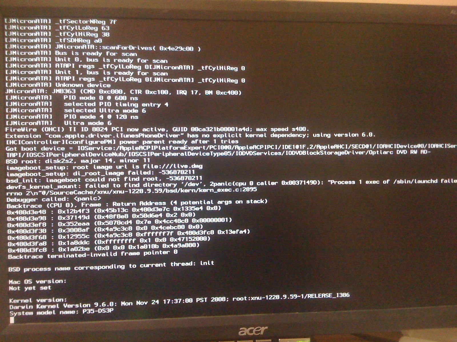

okay I managed to create a bootable boot-132 live dvd by using "hdiutil" in terminal:
Took all files off the boot-132 cd, and off the working "live os x" thumbdrive, and put them in a folder.
ran this command (change appropriate path names):
hdiutil makehybrid -o liveDVDe.iso /Volumes/Lacie\ 250\ 2/disk\ images/livedvdstuff/liveUSBboot132combo -eltorito-boot /Volumes/Lacie\ 250\ 2/disk\ images/livedvdstuff/liveUSBboot132combo/isolinux.bin   -no-emul-boot -verbose
then I took the image it produced, and burned it to a dvd.
It reached the darwin stage, and i typed in the commands "-f -v -s rp-file:///live.dmg"
It started to boot, but then kernel panicked with this image:
so it seems like the cd version of boot-132 doesnt support imageboot?
maybe?
