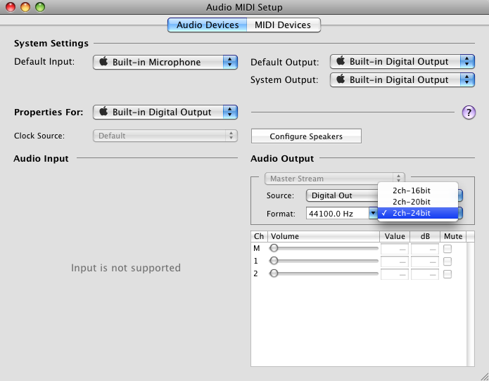

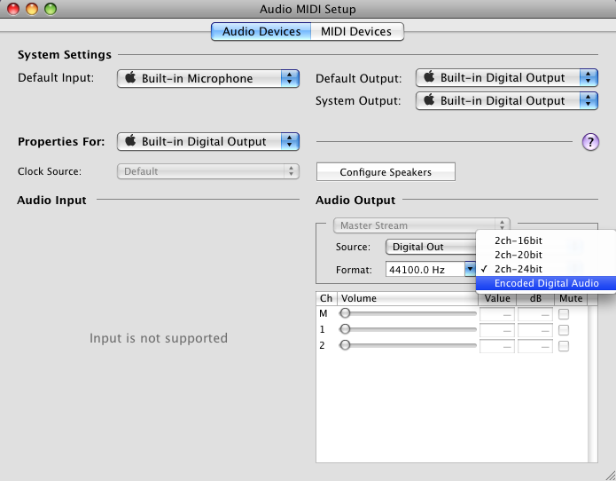

Hi tmongkol, I have an issue with the Digital Out.
If I use the 1.5.7a24 AppleHDA for 888 from post #12 I could have 5.1 on the digital (Encoded Digital Audio option apears on Audio MiDi setup).
But if I use Legacy HDA with 1.6.2a37 vanilla kext the Digital Out can handle only stereo output (Encoded Digital Audio option doesn't apear on Audio MiDi setup).
Even if I copy the values from the 1.5.7a24 kext to the legacy kext that option still wont appear. So do you have an idea where could be the difference to make the 5.1 out available?
@macgirl
I am studying your case. Can you tell me what legacy you are using? Did you try to use stickpin's legacy for 888? I will try to fine out although I don't have MOBO w/ALC888. Also, can you submit your edited legacy?
From my experience, I could not get optical output (red light is off.), unless I have to use the latest modded AppleSMBIOS.kext. I will test my coaxial output tomorrow because I have to move my receiver close to PC.
While I am using Boot-132 w/SMBIOSResolver.kext (red light's optical output's off.), I can select Digital Output for setting Aggregate Devices.

I've been editing stickpin's legacy for 883 to work on my GA-945GCM-S2L (ALC662). Now, outputs (internal speaker, Line Out at blue, headphone, and digital) are working, but I need to solve the problem of input. I got name of internal & external microphones. I tested both AppleHDA.kext 1.5.7a24 and 1.6.2a37.
Also, I have the same problem of digital (got only 2ch) for 945GCM. If I can fix this problem, I will tell you.

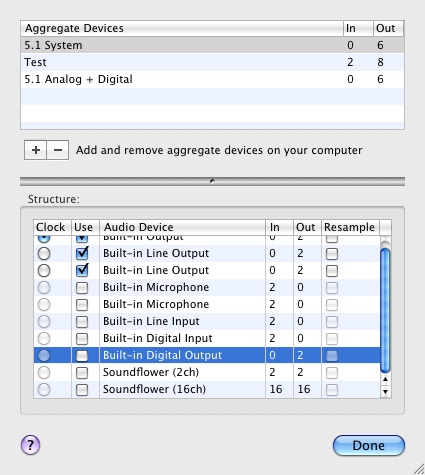

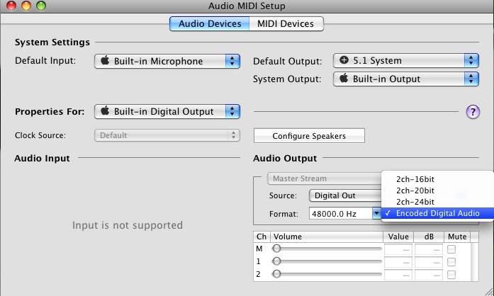

On my GA EP45T DS3 ALC889a I also get only 2 chanels out of the digital ( I haven't tested but in the Aggregate Device editor it shows only 2 ch out under digital out)
Is that normal ?
I know some people on this forum use only the digital out to get their logitech digital 5.1 speakers working..
does it show more channels out if we plug a digital 5.1 speaker system?
Is that normal ?
@indraganzo
Q: Is that normal ?
A: Yes, in Aggregate Device editor, it shows only 2 ch.
However, your system can or cannot send the signal of encoded digital audio, you have to check as picture below. If "Encoded Digital Audio" does not show, it means your receiver will get only 2 ch. For now I know if using legacy method for such ALC888 & ALC662, it will get only 2 ch through Digital Out. Otherwise, ALC888 & ALC662 will get "Encoded Digital Audio", it got to use a working patched AppleHDA.kext.
Q: does it show more channels out if we plug a digital 5.1 speaker system?
A: No.
