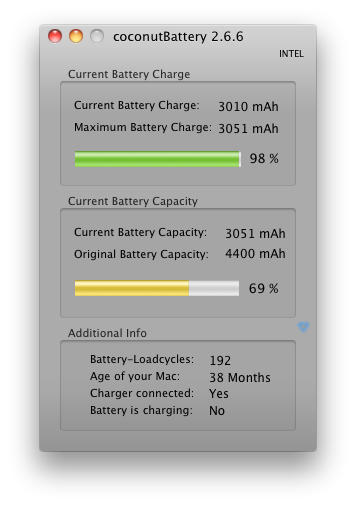

ThirdSmile Posted January 5, 2011 Share Posted January 5, 2011 I have modified dsdt to get more correct battery info: In method "_SB.PCI0.LPCB.EC.C22C" Removed this: Store (Local0, Index (DerefOf (Index (C22F, Arg0)), One)) (because at this moment Local0 contains "Last Full Charge Capacity" but not "Design Capacity" which must be ) And changed default value of "Design Capacity" by correct for my notebook(probably we can read it somewhere ... but i didn't know where.. ) Name (C22F, Package (0x02) { Package (0x0D) { One, 0x1130, // 4400 mAh Ones, One, Ones, Zero, Zero, 0x64, 0x64, "Primary", "100000", "LIon", "Hewlett-Packard" }, Package (0x0D) { One, 0x1130, // 4400 mAh Ones, One, Ones, Zero, Zero, 0x64, 0x64, "Travel", "100000", "LIon", "Hewlett-Packard" } }) Result of patching: Link to comment https://www.insanelymac.com/forum/topic/135410-hp-6520s-6720s-6820s-550-sl-install-package/page/32/#findComment-1615209 Share on other sites More sharing options...
BlackCH Posted January 5, 2011 Author Share Posted January 5, 2011 I have modified dsdt to get more correct battery info: In method "_SB.PCI0.LPCB.EC.C22C" Removed this: Store (Local0, Index (DerefOf (Index (C22F, Arg0)), One)) Is great that you are fixing this. I´ve been trying for a while but I have very little code experience. The big probelm I noticed is that the "Full Charge Capacity" fluctuates all the time (in OSX) thus reducing the charge capacity a lot. If I go to Windows and discharge/charge the battery a couple of times it recovers its full capacity (around 2600 mAh for mine), but as soon as I use it in OSX this value starts dropping... I think the dsdt battery section is not very compatible with OSX. Maybe you want to have a look to the macbook 3,1 dsdt to see how is done there: dsdt_mb3_1.dsl.zip I´ve been scanning the (EC) registers with RW Tool and this is what I found so far: offset 0x84 (8 bits) holds the AC/Battery flag offset 0xA8 (16 bits) holds the current charge value Maybe this registers could be usefull to implement native battery reading via fakesmc.kext and ACPImonitor.kext Link to comment https://www.insanelymac.com/forum/topic/135410-hp-6520s-6720s-6820s-550-sl-install-package/page/32/#findComment-1615273 Share on other sites More sharing options...

ThirdSmile Posted January 5, 2011 Share Posted January 5, 2011 Is great that you are fixing this. I´ve been trying for a while but I have very little code experience. The big probelm I noticed is that the "Full Charge Capacity" fluctuates all the time (in OSX) thus reducing the charge capacity a lot. If I go to Windows and discharge/charge the battery a couple of times it recovers its full capacity (around 2600 mAh for mine), but as soon as I use it in OSX this value starts dropping... I think the dsdt battery section is not very compatible with OSX. Maybe you want to have a look to the macbook 3,1 dsdt to see how is done there: dsdt_mb3_1.dsl.zip About battery, recently I have similar problem ...: I have used notebook most of time from AC adapter and battery begin loosing "maximum capacity"... After reading some Li-Ion battery exploitation recommendations,(like this) I has found solution - simply charge/discharge battery more often. Unfortunately, I am too non ACPI programmer(I am web programmer.. ) ... But, I have litle bit cleaned up management section and tried to implement Smart battery system (simply coping it definition from mb31 dsdt, because i didn't know how to implement it correctly) - but without result ... Probably you can find-out some my changes in dsdt useful for future editing, my current version: dsdt_1.zip Link to comment https://www.insanelymac.com/forum/topic/135410-hp-6520s-6720s-6820s-550-sl-install-package/page/32/#findComment-1615428 Share on other sites More sharing options...
juanerson Posted January 5, 2011 Share Posted January 5, 2011 Thank you very much ThirdSmile, great job. I think we are now in the same boat with the battery problem, and going in the same direction to solve it. I will post my experimental dsdt and results as soon I can test it during a few days. And yes, C1C9 = ECOK, and C225 = SMTX (just for reference). Also, maybe this topic can be helpful. Good Luck. Link to comment https://www.insanelymac.com/forum/topic/135410-hp-6520s-6720s-6820s-550-sl-install-package/page/32/#findComment-1615597 Share on other sites More sharing options...
