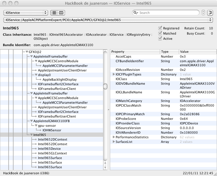

juanerson Posted January 22, 2011 Share Posted January 22, 2011 In IORegistryExplorer, maybe should't have something like this or yes? Link to comment https://www.insanelymac.com/forum/topic/135410-hp-6520s-6720s-6820s-550-sl-install-package/page/34/#findComment-1627424 Share on other sites More sharing options...

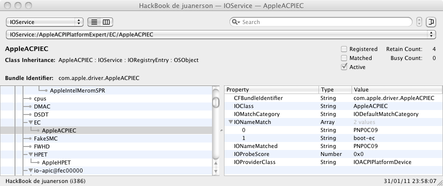

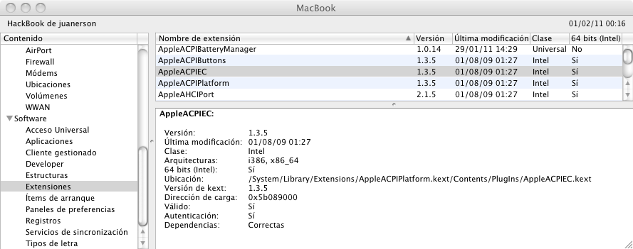

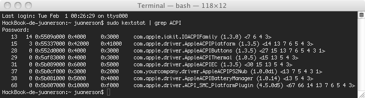

juanerson Posted February 1, 2011 Share Posted February 1, 2011 That optional extension (Embedded Controller injector) is unnecessary in my case, I mean the vanilla one on /System/Library/Extensions/AppleACPIPlatform.kext/Contents/PlugIns/AppleACPIEC.kext load natively in my retail installation from DSDT. I think you can eliminate it with all confidence permanently, because it does not belong to the system. Link to comment https://www.insanelymac.com/forum/topic/135410-hp-6520s-6720s-6820s-550-sl-install-package/page/34/#findComment-1632944 Share on other sites More sharing options...

juanerson Posted February 6, 2011 Share Posted February 6, 2011 Report: Here using vanilla (untouched) X3100 drivers, with 2A02 variant and display monitor 100% native... No problems Link to comment https://www.insanelymac.com/forum/topic/135410-hp-6520s-6720s-6820s-550-sl-install-package/page/34/#findComment-1635469 Share on other sites More sharing options...
ThirdSmile Posted February 6, 2011 Share Posted February 6, 2011 Report: Here using vanilla (untouched) X3100 drivers, with 2A02 variant and display monitor 100% native... No problems I am using Driver with patched device ids for 2a12, and patched Backlight controll method... It seems that problem is because of difference beetwean 2a02 and 2a12 chipset versions: I am trying to find out what can be wrong(and need to be fixed) in driver, in "Graphics Controller Programmer’s Reference Manual" and in "Chipset Datasheet" - but no luck yet. @juanerson : What about kernel panic logs - does your system saves logs when KP occurs? Link to comment https://www.insanelymac.com/forum/topic/135410-hp-6520s-6720s-6820s-550-sl-install-package/page/34/#findComment-1635482 Share on other sites More sharing options...
BlackCH Posted February 6, 2011 Author Share Posted February 6, 2011 Report: Here using vanilla (untouched) X3100 drivers, with 2A02 variant and display monitor 100% native... No problems Same here. I have the brightness patch thou, but no KP Link to comment https://www.insanelymac.com/forum/topic/135410-hp-6520s-6720s-6820s-550-sl-install-package/page/34/#findComment-1635528 Share on other sites More sharing options...
