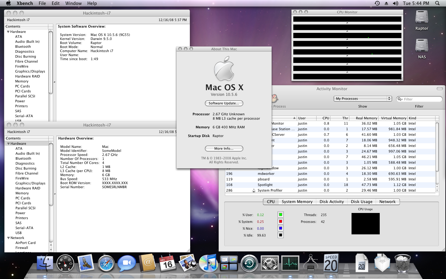

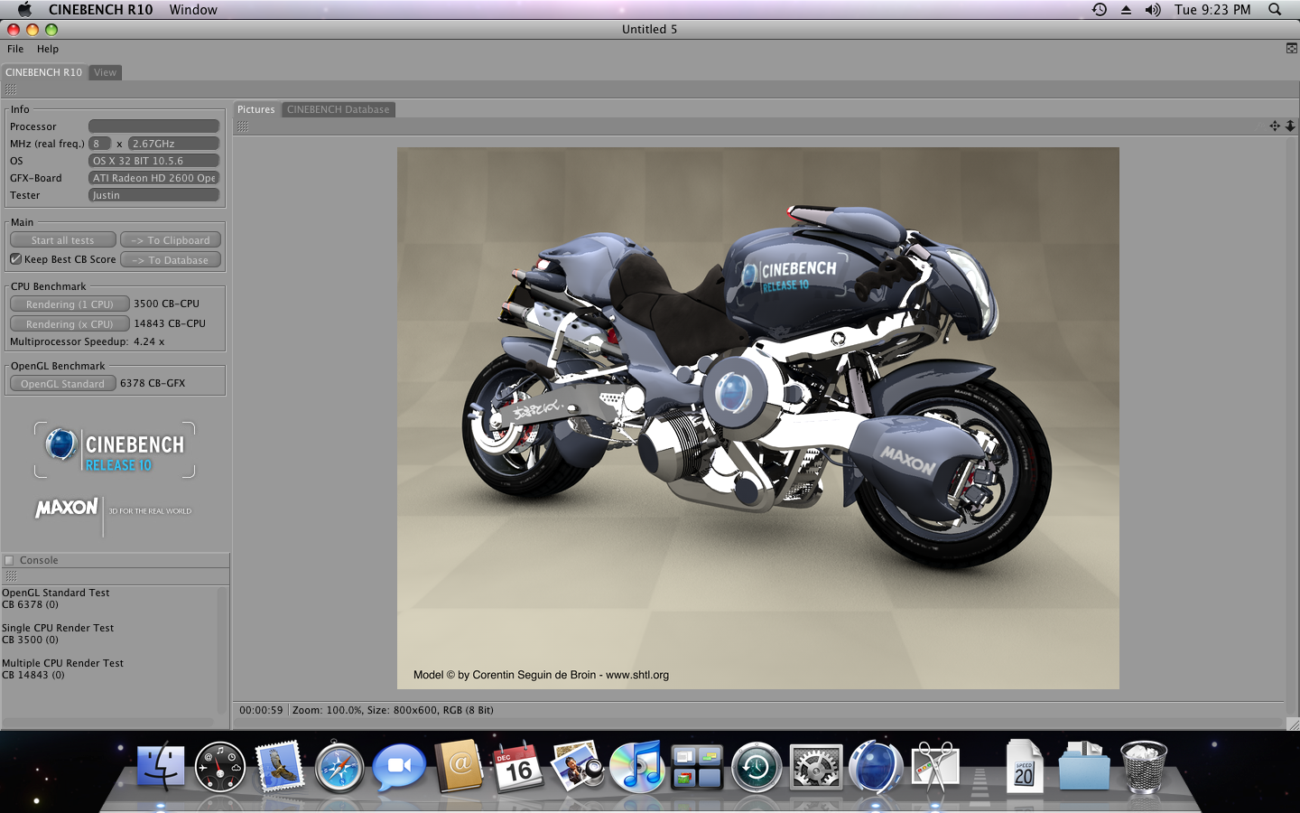

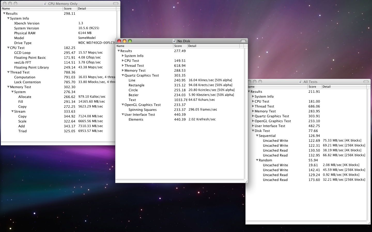

wolfienuke Posted December 16, 2008 Share Posted December 16, 2008 Smoothy your so smooth ;-)))))Activity.tiff Its so easy to make a man happy....just double click.... and I am still on 10.5.2, no KP, everything is working, fast, snappy, processor runs pretty cool with the noctua, and quiet, overclocked to 3.6, geekbench 9530, xbench 367nodisk 245disk, just waiting for my SSD to arrive... Ohh, thank you Smoothy... I never had anything more than a dual core, so I did not know of that... It seems that all 8 threads are seen! Oh happy day! Link to comment https://www.insanelymac.com/forum/topic/132960-upcoming-intel-x58-mobos-core-i7-cpus/page/11/#findComment-1001740 Share on other sites More sharing options...
