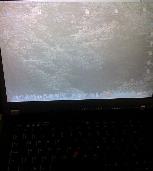

Can you post a picture? (screenshot won't show it.)
Here it is. You can't really see much from it but anyways. And also on the left side there is a rectangle boxish thing. That stays 5cm below the mouse.
Found something interesting. On some reboots my screen looks like the green has been set too high and then if I go into the System Preferences > Display and change the resolution it returns to normal color but the lines remain.

Thanks. I can't guess about your lines issue. Have you tried to see if if happens on an external display?
Here you go.
I was wondering about my lines issue. Could the type of display influence it? There were three types and I was wondering if this could change anything?
Just tried and it works with no lines on the external display but they stay on the laptop. (No mouse on anything)
Something I found weird though was that the max resolution of my external monitor is 1280x1024 but whenever I tried this the screen stayed black with no input. The max I could go up to was 1152x864 while in Windows I could get the full 1280x1024.
