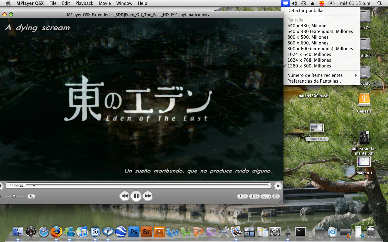

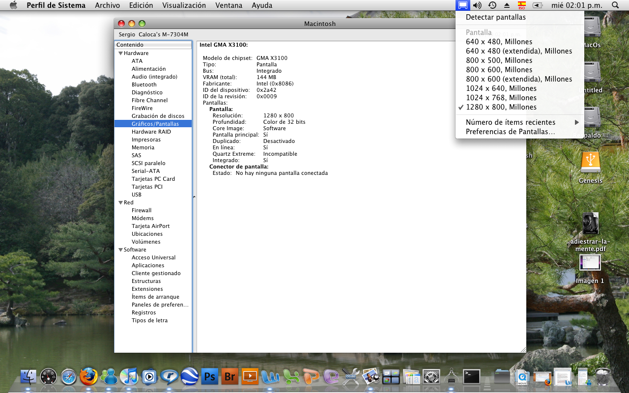

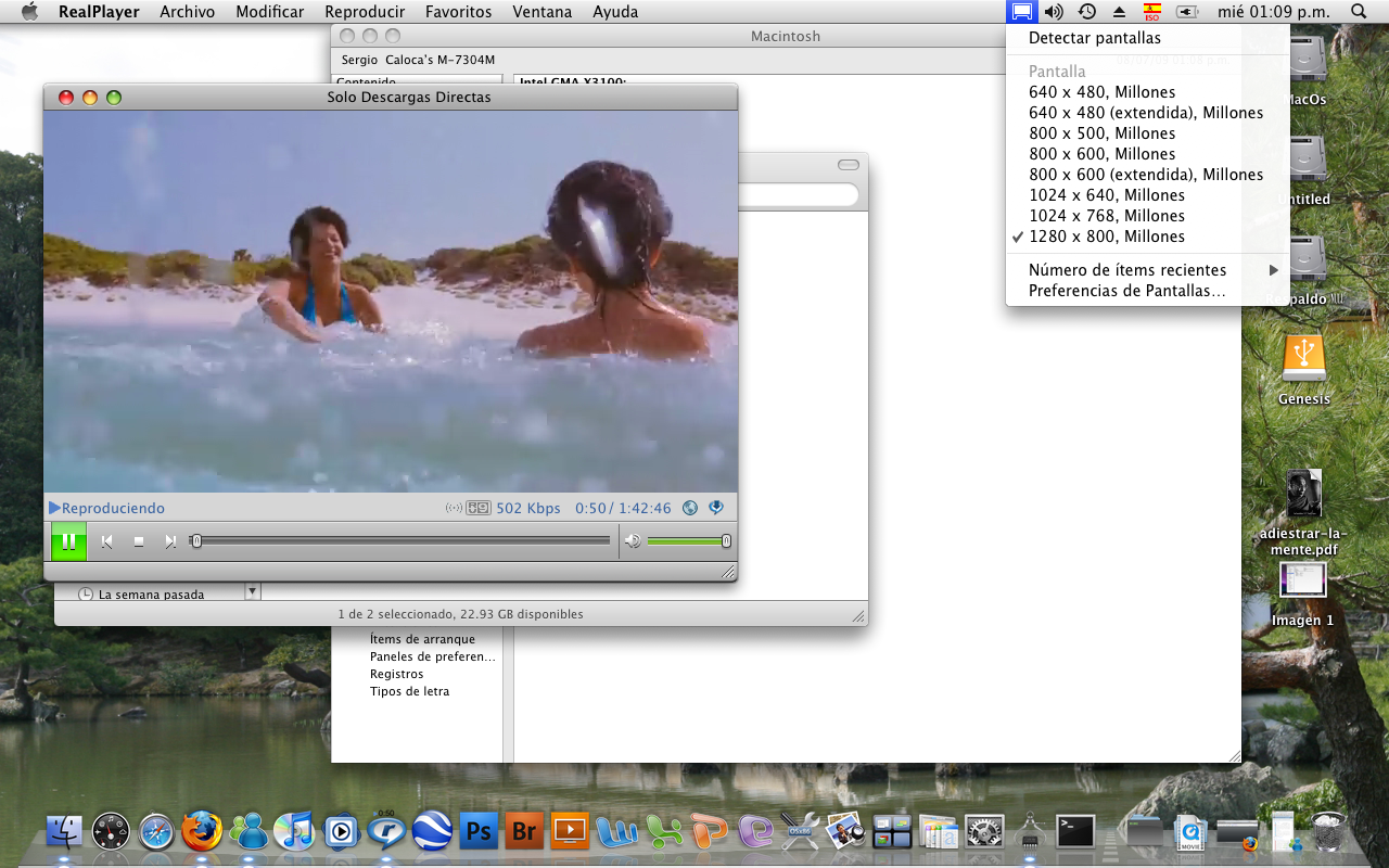

Hello friends! :D
Thanks for all the work you are doing is very important for the community.
I could solve the problem, solve it with the information described here. Above all thank you "Tienneke" who was the person who guided me and was very helpful despite my frustration of not knowing the language. :)
Thank you very much "Tienneke! :)
I must also thank the entire team that worked on this, complete the work under the guidance and comment that I "coldequation," Whose idea was download the file "patch4500 script (20090705.2)" and this can help you successfully install the patch. Finally after all this time I can have the proper resolution of my monitor and play movies in all formats for non-conventional "LEOPARD" as the format is. MKV and. RMVB. Formats that are difficult to reproduce in my previous resolution of 1024 * 768.
(((I'll describe what I did to solve the problem, I hope that helps somewhat as follows:
1 .- As remarked "Tienneke" delete file "2A42AppleIntelGMAX3100.kext" but every time I reset the machine back up the file. So what I did was to delete the file "2A42AppleIntelGMAX3100.kex, Natit.kext" then a folder named "GMA900Backup" which included the following files: "AppleIntelGMA950.kext, AppleIntelGMA950GA.plugin, AppleIntelGMA950VADriver. bundle "among others. Folder "GMA900Backup" was inside / System / Library / Extensions /. ))) -_-
So I restart the machine without those files. Then install "patch4500 script (20090705.2)" with the information they gave me "Tienneke"
Run the script / Users/sergiocaloca/Documents/MacOSx/script/patch4500.bash VRF-2a42
Reboot
When starting my machine again and had the resolution of 1280 * 800.
Attention! The information that appears in all three brackets was something made in a desperate attempt to remove the famous file 2A42AppleIntelGMAX3100.kex "I do not know if this worked there for proper operation. Or really "patch4500 script (20090705.2)" works fine by changing the version before you install "patch4500 script (20090705.1) 'and now install the" patch4500 script (20090705.2) "so maybe there resides the difference. Do not take much account of what this in brackets (((---))).
Even I do not know I am no expert on this, but I know is that my monitor resolution change really works, I can now play back video that makes me very happy! Sending images to see a change HOHOHOHO!
Thank you all! :):):thumbsup_anim:

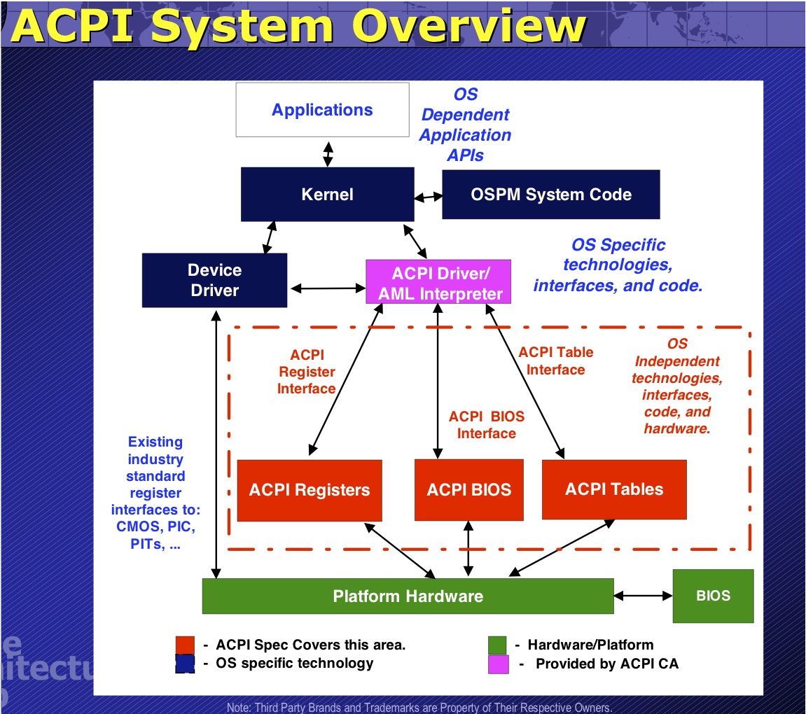

BTW, Slice shared some interesting info:
GA.plugin works from user space as interface (IOUserClient) between CoreGraphics and the main graphics kext-- AplleIntelGMAX3100.kext in the X3100's case.
If there are no GA.plugin then QE is not supported.
GLDriver.bundle also works from user space as interface between OpenGL framework and same kext
If there are no GLDriver then MacOSX uses software renderer.
Both are hardware dependent and contain hardware specific codes. We have no sources of them and no Linux analogs. Both contain SSE3 codes! They are strongly optimized for better performance.
About VA and DVD I don't know. Probably they are used by CoreVideo and DVDPlayback frameworks.
