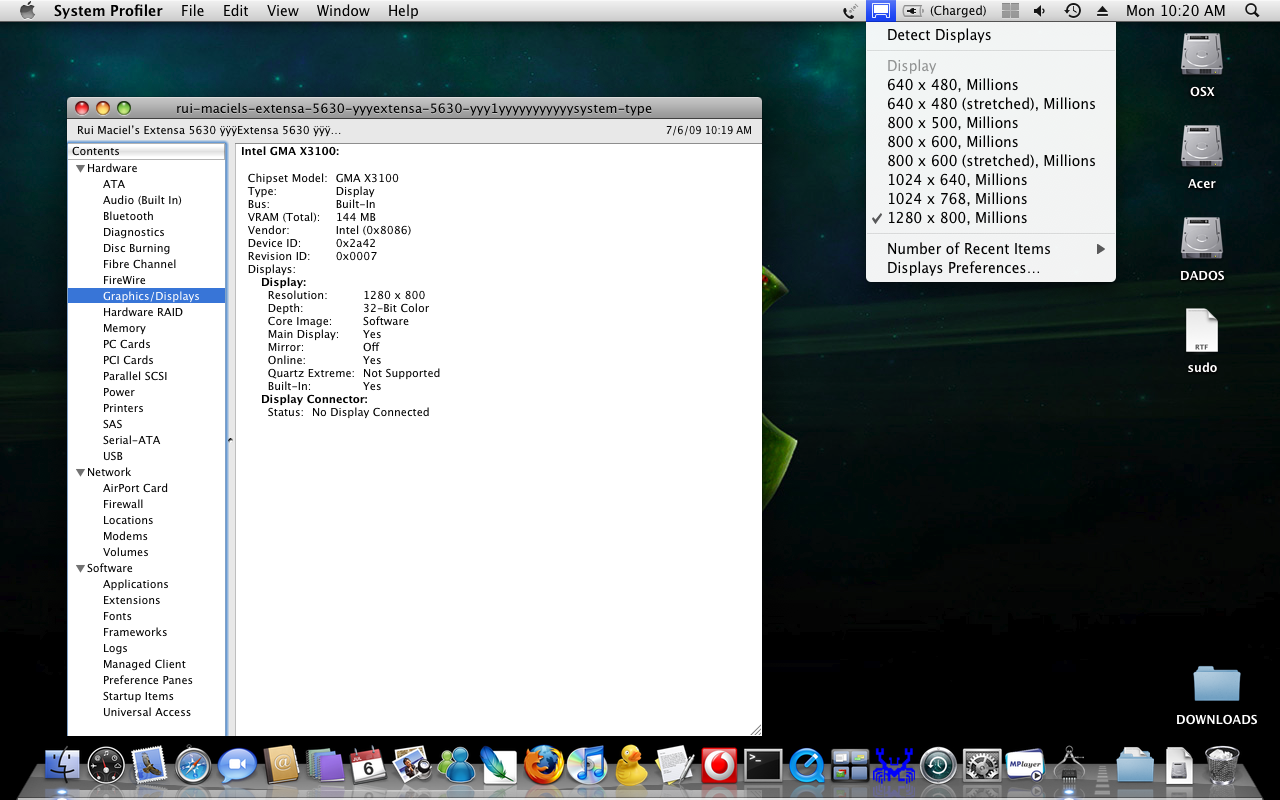

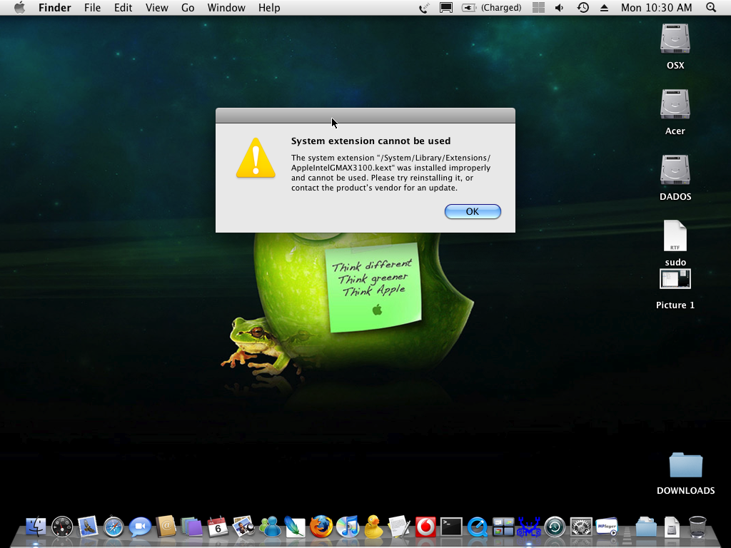

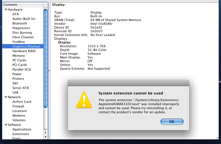

Maxcielle Posted July 6, 2009 Share Posted July 6, 2009 i have used: patch4500.bash -rf 2a42 Then i deleted all gma 950 kext's. using chameleon 1 bootloader. I got this (see the picture) but i also got the AppleIntelGMAX3100.kext cannot be used message like mnelson. let me know if you need me to run some tests for you. I am glad to help. Link to comment https://www.insanelymac.com/forum/topic/129744-gma-x4500/page/13/#findComment-1193428 Share on other sites More sharing options...
Tienneke Posted July 6, 2009 Share Posted July 6, 2009 i have used: patch4500.bash -rf 2a42Then i deleted all gma 950 kext's. using chameleon 1 bootloader. I got this (see the picture) but i also got the AppleIntelGMAX3100.kext cannot be used message like mnelson. let me know if you need me to run some tests for you. I am glad to help. If you run repair permissions from disk utility the kext will be usable.. Link to comment https://www.insanelymac.com/forum/topic/129744-gma-x4500/page/13/#findComment-1193434 Share on other sites More sharing options...

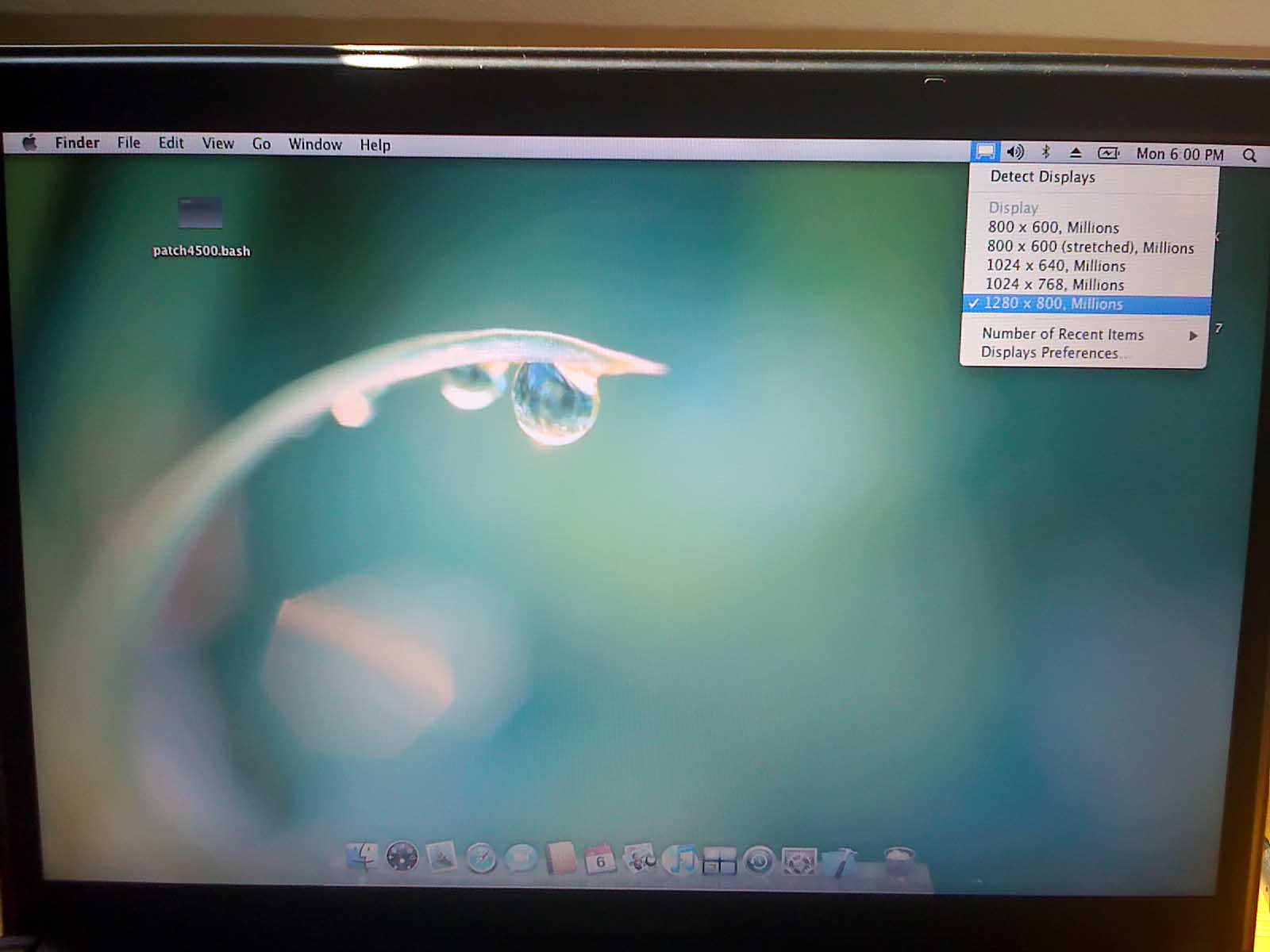

Váradi László Posted July 6, 2009 Share Posted July 6, 2009 First of all let me say thank you for all of you guys trying to make our life easier. I tried the bash script on my Lenovo n500 with Intel 4500 MHD: -first, i did -vf 2a42 (this is the device id from system profiler) result: few seconds of normal blur welcome screen after clean reboot, then white/colored noise like on old tv-s. I tried to boot into safe mode with -x, which i was able to, but my mouse wasn't visible, i could move it, but not see it. I managed (after some mouse hunting) however to use the bash file with -rf 2a42, then i deleted the kext, and everything went back to "normal" even in normal boot mode. - secondly i used -rf 2a42, which made the native resolution in normal booting (no freezing in a white noised screen on boot) however, the mouse pointer is still not visible, making work a little tiresome:), but the screen worked in its glorious 1280*800 resolution. I removed it again and now the old res is back, but i have my mouse pointer. Just wanted to help you guys testing, thanks again for your hard work, and if you have a solution for the disappearing mouse pointer, please share:) Laci Link to comment https://www.insanelymac.com/forum/topic/129744-gma-x4500/page/13/#findComment-1193470 Share on other sites More sharing options...
coldequation Posted July 6, 2009 Share Posted July 6, 2009 What do you see in your system log? Are you using a mouse or trackpad? Have you tried an external mouse? You may find a clue there. I have no idea why your mouse pointer is not being displayed, but it may be related to PS2 or USB issues. First of all let me say thank you for all of you guys trying to make our life easier.I tried the bash script on my Lenovo n500 with Intel 4500 MHD: -first, i did -vf 2a42 (this is the device id from system profiler) result: few seconds of normal blur welcome screen after clean reboot, then white/colored noise like on old tv-s. I tried to boot into safe mode with -x, which i was able to, but my mouse wasn't visible, i could move it, but not see it. I managed (after some mouse hunting) however to use the bash file with -rf 2a42, then i deleted the kext, and everything went back to "normal" even in normal boot mode. - secondly i used -rf 2a42, which made the native resolution in normal booting (no freezing in a white noised screen on boot) however, the mouse pointer is still not visible, making work a little tiresome:), but the screen worked in its glorious 1280*800 resolution. I removed it again and now the old res is back, but i have my mouse pointer. Just wanted to help you guys testing, thanks again for your hard work, and if you have a solution for the disappearing mouse pointer, please share:) Laci Link to comment https://www.insanelymac.com/forum/topic/129744-gma-x4500/page/13/#findComment-1193488 Share on other sites More sharing options...
Váradi László Posted July 6, 2009 Share Posted July 6, 2009 What do you see in your system log? Are you using a mouse or trackpad? Have you tried an external mouse? You may find a clue there. I have no idea why your mouse pointer is not being displayed, but it may be related to PS2 or USB issues. I am using a ps/2 driver (if i remember correctly it was called voodoo) for the keyboard and the trackpad, iatkos v7 needed it (without that it couldn'd find my keyboard), interestingly iatkos v5 didn't need it. I also use a usb wireless mouse, both of them are working correctly with you patch, but i can't see the pointer. I tried to remove the usb dongle, it didn't make a difference, the trakcpad worked but no pointer. Do you think it would make a diference to apply your patch while the dongle is not in any usb ports? Cos' it was plugged in when i applied the bash. Without the bash, both of them work fine (they work with the bash too, just no pointer on screen) I am thinking it has to do with hardware accelerated mouse, which is usually done by the vga card, so i was looking for a way to disable it and to revert to software mouse rendering, but i couldn't find anything. How can i see the system log you referred to? Link to comment https://www.insanelymac.com/forum/topic/129744-gma-x4500/page/13/#findComment-1193501 Share on other sites More sharing options...

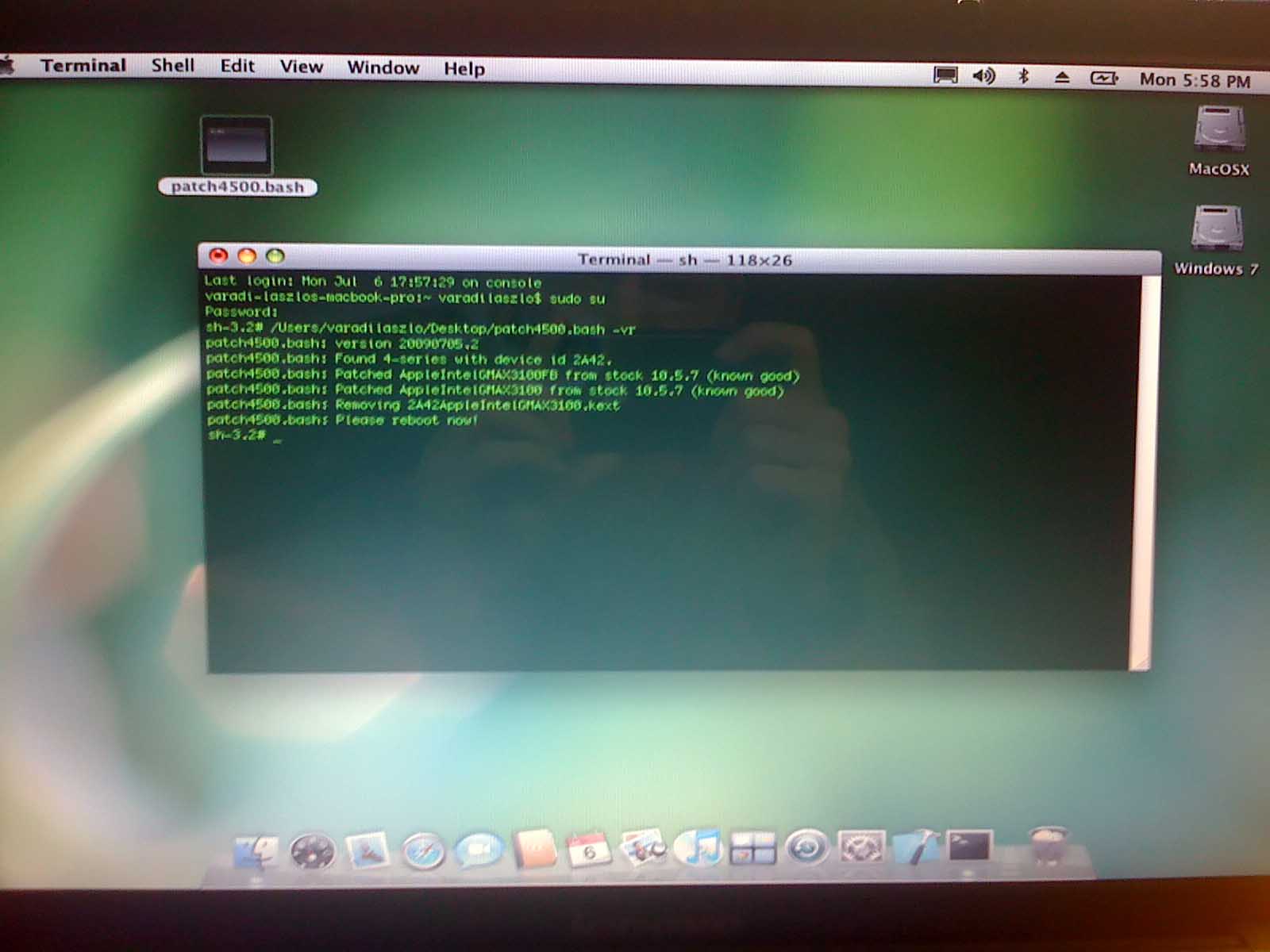

coldequation Posted July 6, 2009 Share Posted July 6, 2009 Could you post the output when you just use patch4500.bash -vr (without the -f option)? If by lspci working, you mean the script running without any -v or -f ****, then no, it says something about missing x4500 accelerator, and a few lines of missing methods. the only way i could get the script to do anything was with the -f selector. I couldnt find anythins useful in the plist files inside the voodoo kext, so i'm now reinstalling iAtkos with another ps/driver (i was missing audio, power management, even ethernet anyway), and see if it works. VoodooPS2 includes an (optional, I believe) preferences panel in System Preferences. That is what I was referring too (but it would just set something in the plist files anyway). Do you think the problem may actually be that Leopard thinks you are connected to an external monitor? Link to comment https://www.insanelymac.com/forum/topic/129744-gma-x4500/page/13/#findComment-1193604 Share on other sites More sharing options...
Váradi László Posted July 6, 2009 Share Posted July 6, 2009 Could you post the output when you just use patch4500.bash -vr (without the -f option)? VoodooPS2 includes an (optional, I believe) preferences panel in System Preferences. That is what I was referring too (but it would just set something in the plist files anyway). Do you think the problem may actually be that Leopard thinks you are connected to an external monitor? Wow, i didn't know that there should be one in the system preferences. I installed it from the iatkos v7 dvd, and there isn't such a panel. Any idea how make it appear? I cant find anything about leopard thinking about a second monitor in the displays panel in syspref. I ran the bash with -vr and it worked, but after reboot, no pointer. Can you tell me how to undo it? I thought -r will remove it, then i deleted the kext. This is what is should do? Link to comment https://www.insanelymac.com/forum/topic/129744-gma-x4500/page/13/#findComment-1193638 Share on other sites More sharing options...
