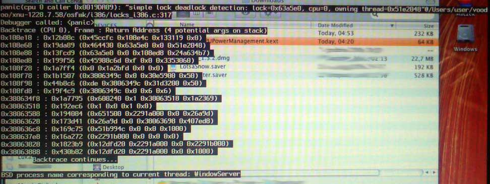

Now i´m confused:

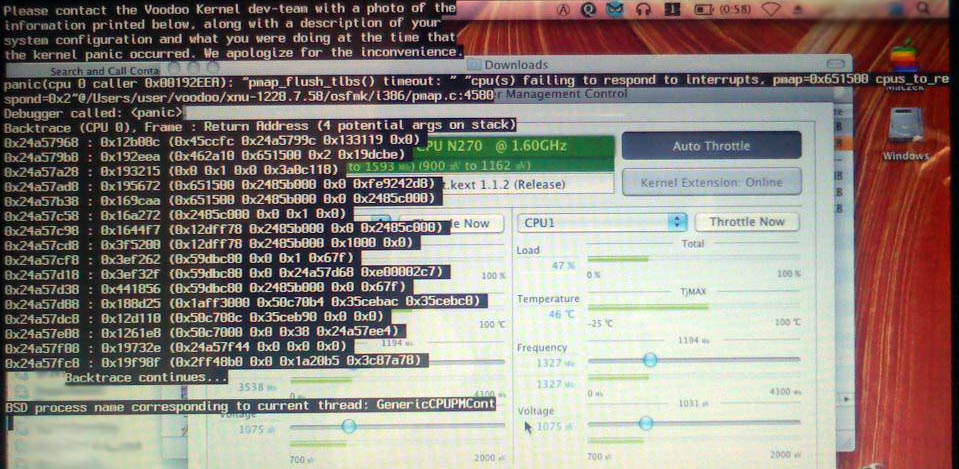

as u said i tried new .kext 1.1.1 and it KPéd EVERY restart AND shutdown. I did a fresh retail install, updated via SU, transfered info through MigrationAss. and now it works flawlessly ?????
Seems, that something in my installation was broken, nevermind ;)
Cheers

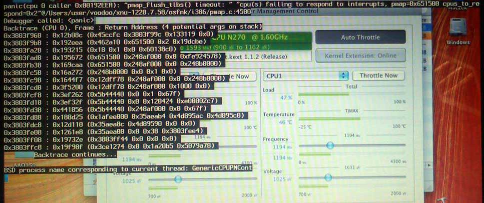

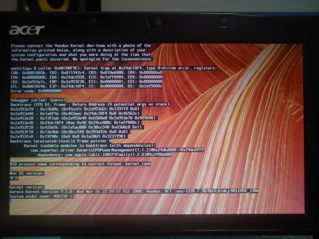

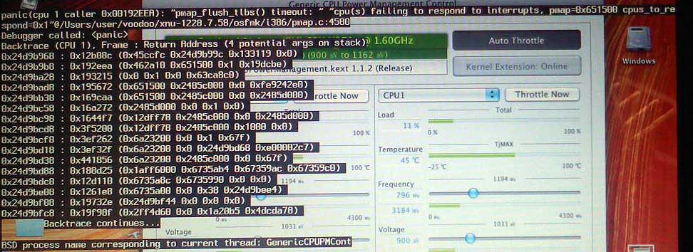

Well first off happy to report, your latest kext works awesome on my Wind.

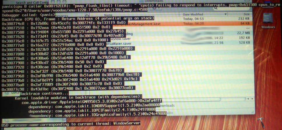

Just one issue, I just tried your ACPIBattery.kext and it kernel panics with GenericCPUPowerManagement.kext, if used with battery.
The machine will work and boot fine with the AC Adapter. If booted without AC it will KP and if AC is removed AFTER Boot, then it will just hang, dunno if it KP's or not.
Till now I had been using AppleACPIBatteryManager.kext
Hm, so it still same issue... I have to take a look.
Try the newest upload. Should have this fixed...

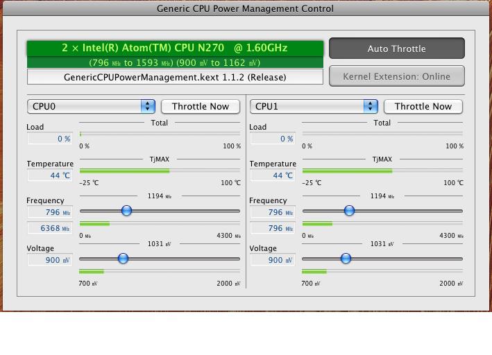

Updated the gui app with some options... requires download of new kext.
Thanks - GUI getting really cool !

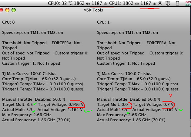

MSR TOOL verify:

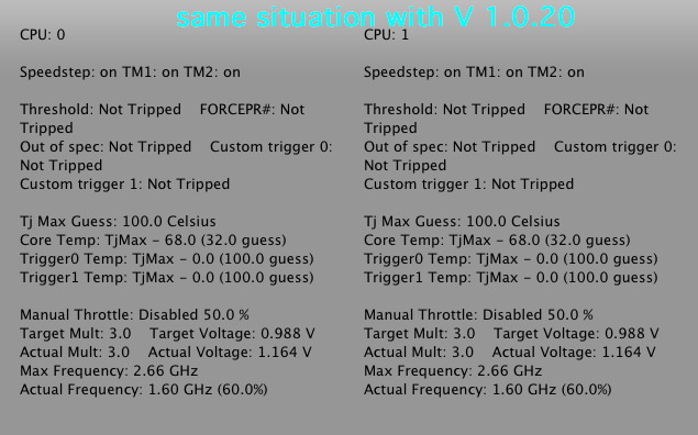

I also seen with that newest .kext an maybe undifined target Multiplier in my CPU1 : MSR target Multiplyer (= PSate) went to 0 Zero
Actual Multipyiers shown in MSR Tool are OK and same as Control App (also newest) shows.
Also the VIDs seem target (only) now changing but shown little different between CPU0 and CPU 1
Actual VIDs while trottling are 1325 (max) and 1164 - both correct, but never got my 925.
Also only MSR Tool (screen shoot) shows my 1164 mVolts (in .plist for Pstate 3) - your app shows 1187 therefore
Added screenshoot ,
also V 1.0.20 MSR target multipliers CPU0/1 are same, target VIDs CPU0/1 are same here, also 1596 MHZ without forcing trothle or short full load)
Thanks

ok even with the newest version of this kext, the system freezes momentarily once the kext is installed. then i have to do a hard restart and then it freezes again either at the boot or 3-4 sec once the system is loaded. there are no panic messages or kps. can u pls tell me what i should do to fix it?
Last time I asked you to boot -s (single user mode) and load the kext from there and post me the output. It seem like you have ignored this, how can I help you?
I installed 1.1.2 version on my Aspire One (boot 132, Leo 10.5.5) with Voodoo RC. I recived kernels panic wich I supose wa sconnected with sound generation (KP occurs during start-up sound of Skype, sound of sutter when I grab screen, and when I run Itunes -- sound was chopped when cpu goes down to 796 MHz).
1st attempt to grab a screen [apple+shift+3]
2nd attempt to grab a screen [apple+shift+3]
Skype is starting
iTUnes
On Shut Down after removing GenericCPU kext:
And finally I grab a screen: look at  Freq on CPU0... 6368 MHz
