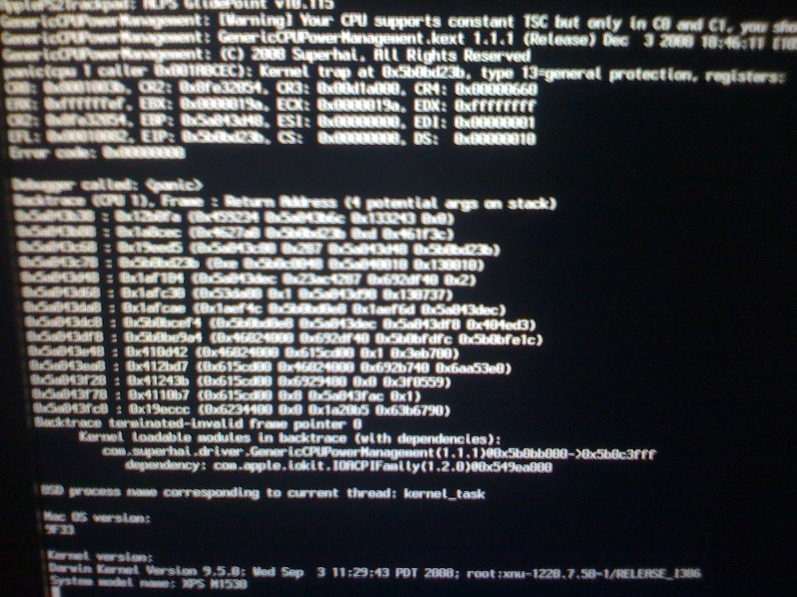

Chrysaor Posted December 3, 2008 Share Posted December 3, 2008 Getting panic with 1.1.1 on M1530 with T8300. 1.1 is working fine. If the pic is too blurry, I can take another one. Link to comment https://www.insanelymac.com/forum/topic/123774-new-version-11-of-genericcpupowermanagement/page/22/#findComment-986920 Share on other sites More sharing options...

talisman Posted December 4, 2008 Share Posted December 4, 2008 1.1.1 gives KP in M1530 with T9300. Kernel: Vanilla 9.5.0. OS X 10.5.5 1.1 works fine. Link to comment https://www.insanelymac.com/forum/topic/123774-new-version-11-of-genericcpupowermanagement/page/22/#findComment-987211 Share on other sites More sharing options...

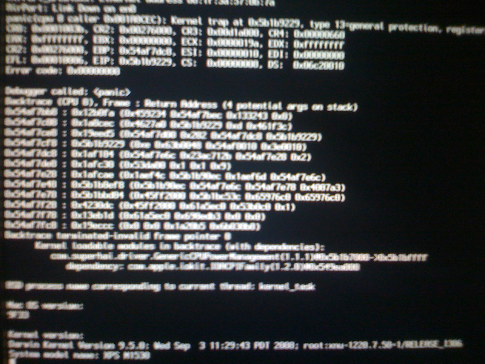

Dolcezeus Posted December 4, 2008 Share Posted December 4, 2008 the last edition of kext do a kernel panic on my E8400 have a solution? Link to comment https://www.insanelymac.com/forum/topic/123774-new-version-11-of-genericcpupowermanagement/page/22/#findComment-987301 Share on other sites More sharing options...
Superhai Posted December 4, 2008 Author Share Posted December 4, 2008 the last edition of kext do a kernel panic on my E8400 have a solution? Seem like newer intel cpus panic on T-States, which is odd because intel says thats an architectural feature. Can you see if the panic always comes on cpu 1? Or also on cpu 0? Anyway you can turn it off. Link to comment https://www.insanelymac.com/forum/topic/123774-new-version-11-of-genericcpupowermanagement/page/22/#findComment-987335 Share on other sites More sharing options...

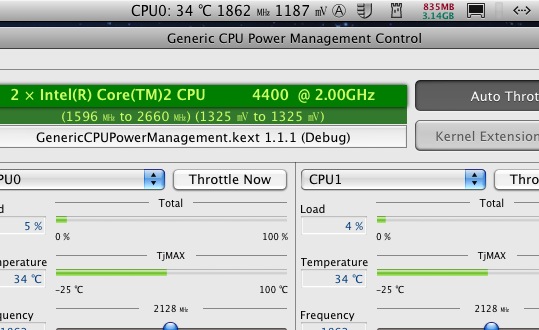

mitch_de Posted December 4, 2008 Share Posted December 4, 2008 Hi, i also tried newest 1.1.1 (i am that with the VID not trothhled problem, all info some post before). Problems stay: 1. kextload, some throttleing then: stays at PSTATE slowest +1 even near no Load (see shoot) 2. VIDs didnt change (sometimes for short time 1187 mV - not in PSTATE VID-array, maybe from gigabyte EP35 board made itself) enericCPUPowerManagement: [Debug] Initialization : Probe GenericCPUPowerManagement: [Debug] Found 2 I/O Kit CPU's and 4 ACPI CPU's GenericCPUPowerManagement: [Debug] Your CPU supports constant TSC but only in C0 and C1, you should disable C2+ states GenericCPUPowerManagement: [Debug] Minimum VID Probe GenericCPUPowerManagement: [Debug] Minimum VID Probe Complete : 28 GenericCPUPowerManagement: [Debug] Intel 06000A28 0A280A28 GenericCPUPowerManagement: [Debug] CPU Hardware Driver Setup Complete GenericCPUPowerManagement: [Debug] Initialization : Start GenericCPUPowerManagement: GenericCPUPowerManagement.kext 1.1.1 (Debug) Dec 4 2008 19:08:32 [1050] GenericCPUPowerManagement: © 2008 Superhai, All Rights Reserved GenericCPUPowerManagement: [Debug] P-State 0: 2660 MHz [0A-00] - 1325 mV [28] GenericCPUPowerManagement: [Debug] P-State 1: 2394 MHz [09-00] - 1225 mV [20] GenericCPUPowerManagement: [Debug] P-State 2: 2128 MHz [08-00] - 1125 mV [18] VIDs all OK but never used ?! GenericCPUPowerManagement: [Debug] P-State 3: 1862 MHz [07-00] - 1025 mV [10] That VIDs work in V 1.0.20 GenericCPUPowerManagement: [Debug] P-State 4: 1596 MHz [06-00] - 0925 mV [08] GenericCPUPowerManagement: [Debug] CPU 0: CTL 0A28 TR 064 GenericCPUPowerManagement: [Debug] CPU 1: CTL 0A28 TR 063 GenericCPUPowerManagement: [Debug] Last loop used 0 us GenericCPUPowerManagement: [Debug] CPU 0 load 0020 highest P-State 0 (exact) and frequency 2660 GenericCPUPowerManagement: [Debug] CPU 1 load 0020 P-State 0 (exact) and frequency 2660 GenericCPUPowerManagement: [Debug] AutoThrottle - from 0 to 4 - Requesting 0608 GenericCPUPowerManagement: [Debug] Last loop used 114 us GenericCPUPowerManagement: [Debug] CPU 0 load 0018 highest P-State 0 (exact) and frequency 2660 GenericCPUPowerManagement: [Debug] CPU 1 load 0013 P-State 0 (exact) and frequency 2660 GenericCPUPowerManagement: [Debug] AutoThrottle - from 0 to 4 - Requesting 0608 GenericCPUPowerManagement: [Debug] Last loop used 167 us GenericCPUPowerManagement: [Debug] CPU 0 load 0005 P-State 4 (approximate) and frequency 1596 GenericCPUPowerManagement: [Debug] CPU 1 load 0010 highest P-State 4 (approximate) and frequency 1596 bash-3.2# dmesg Would it be possible to add an debug output for VID (VID or mVolts , doesnt matter) throttling in debug out ? But with that version i get some interesting debug out (time as it should throtthle down to 1596 MHZ (slowest), stays at 18xx MHZ I never seen got userland request before. enericCPUPowerManagement: [Debug] CPU 1 load 0010 P-State 4 (approximate) and frequency 1862 GenericCPUPowerManagement: [Debug] Got userland request GenericCPUPowerManagement: [Debug] Got userland request GenericCPUPowerManagement: [Debug] Got userland request GenericCPUPowerManagement: [Debug] Got userland request GenericCPUPowerManagement: [Debug] Last loop used 103 us GenericCPUPowerManagement: [Debug] CPU 0 load 0013 P-State 4 (approximate) and frequency 1862 GenericCPUPowerManagement: [Debug] CPU 1 load 0018 highest P-State 4 (approximate) and frequency 1862 GenericCPUPowerManagement: [Debug] Got userland request GenericCPUPowerManagement: [Debug] Got userland request GenericCPUPowerManagement: [Debug] Got userland request GenericCPUPowerManagement: [Debug] Got userland request GenericCPUPowerManagement: [Debug] Last loop used 103 us Thanks Link to comment https://www.insanelymac.com/forum/topic/123774-new-version-11-of-genericcpupowermanagement/page/22/#findComment-987885 Share on other sites More sharing options...
