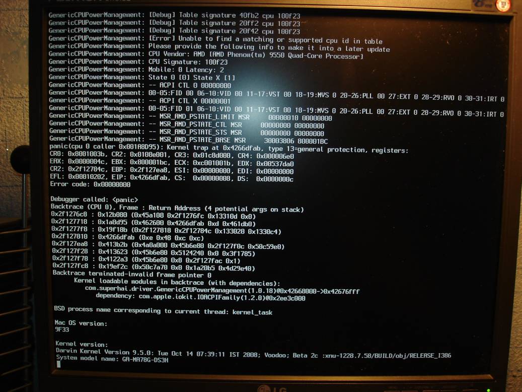

javum Posted November 6, 2008 Share Posted November 6, 2008 Ok so K10 cpus use other way to use cool n quiet. A have read, that your AMD support based on linux powernowk8, but phenom seems to be supported in linux with powernowd this some patches: https://bugs.launchpad.net/ubuntu/+source/p...owd/+bug/261608 http://kerneltrap.org/mailarchive/linux-ke...007/10/9/333409 Link to comment Share on other sites More sharing options...

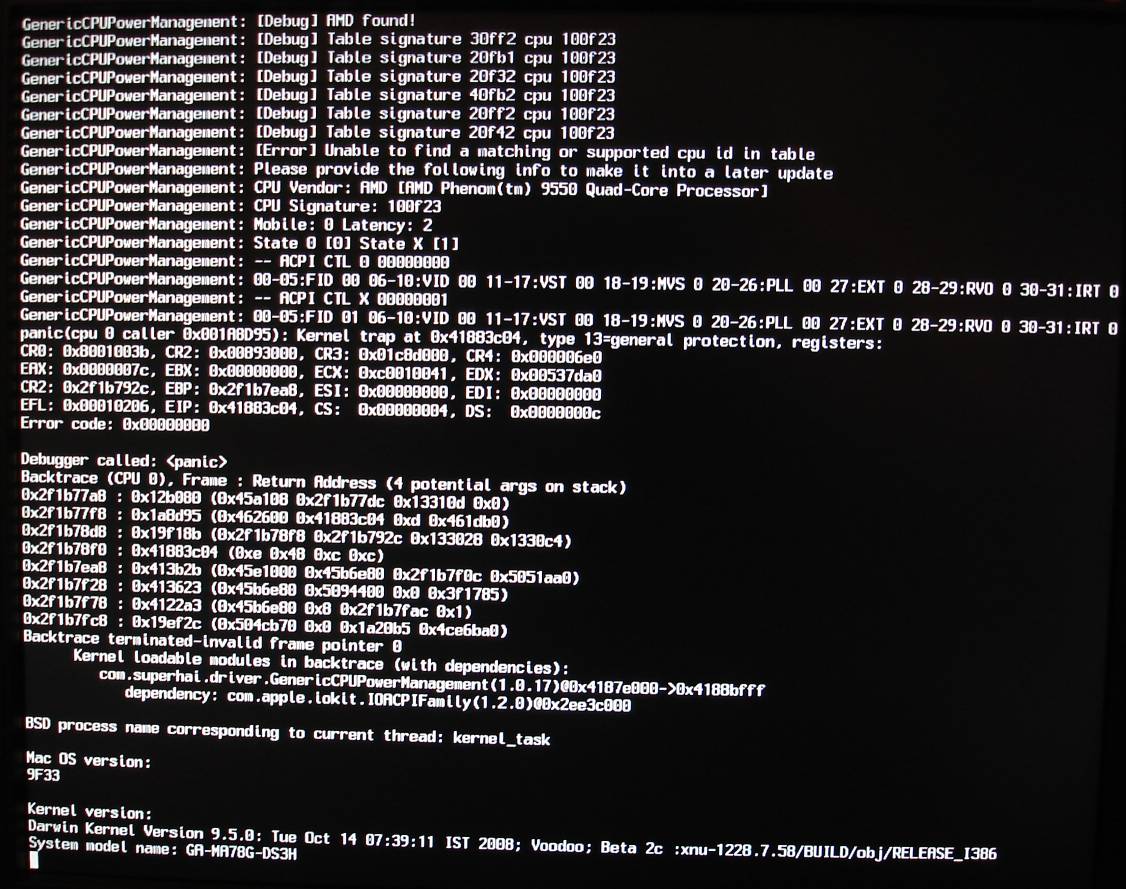

Superhai Posted November 7, 2008 Author Share Posted November 7, 2008 A have read, that your AMD support based on linux powernowk8, but phenom seems to be supported in linux with powernowd this some patches:https://bugs.launchpad.net/ubuntu/+source/p...owd/+bug/261608 http://kerneltrap.org/mailarchive/linux-ke...007/10/9/333409 Can you try the newest debug version and post me the output? Link to comment Share on other sites More sharing options...
javum Posted November 8, 2008 Share Posted November 8, 2008 Can you try the newest debug version and post me the output? Ok. This is the result: Link to comment Share on other sites More sharing options...

Superhai Posted November 8, 2008 Author Share Posted November 8, 2008 Do u mean the debug one or other ? [Edit] with the normal version I got KP again , if setted the key @true and the min voltage @800 ... If you want me to fix kernel panics, you must post it to me. It is very difficult to find out what is wrong without seeing where it goes wrong. Link to comment Share on other sites More sharing options...
