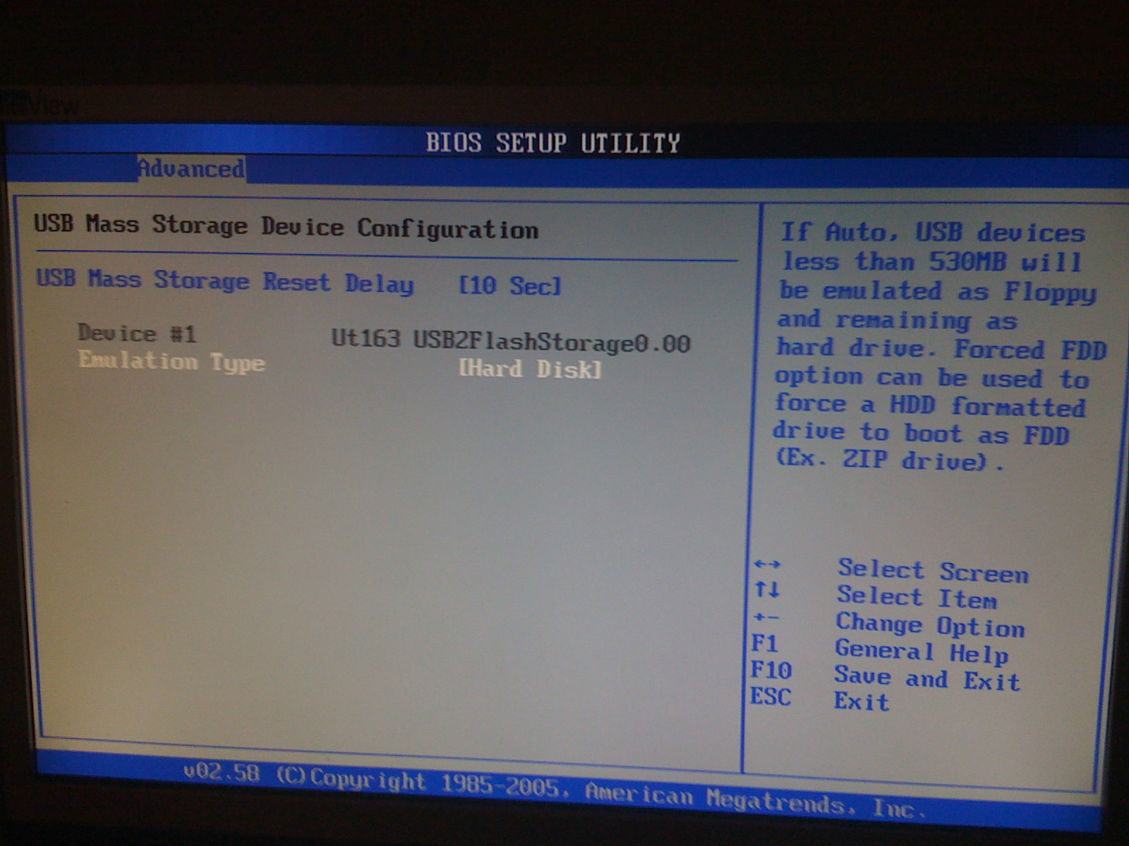

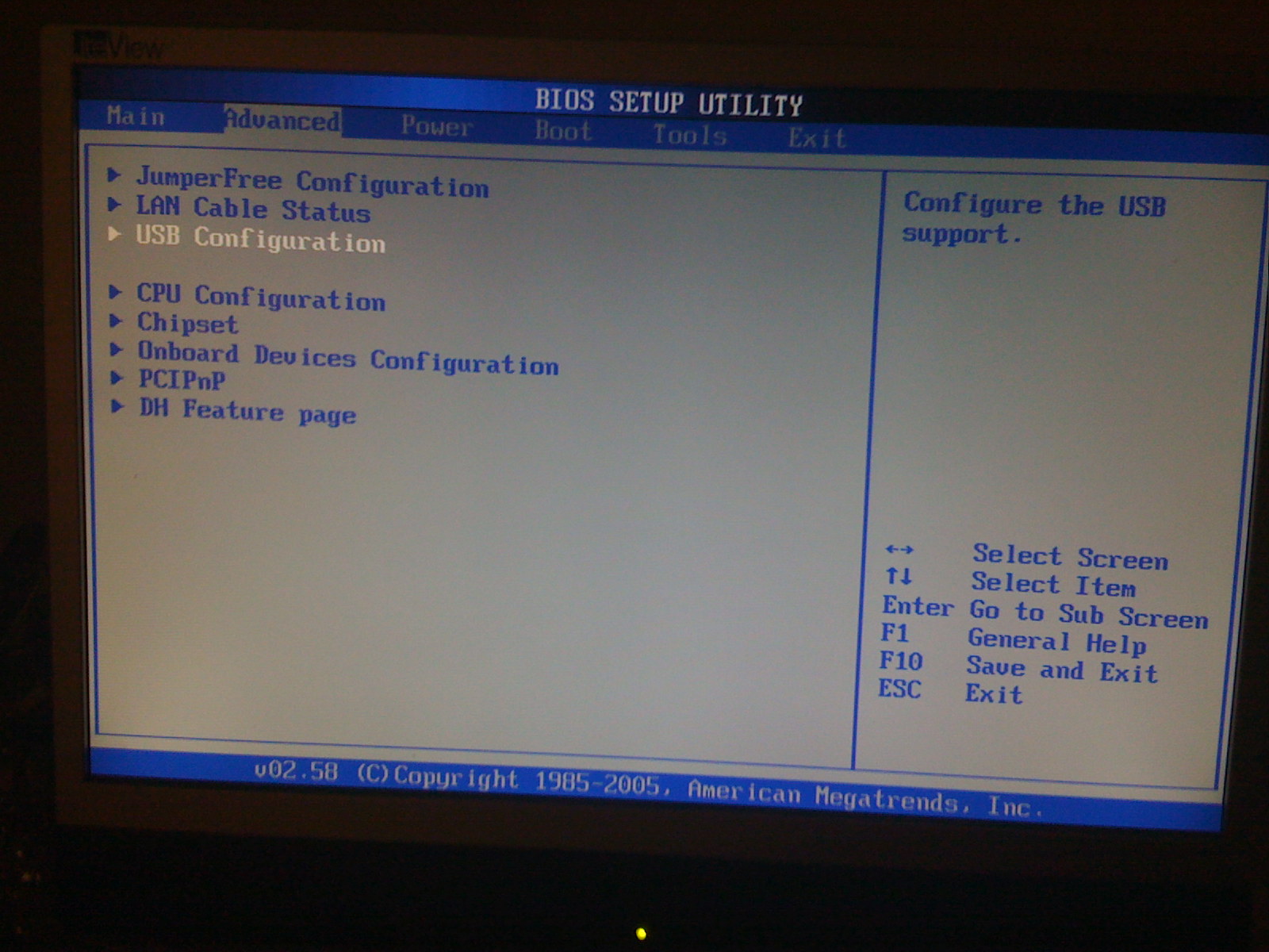

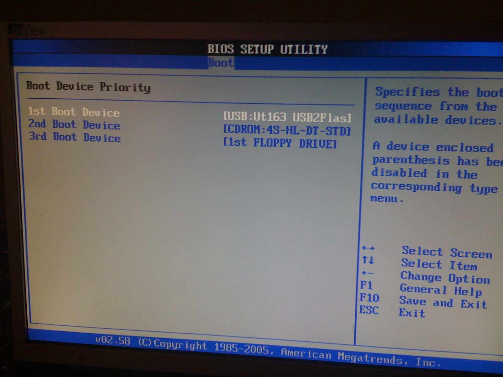

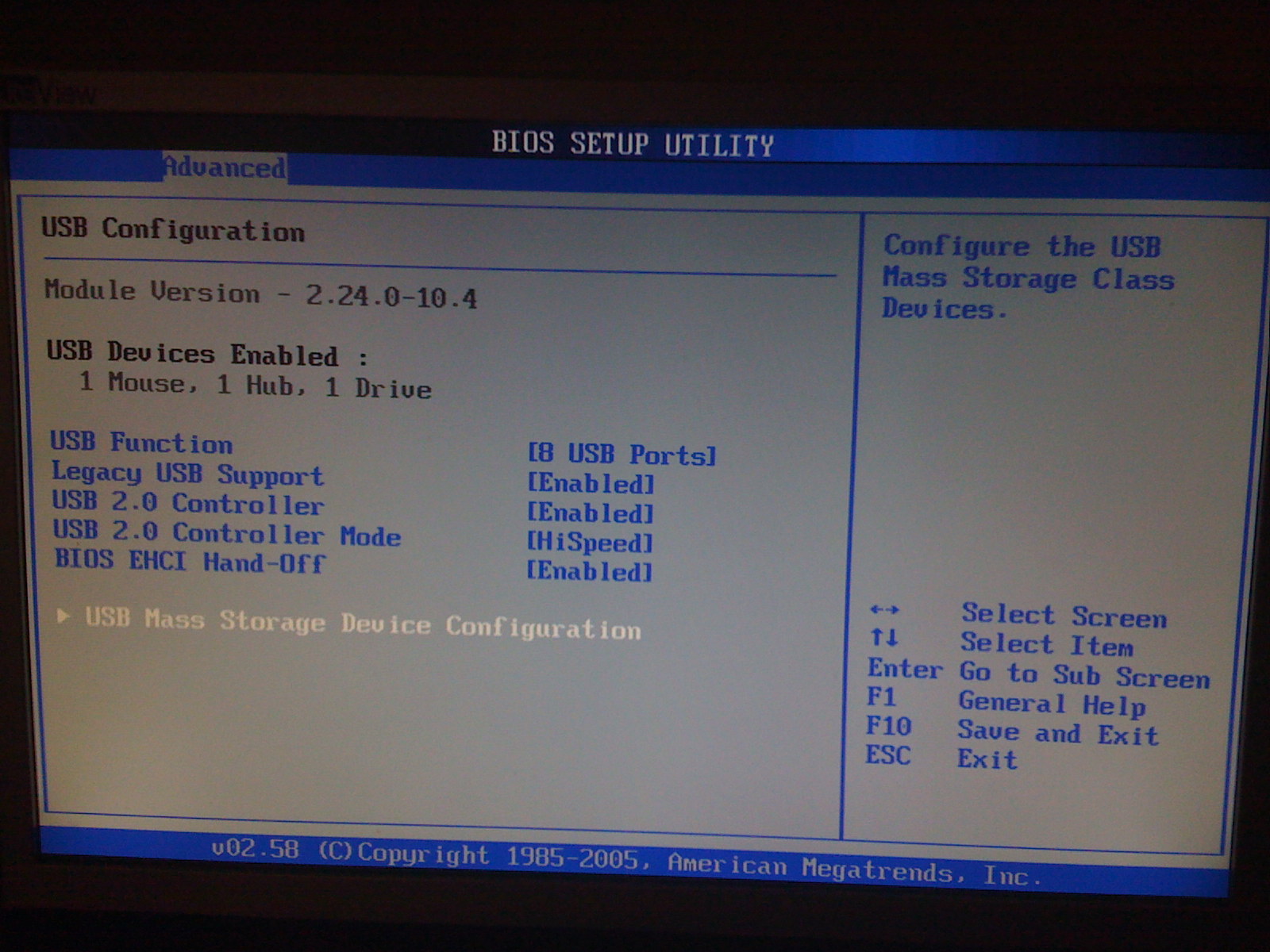

Fresh1 Posted July 29, 2008 Share Posted July 29, 2008 I have same motherboard as you and its working perfectly 10.5.4. You need to change more than the boot order on our motherboard's. What you need to do is go into your bios and select the advance menu, then select usb configuration menu, then usb mass storage device configuration menu, then change the emulation type to Hard Disk. Pics included. let me know how you get on Hmmm dunno that is the first thing that i did. does it matter if everything that is in intrd.iso is packed using the galaxy loader with and mkext instead of all the individual d kext files I am using the file from post 409 in the p5w dh under hardware packed by macita. Thanks Link to comment Share on other sites More sharing options...

Abysmal Posted July 31, 2008 Share Posted July 31, 2008 For all of those having boot errors --> set bios mode to USB = HD/FIXED DISK emulation and to fix the kernel not found errors, rename the files from ISOLINUX.* to SYSLINUX.* It fixed my issues.. Abysmal Link to comment Share on other sites More sharing options...
