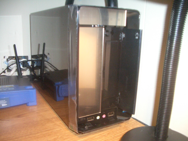

I know this is a bit off topic, but for those of you who have the Apex MI-008 case, can someone take a picture and show me where the spring in the front panel goes. Mine popped out and I have no clue where it goes.
