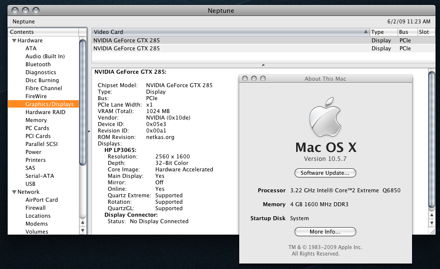

I got a system with 2x GT200 boards now working quite nicely now on OSX (except for the second DVI port on each of the boards).
However, I am having a tough time getting CUDA to work now. I reinstalled both the tookit/kext and the SDK and CUDA still refuses to acknowledge there is any NVIDIA card for it to use. Even though the CUDA kext is loaded.
Anyone having the same issues regarding CUDA?

was the vram amount of both cards recognized properly

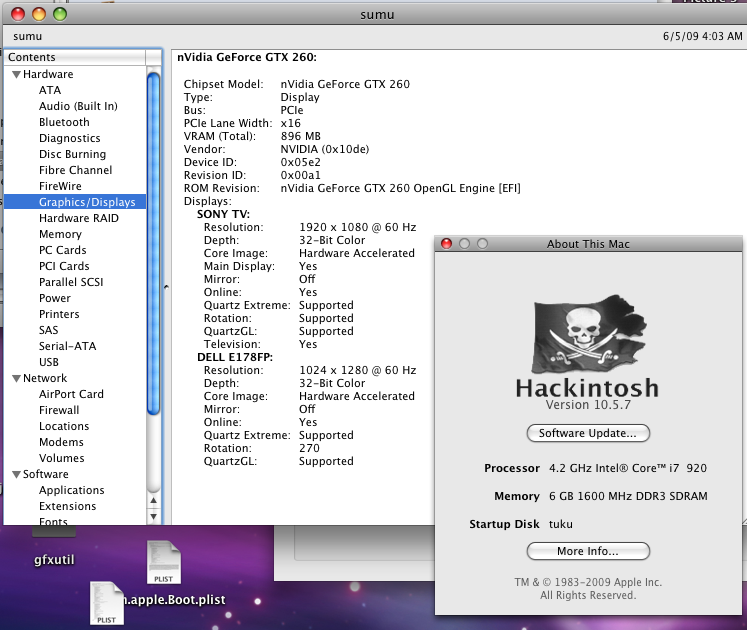

i just have to reply to say thank you netkas and to everyone else for their hard work - am now very happily running my GTX 260 on my Gigabyte EX58-UD5. CI/QE are now hardware accelerated with 896MB VRAM - and it runs sweeeeeet!
as for install - removed NVinject kext and old geforce kext's, installed drivers and injectors, rebooted and rebuilt caches, all as per others have said earlier in this thread.
Everything works fine now with the latest CUDA driver from the irc. Thanks Netkas!
BTW, the GTXs are kinda picky when they initialize the PCI-E (i.e. if having more than 1 which one decides to be the display for the BIOS, etc). So make sure your mobo settings are taking care of that, esp. regarding PCI memory remap, PEG port initialization (those are the main things to check in my ASUS mobo, dunno about other brands).
Cheers, and again... great work!

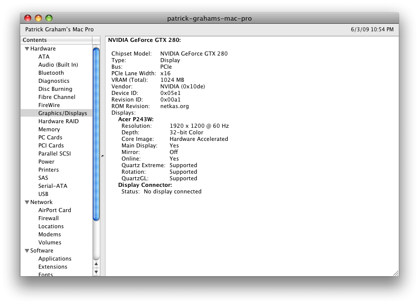

Just got my 280 set up on my iPC 10.5.6 build.
1. Deleted the following kexts.
GeForce.kext
NVDANV40Hal.kext
NVDANV50Hal.kext
NVDAResman.kext
NVinject.kext
2. No reboot, install package, then install enabler.
3. Swap cards, reboot, and viola!
Note: As previously stated, multiple monitors does not work, and will not display anything if both cables are plugged in. Pull out the cable and one display works fine.
Thanks to netkas and everyone on this thread, I've been waiting for this for a long, long time!
